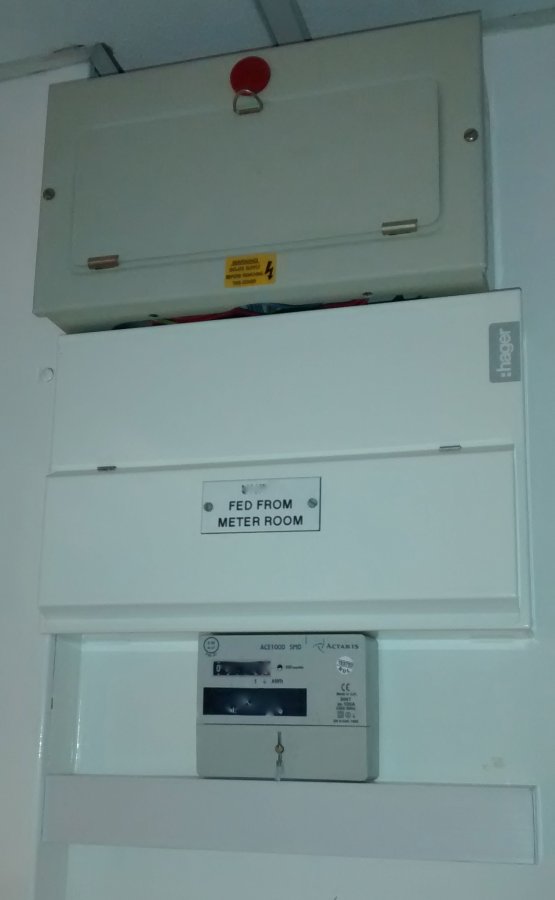

As I understand it, all sockets need to be RCD protected now, but unless there are buried cables, light and storage heaters don't.
So in an (office) installation where the wiring is in metal trunking & conduit, only socket circuits would need RCDs ?

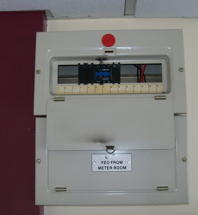

Is there any reason that the RCD for a socket circuit cannot be external to the DB ? In our offices, we have "old" Bill DBs, and a DIN rain box mounted above them with contactor(s) for the night storage heating. I'm thinking that a quick way to upgrade to current standards would be to throw an RCD or two in this box and move the tails.
This is the only photo I have at the moment. Ignore the soot marks - the contactor has been replaced at some time in the past !
I figure the answer changes for those units where the switch drops are buried in plaster with galv capping.

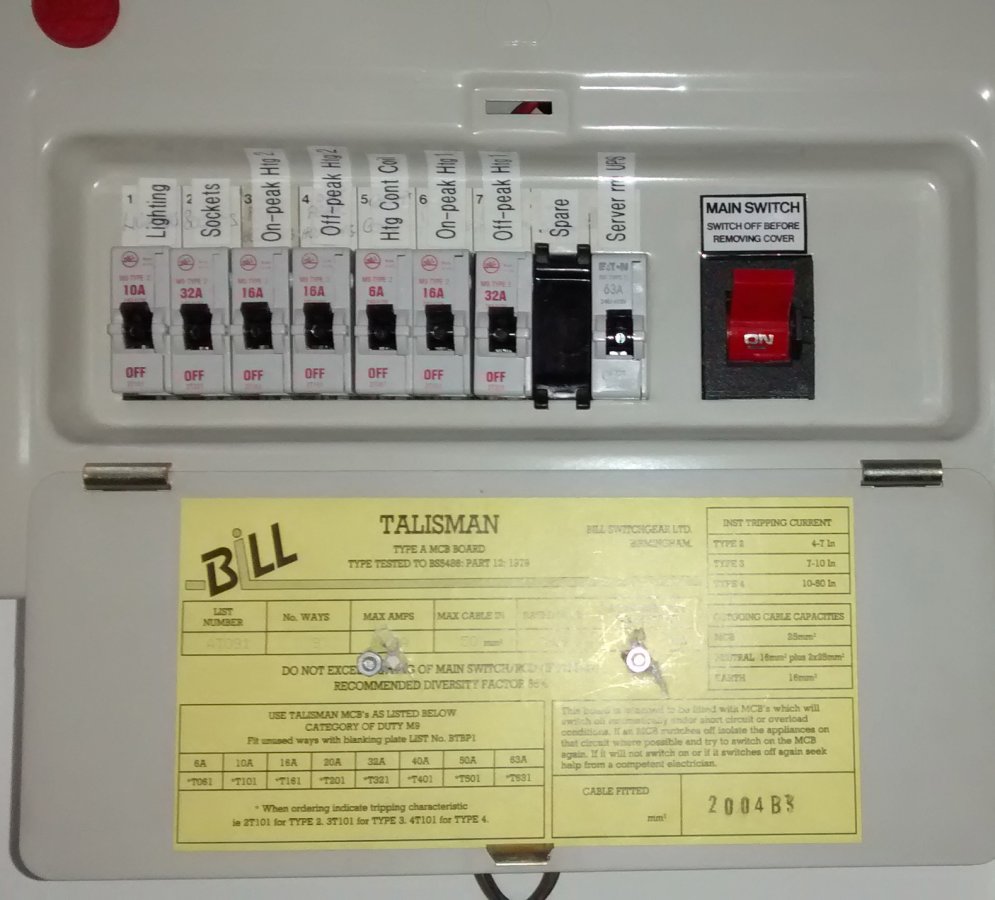

My first concern would be lack of blanks or original MCB's even if not connected to fill the gaping hole. It does not seem to be a locked cover. Yes the RCD can be after the MCB so you could have a panel full or RCD's after the distribution unit but cost of a double pole RCD v RCBO and boxes etc. Likely not a viable option.
It has been noted, but there's no busbar in there, just a din rail for the contactor - and you'd have to be really trying to reach any of it's terminals.

That doesn't look like a suitable contactor to be mounted where the front is open to me, looks ike the terminals could be 'probed' without removing any covers?. The black mark is more likely a dust mark rather than a soot mark. I am not sure on what the exact cause is, but you often see them above contactors, I am guessing its to do with airflow caused by the warmth of the contactor.
Those are Bill tailsman boards, circa early to mid 1990s, they are equivelent to MEMshield 1. And going by what we had to pay for some of those blanks (and corrdosonding red tab for the busbar) recently from a place that specialises in obsolete switchgear , I'd be watchful what happens to the breakers!

them old bill breakers evolved into memsheild One, mem still churn out new ones to order but apparently your looking at about 70 pound each and triple pole are in excess of hundreds of pounds as for rcbos who knows, I have only seen them in 2 module width.
Merlin gerin and most standard blanks will fit them boards instead of the single brown ones
I think you'd have to be trying hard. But if you were determined to do so, then I suppose you could with a piece of thin rod (wire, knitting needle, etc).
As I say, they'd apparently specifically asked to keep the breakers but they "accidentally" left with the sparky.
I know I had to buy a new one a few years ago for a supply for the UPS and it was "a tad pricey" :rolleyes:

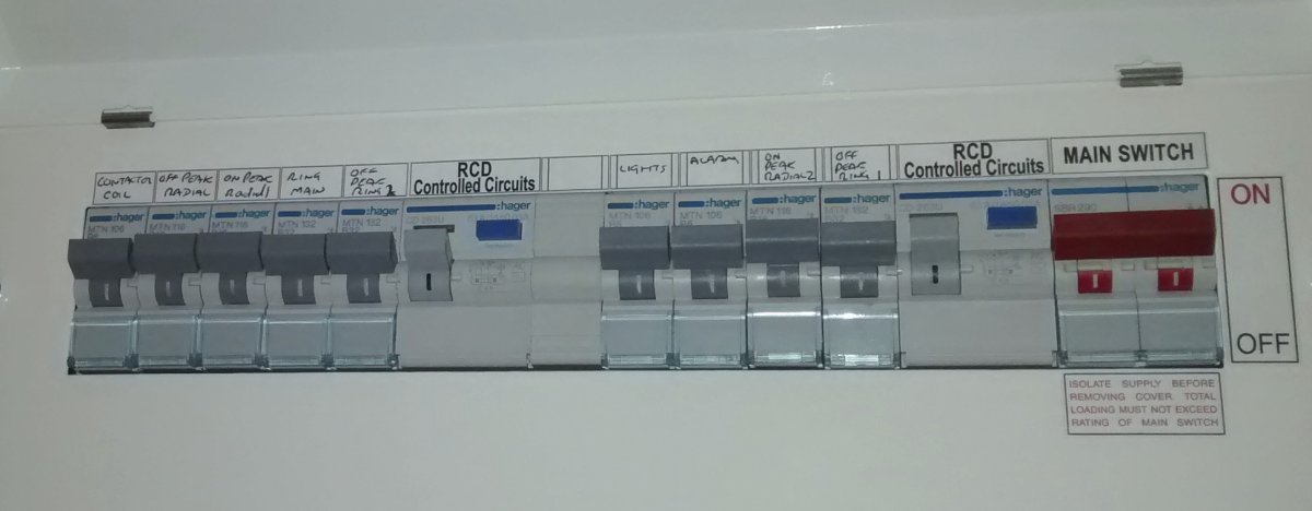

Some more pics.
Our DB with the cover open - yes I've been at it with the labeller
And I popped into one of the other units and got a couple of pics (I see he's used a decent brand of CU :cool:)

"I'm not keen on the server room sharing an RCD with circuits that could make it trip."
Depends very much on the size of the IT installation. If just a single server and a broadband router, then a decent-sized UPS will take care of it. For larger corporate installations it wouldn't be considered acceptable to have the supply on a shared RCD though, from a data integrity POV.
