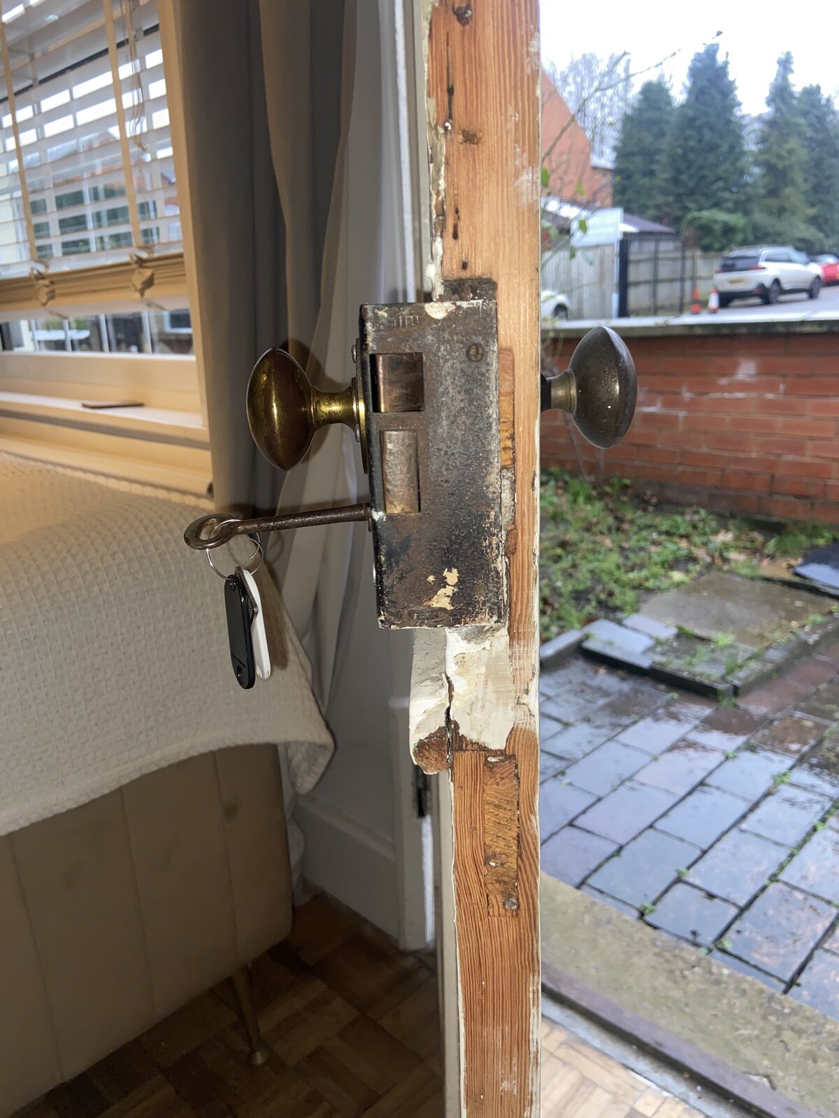

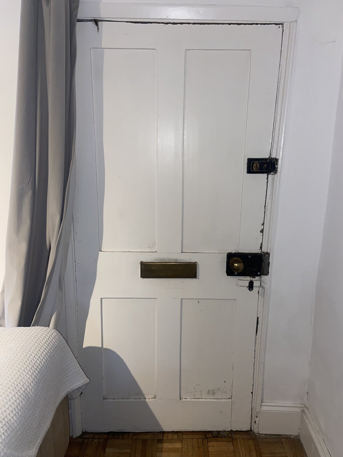

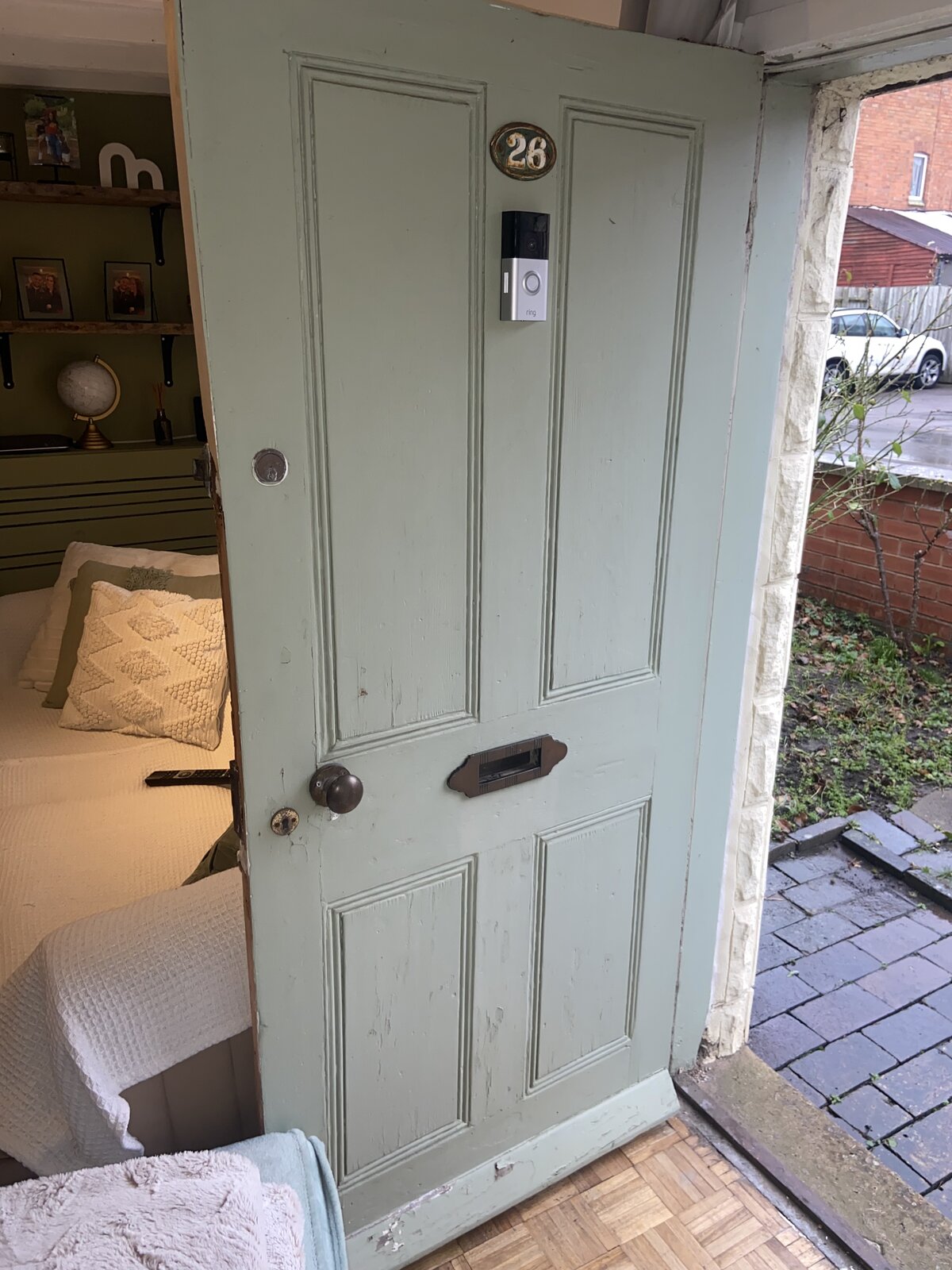

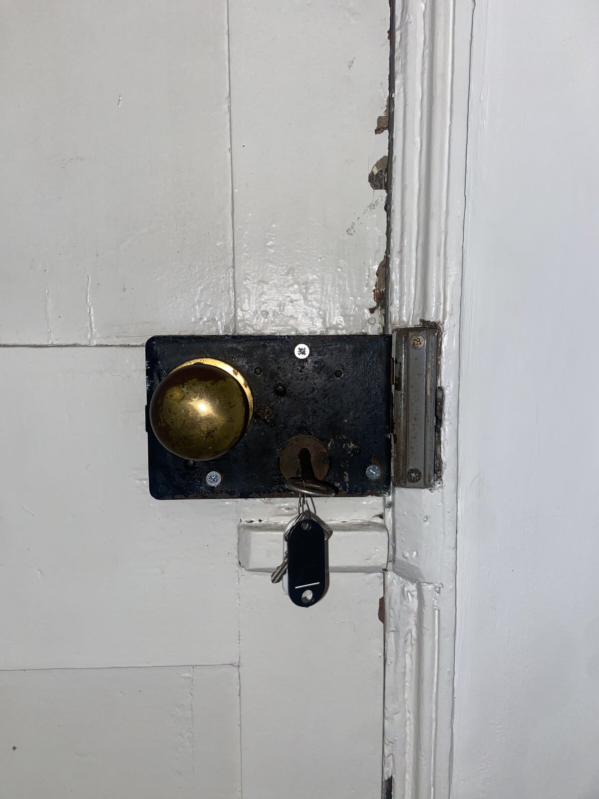

I am looking at restoring a very old front door, not sure exactly of the age but it is rather wrecked including the locks. I’m not sure if it’s even possible to restore it looks like previous owners have done numerous DIY jobs on it already.
I’d like some help regarding the locks as I’m not sure what I need to buy.
Both locks are so worn. I’d like to restore this door and add new locks rather than buy a new door if possible
We have never used this door as a main entrance as we have another door but I would like to start using it.
Any help, advice or recommendations would be much appreciated.
Many thanks

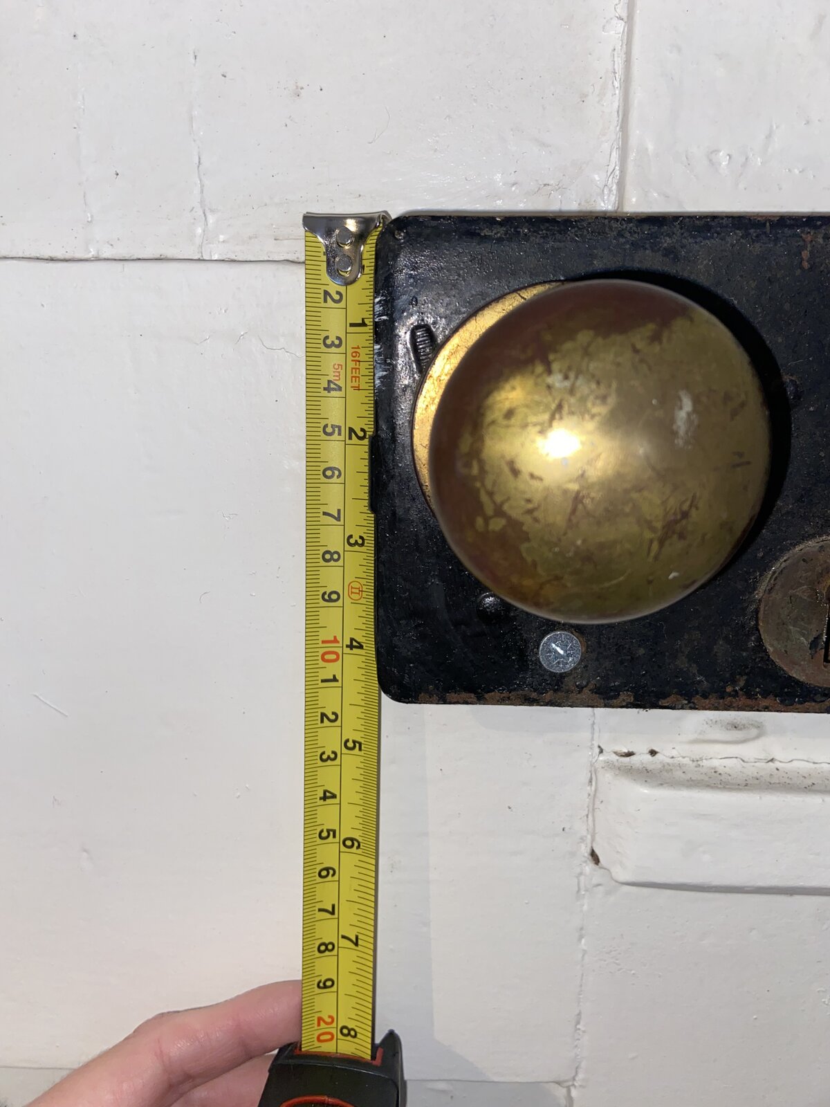

How thick is the door? I would guess it is late Victorian.

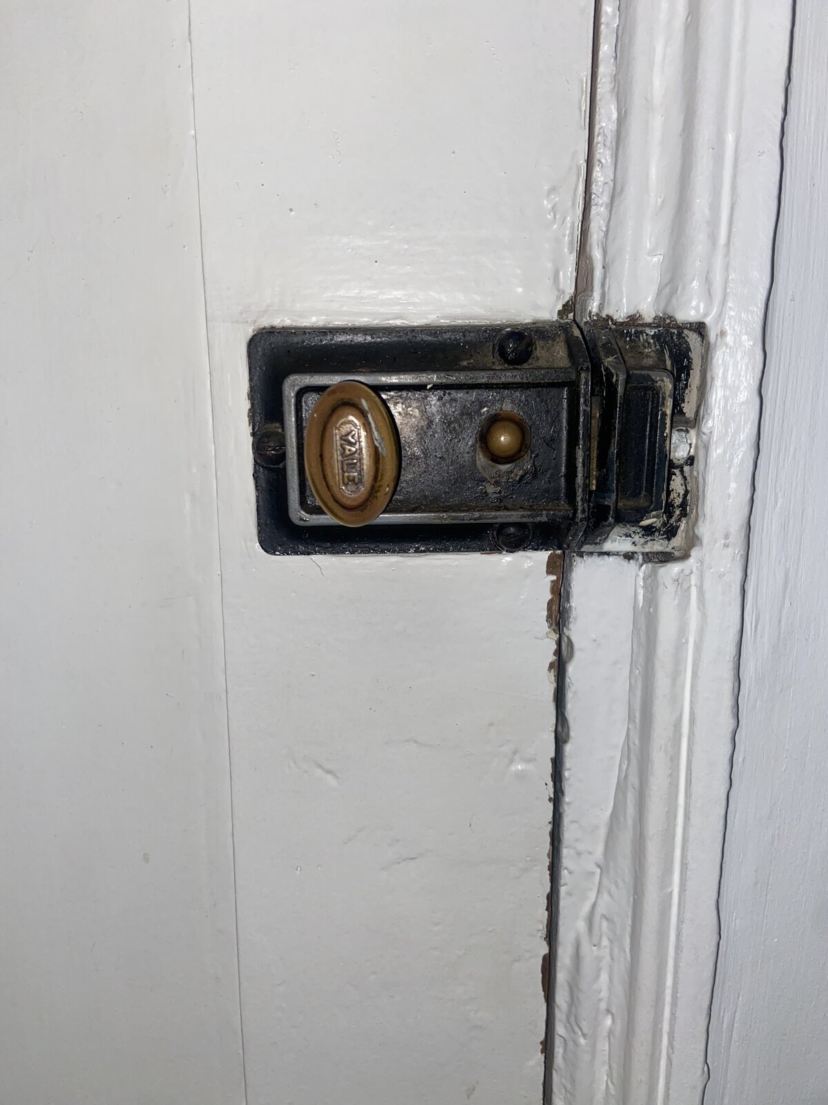

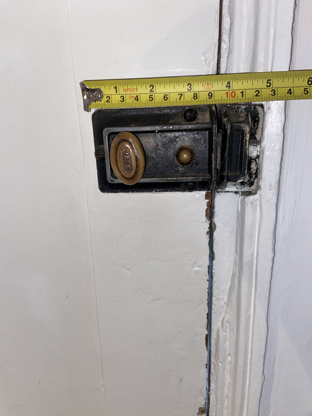

You can easily fit replacement locks.

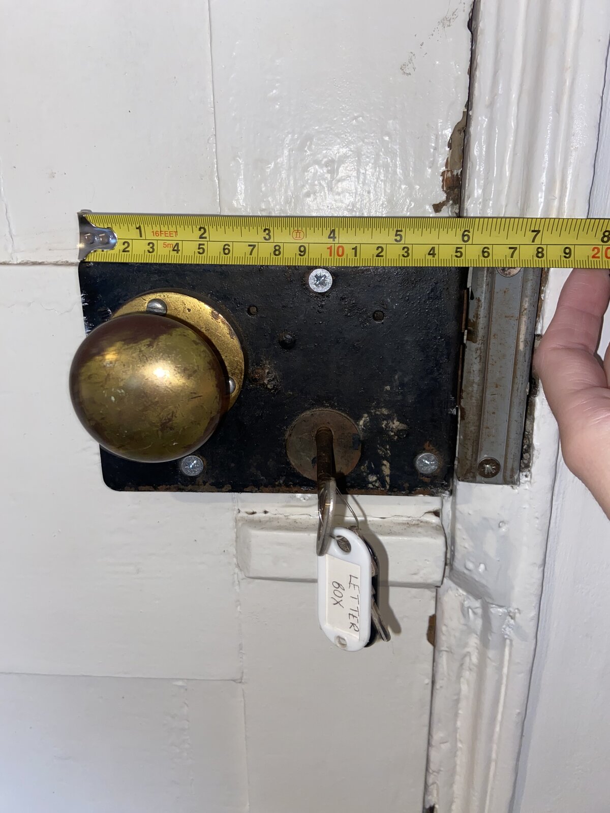

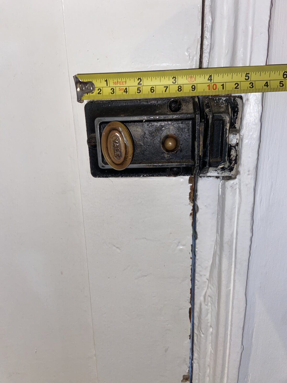

Measure the distance between the centre of the keyhole of your old nightatch and the edge of the door. It is highly likely that a modern BS nightlatch would fit straight in. The staple (the keep on the doorframe) on that type of lock typically falls off if someone shoulders the door, so you may need reinforcement to the frame at that point.

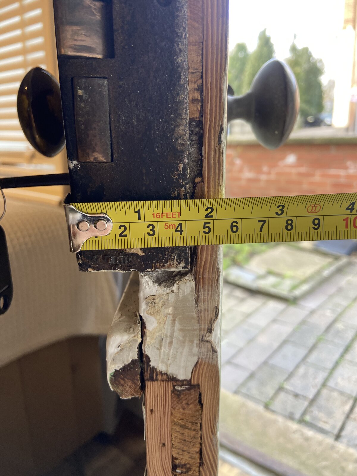

The door may be thick enough to fit a mortice lock where your old sashlock is. But you should not cut the door where the horizontal rail is morticed into the vertical stiles, unless it is abnormally thick, becsuse this will weaken it. You will also need strong hinges.

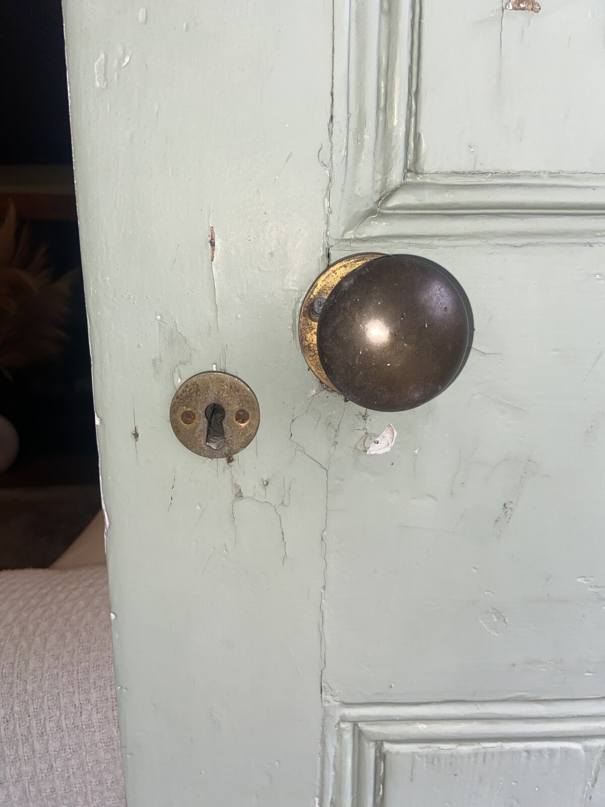

It looks like there may previously have been a mortice lock that has been patched up, your picture is not clear. When you strip the paint off you may find damage to the wood that has been concealed with filler and needs a strong repair.
If it is not your main entry and exit door, you can fit bolts top and bottom.
It’s hard to tell but it looks like the door was originally an internal door repurposed - it just looks a bit thin for an external to me.

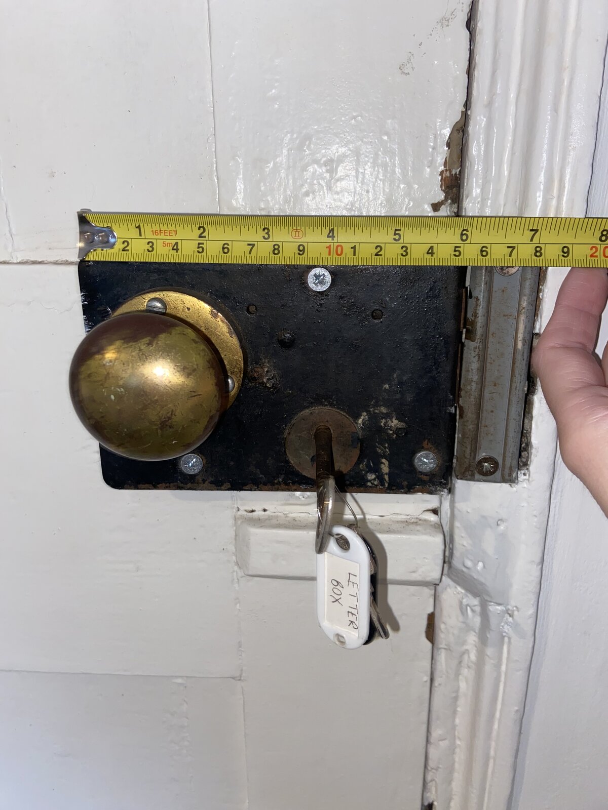

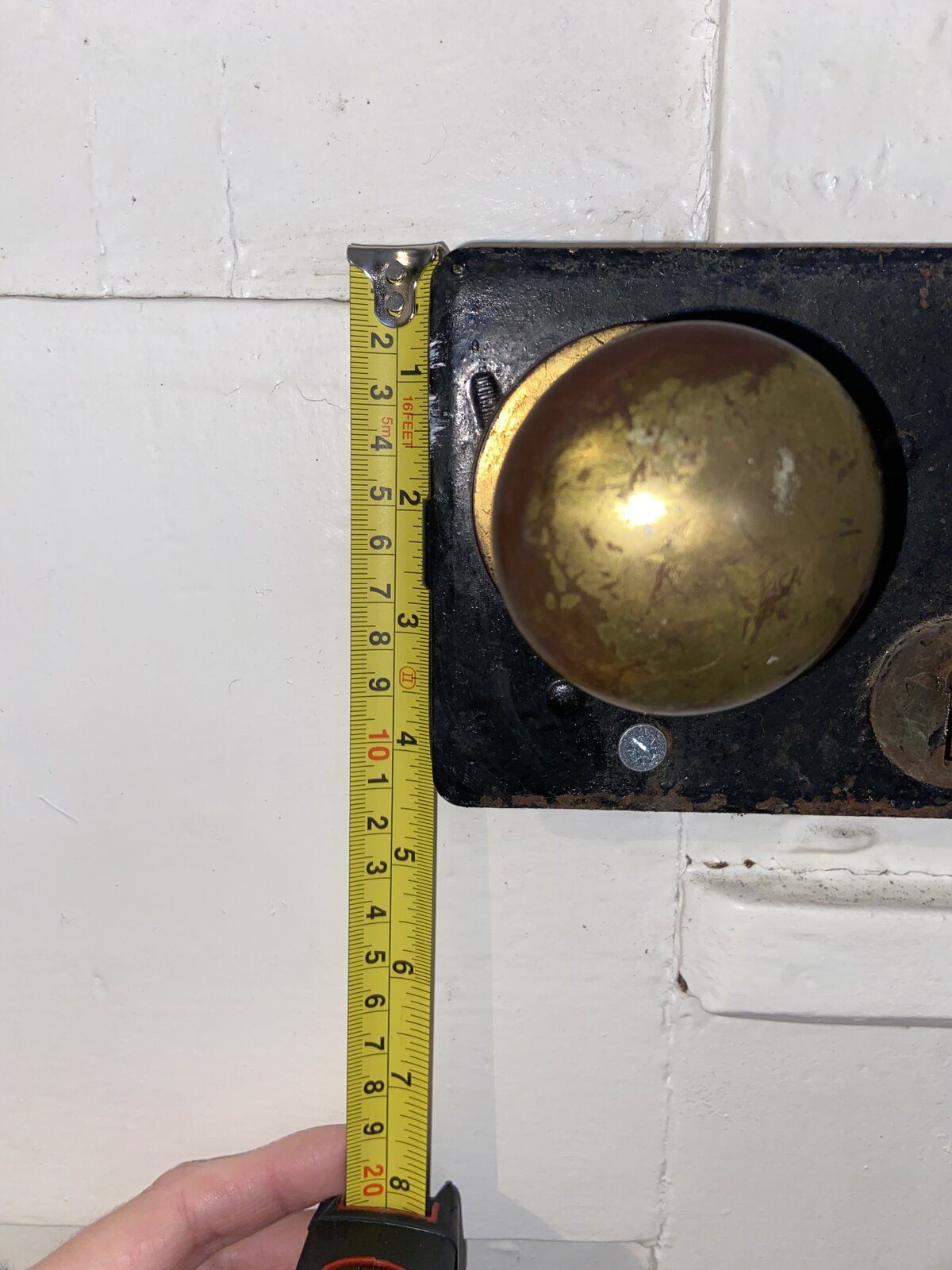

The middle mortice rim lock is visually in the wrong place the knob should be centred on the rail. The lock itself needs a big back set 5” or 6”
@JohnD thank you for this information I am going to get the tape measure out again and inspect the locks that are already on there

you probably want a Union 1448 rim lock 140mm backset
widely available here is an example on ebay
the door needs taking off and shooting down a bit on the sides and trimming the top so it doesnt look like a dog chewed it
It's adequate for a coal-shed, but no more than an ornament on a house door.
The words "maximum security" are incorrect.
You’re undoubtedly correct, but is the door robust enough to take a British Standard mortice lock? The Union lock (that Notch7 suggested) fits the door without removing some of the limited remaining wood.
But regarding the top rimlock, provided it had the same backset, could it be swapped for one that’s British Standard? That would need only a little chiselling but meet insurance requirements.

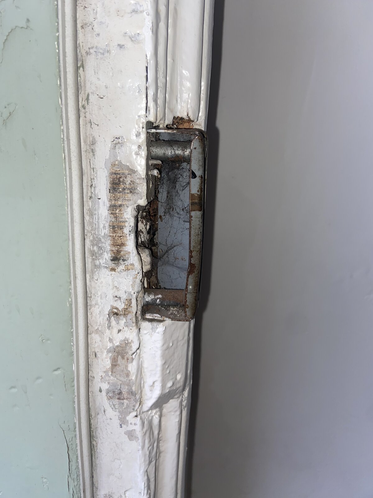

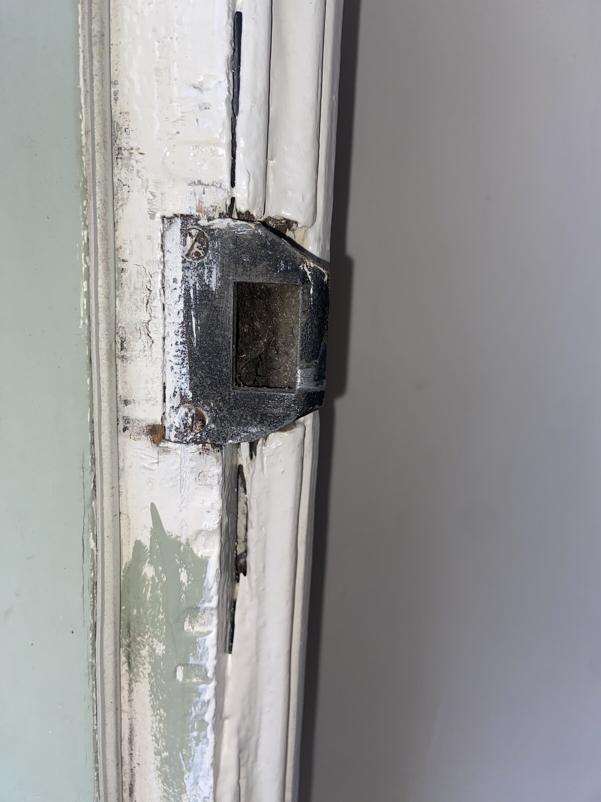

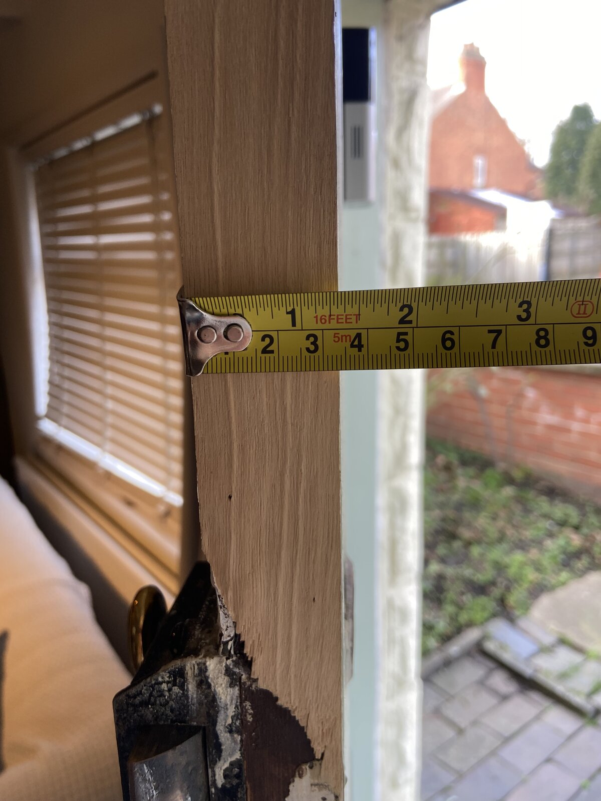

Measure the thickness and photograph the edges. The top edge is perhaps unpainted. So is the bottom edge. These are most likely parts to suffer damp, worm and rot. Round the locks there may be old holes and mortices hidden by paint and filler.

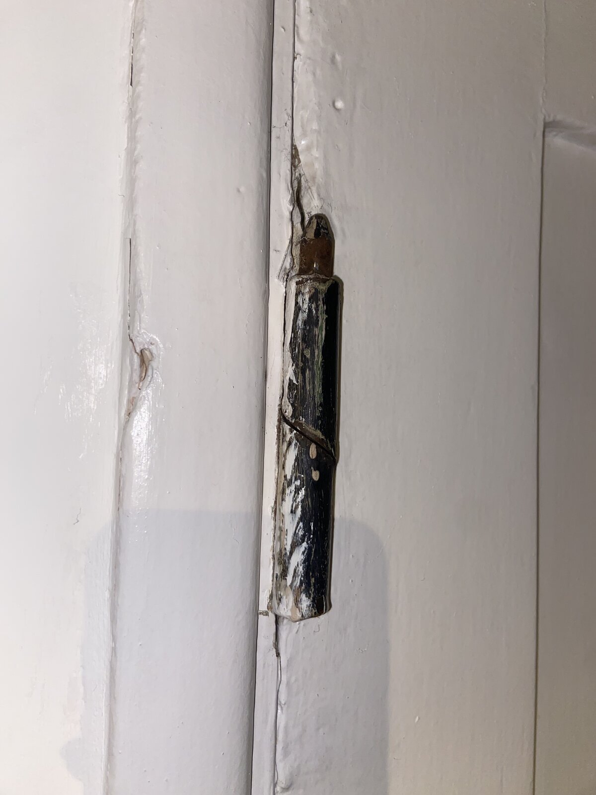

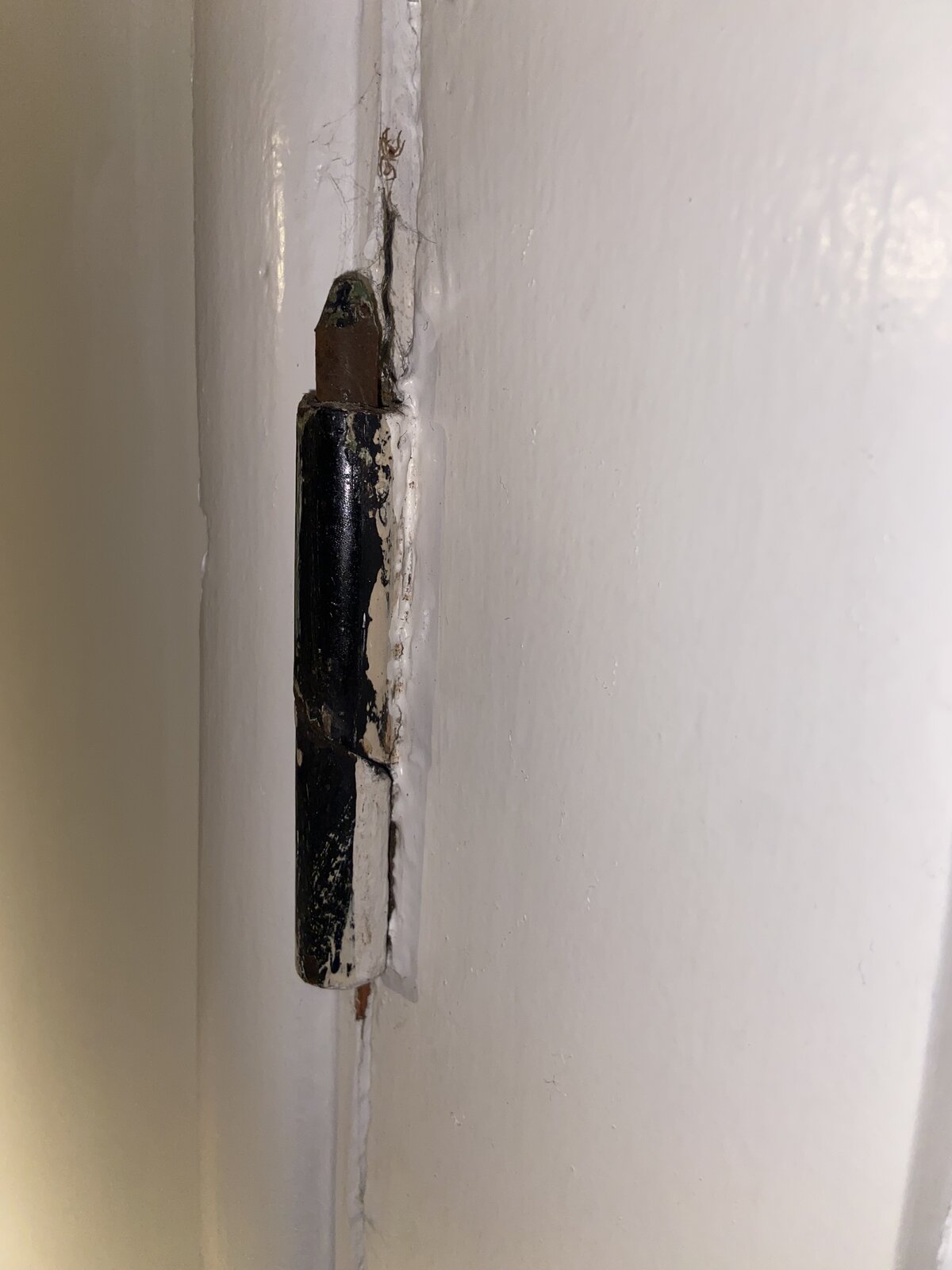

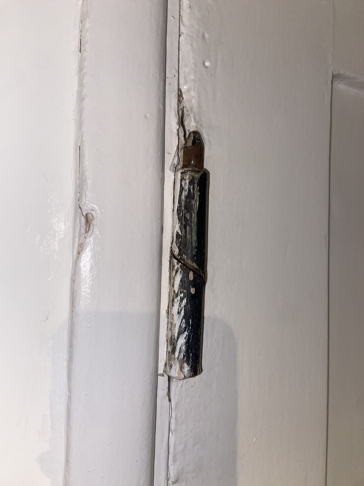

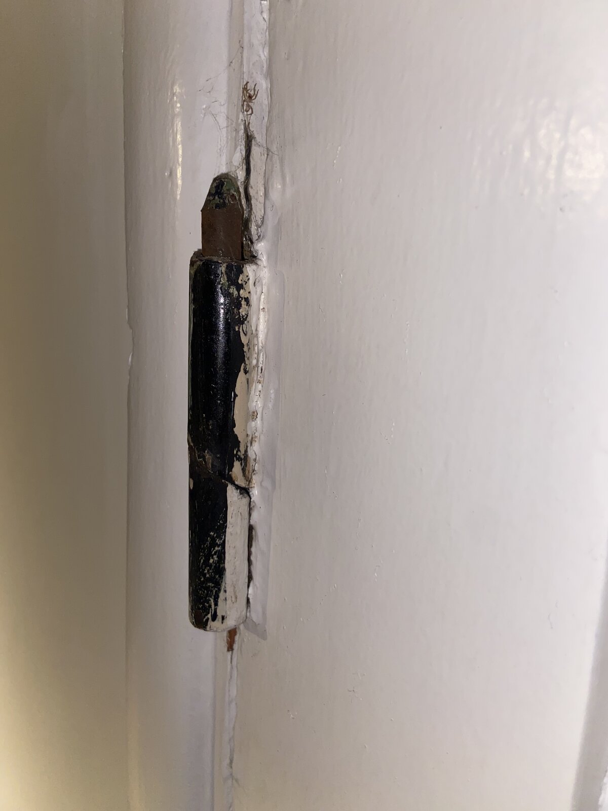

Also photograph the hinges. Yours are probably iron and the screws may be rusted or loose. The hinge pins may be weakened by rust.
If you hinge it on the other side, you can probably use undamaged wood for your locks and hinges.

The door and locks are very battered and previous owners have definitely done bits to both. I’ve taken these extra photos. Maybe a whole new door is needed :(

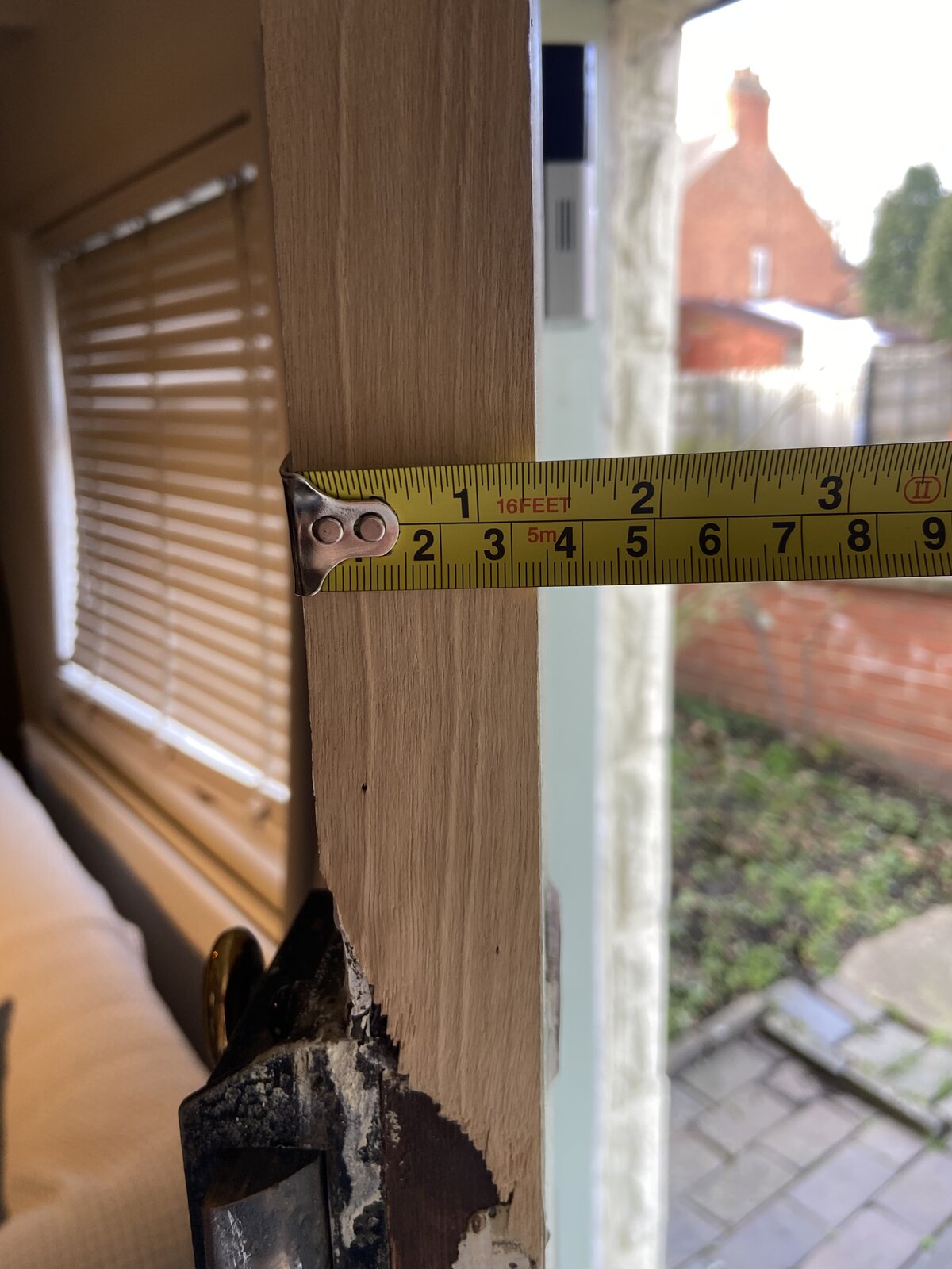

I think your door is 33mm thick. This is an internal door and too thin to mortice.
External doors are 44mm thick, and stronger.
I think it has lift-off rising butt hinges, which are self-closing by gravity
Wow that’s really good information thank you :)
So really I could do with finding an external one then and going back to the drawing board
Internal doors are usually 30 inches wide, and external doors 32. They vary, and Victorian doors in small houses are often smaller. Maybe your house was built with a skimpy door to save money.
In and near Central London, old doorframes are traditionally set into the brickwork with less showing outside.
This is relevant when you look for a replacement.
You are pretty sure to need a new doorframe, but you can easily pick up original front doors, secondhand, from people foolishly replacing them with plastic. They may throw in the locks, keys and letterbox.
I've had them off Freecycle for nothing, but once paid £5. You need a van or a roof rack, or a large hatchback, and at least one helper.
A carpenter can easily cut a frame and door to fit, but may grumble about it.
A DIYer with woodwork GCSE can do it, but worse, and much more slowly.
