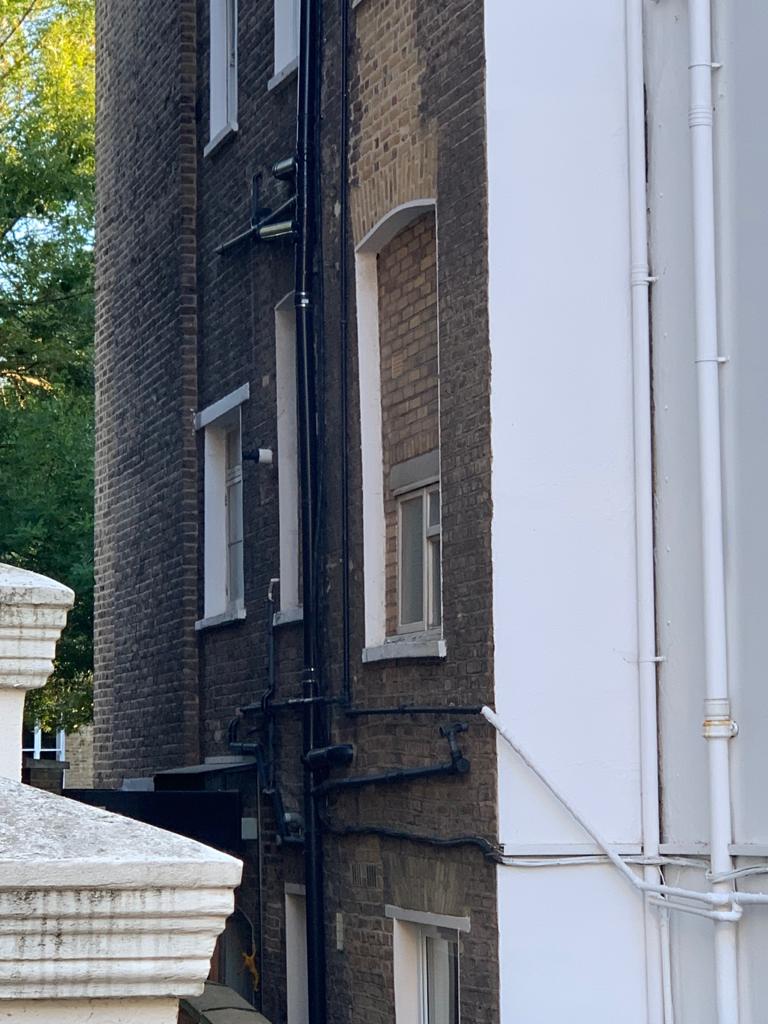

At the side of our house we have a large window frame which has been bricked up and a smaller window has been put in to replace it. I wanted to remove the bricks and put in place the original windows.
My only constraint is my lease which says I cannot do anything which is structural. From the picture would you have any thoughts on whether the bricks inside the frame are structural.
Thanks!

Hey Nakajo. Yes it is, I have got planning permission from the council though.
It is quite possible that the window originally had a timber lintel. It is also quite possible this was removed when the window was bricked up. Only opening up and investigating will give the answer. If by luck there is still a solid and serviceable lintel above the bricked up area, then the bricks are not structural.
Arguably reinstating an old lintel that should be there is a "repair" and not new structural work, but only you can decide how close to that wind you would want to go.
In context of a lease, the external walls are structural
Of course, but the house was designed and built with a window opening, therefore reinstating an original window opening that is fundamentally still there, just blocked up, is arguably not structural. The question is how likely is it that the lease holder will have an issue with the work.
Don't confuse structural work in the physical sense with work on the structure in context of lease terms.
The landlord is responsible for the structure, so would not want leaseholders messing with it willy nilly.
