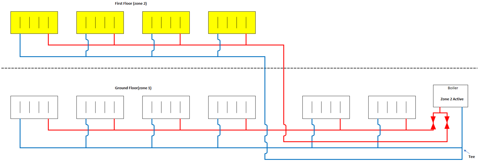

I created an central heating installation with 2 zones as shown in the diagram below.
Zone 1 is for the ground floor while zone 2 is for the first floor. The return pipe from zone 2 merges with the one from zone 1 through a tee when reaching the ground floor.
The issue I have is when I activate zone 2 only, some of the radiators from zone 1 heat up too as shown in the diagram below (highlighted in yellow):

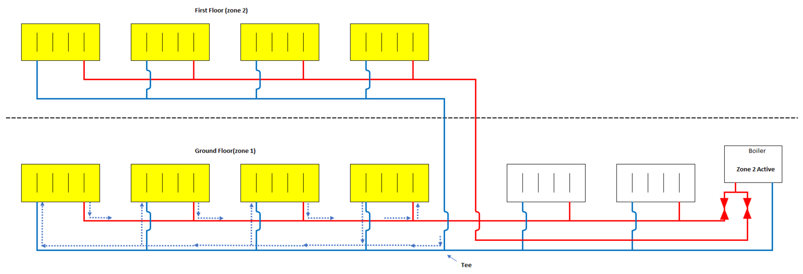

I believe this is happening due to reverse circulation on the return pipe after the tee, as shown with the blue dotted arrows.
I believe I have 2 options to address the issue.
Option 1: installing a check valve at the location shown in the next diagram
Option 2: running the return pipe for zone 2 all the way back to the boiler as shown below
Which option would you use?
Option 1 is obviously the cheapest and quickest, but is there any advantage / inconvenient using either option?
Thanks!
Thanks guys, since it is not a long run I will extend the return pipe for zone 2 all the way back to the boiler, I did not think about the possibility of the non-return valve getting jammed.

How hot are the rads that are not meant to be on? Is the pipe next to the off zone valve getting hot?
Very odd as it works fine one mine - Although I have the zone valves on the returns...
Each zone must be piped from the common flow and return to prevent reverse circulation.

Well I came through many diagrams showing this kind of set-up and obviously I wrongly thought it was acceptable. Note that this is my own installation in my own house, not being a plumber I just wanted reassurance that the diagnosis I made in my original post was correct, thanks for confirming this.
Why is there no "reverse circulation" in the first two rads?
Are you sure you don't have a bypass valve or something you don't know about messing things up and connecting loops.
As I commented before my setup is very similar. I only have the rads heating up that the zone valve is open on...
If you isolate the rads one at a time - does this solve the problem when one is isolated? I'm wondering if one joins to the other loop somehow?

I'm not a plumber either, but I still think that's wrong. There is only a problem if the water has 2 parallel paths to return to the boiler.
The OP's diagram with the flow arrows doesn't tell the whole story. IMO when Zone 2 only is on, the water flows the "wrong" way through the 4 Zone 1 rads to the left of the tee, then through the other 2 the right way, then back to the boiler.
Problem all fixed after using option 2 in my original post, never expected reverse circulation but learned a new thing.
