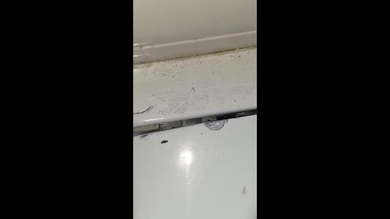

I should have said, when I try the handle trick (thin piece of something inserted in the gap) the handle doesn't budge, however as I say, if I press the button on the handle I can see the part moving across that then engages with and pushes the metal part in the handle body. So although I'm not saying the handle is definitely ok, it appears to be ok. Which has got me thinking could it be the mechanism in the window?
Could be either tbh. Handles are notorious for going wrong on the push button, it breaks up inside and jams it but as you say it could the lock.

Hmm trouble is if the handle won't move then one of the screws will be concealed, it's a tricky one without being there in person to determine whether the handle is stuck or the mechanism. Usually the handle fails and you can use brute force to open it as the mechanism is free to move, however if the mechanism has failed and it's generally the teeth on the cog or pinion gear that have failed so forcing the handle that already opened just means your forcing the mechanism that jammed up, either way it has to be opened in order to be repaired

Here's a vid of me pressing the button on the handle. You can see the (lug?) of the button moving across and depressing the metal piece that's in the body of the handle. So that part appears to be working ok? However the handle ain't budging even with quite a lot of force exerted on it.
Does look more like the lock if there is no movement from the handle
