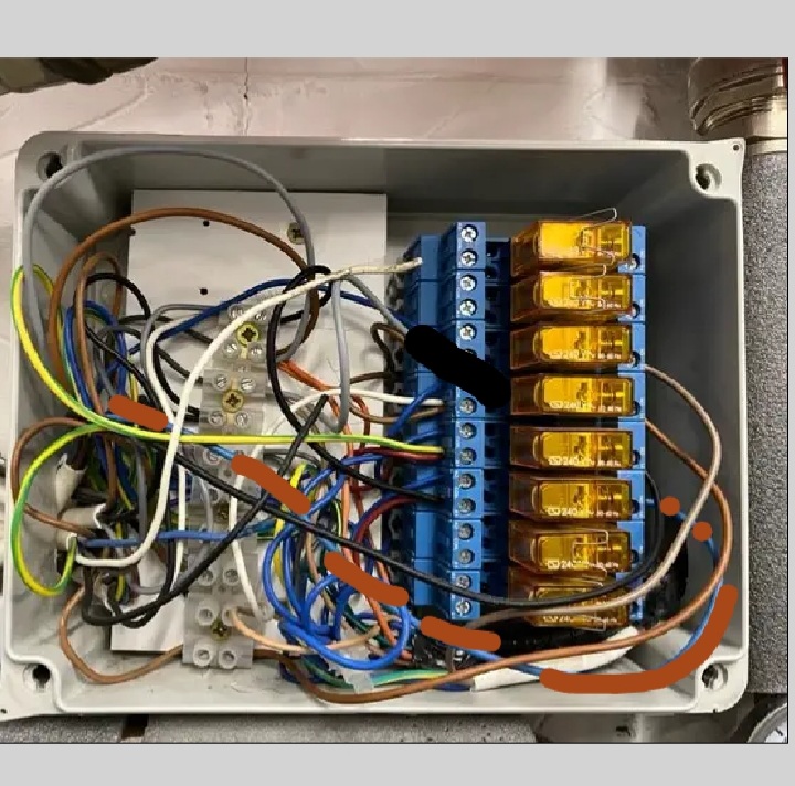

Hi there thanks for your time to look at this.
I've got a multi pump / circuit system which is connected via a relay box to the boiler and Honeywell timer programmers. Picture attached.
Right now any single circuit can turn the boiler on an off at any time (assuming the programmers allow it). There are central heating (two zones), towel rails (one zone), underfloor heating (two manifolds) and hot water cylinders (2 of them).
I'm trying to rewire the system to make it hot water priority. So basically if the hot water circuit calls for heat, then the other circuits should go off temporarily to allow it to reach temperature as quickly as possible. This should allow me to range rate the boiler down (40kw current) and ensure it doesn't burn crazy amounts of gas trying to satisfy all open circuits at once.
I cannot see any diagrams online for these kinds of relays - I cannot even see the name of the product (generic plastic box). Can anyone help?
Thanks!!
That looks very much like a real DIY design and build.
Without an accurate wiring diagram it will be impossible to determine how to alter the wiring to provide hot water priority.
I assume this was in place when you moved into the house, Did the previous owner have any design notes for the system that may include a circuit diagram ?
Failing that a competent person is needed to create a wiring diagram by tracing and documenting each and every wire and each and every relay. connection
I take it you know if the boiler is capable of being range rated? Orange wires are generally the switch live wires from motorised valves if that helps?

It was the plumber who I hired to install this originally... yes this is exactly why I haven't called him back. I'm just trying to understand the principle of how this works as I have a friend who is an electrician but just is not familiar with this relay box. Cannot work out how they operate as I don't know what brand they are !:unsure:
Thanks, yes actually I have already range rated the boiler down - and generally when all the circuits are not on it works fine at half the output (20kw as opposed to 40kw) - in fact if the radiators and underfloor are on the flow temperature falls slightly because the boiler is working flat out which suits just fine actually for these two circuits. Thanks

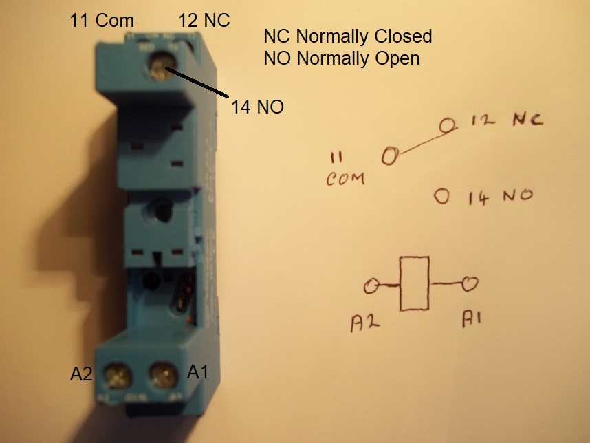

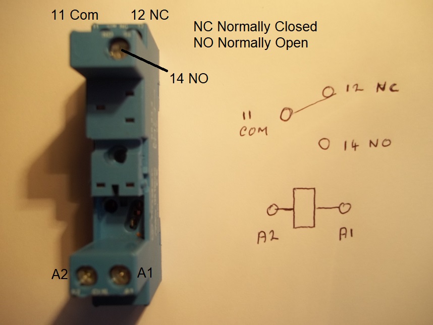

The relays and their sockets are manufactured by Finder
It is strange that in your picture there are no visible connections to the COM and/or NC contacts on the relay sockets. Only the NO contacts seem to be wired. Are there wires to the COM contacts that are not visible in the pictures, likely to be a daisy chain of short links or a bus bar

A bit of guess work, and I don't know the relays, but they appear to me to be SPST relays with a 240V AC coil and an internal link to provide live to the output.
The left hand terminals power the coil - the top terminal neutral, the bottom terminal the live to operate the coil.
The right hand terminals are the switched live outputs.
If you want to start tracing the wires, you could take the spare relays out to give yourself a bit more space.

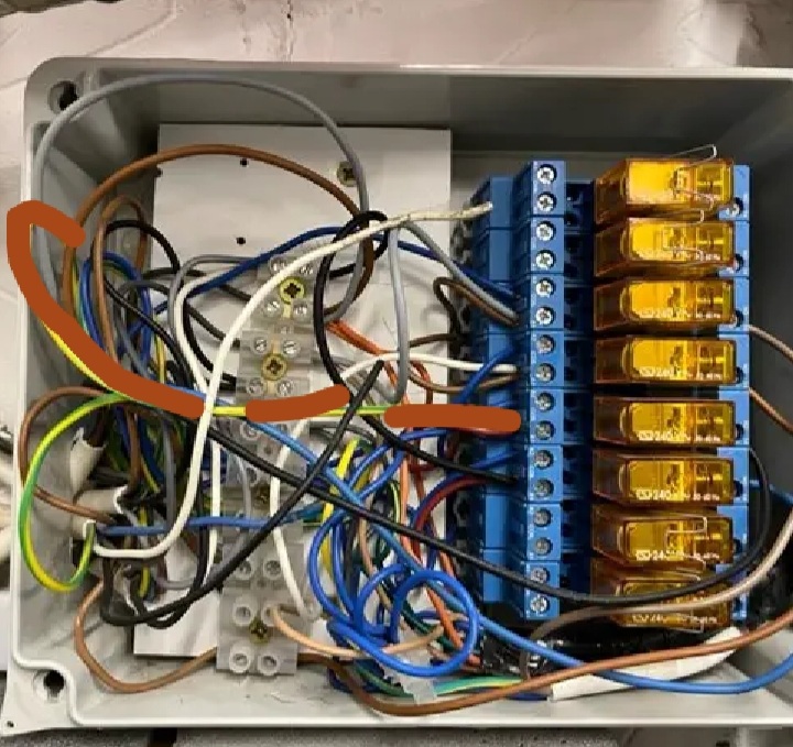

Most of the blue wires appear to be neutral, so that simplifies things a bit, apart from this one...
Which seems to be a switched live.
This yellow/green wire also appears to be a live...
Both wires should have some brown sleeving on them to avoid confusion.
Again, these are only a guesses - a multimeter would be very useful for this problem!
