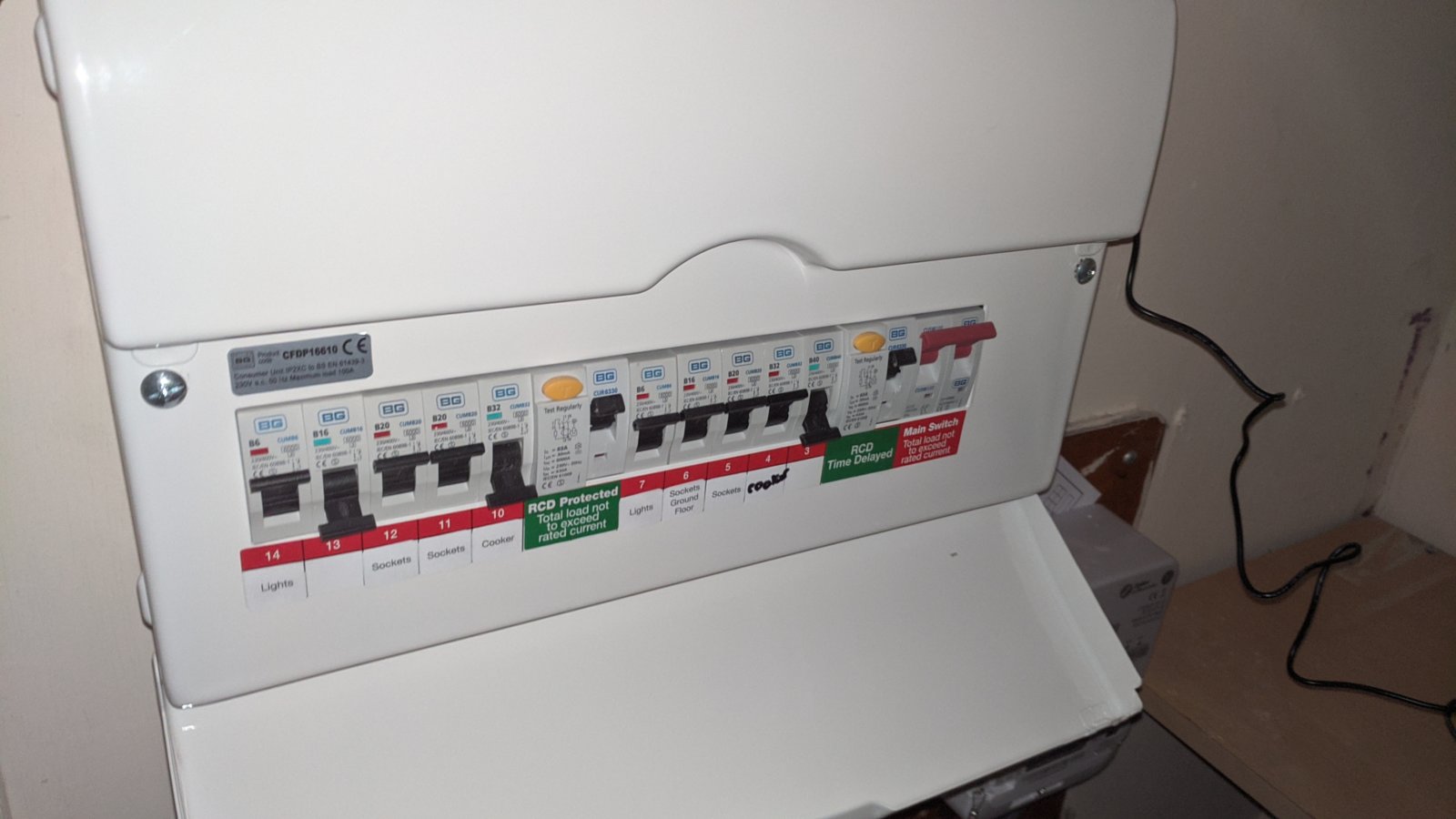

Hi,
We've just has our recently purchased house rewired due to issues regarding previous owners' bodge work and undisclosed mice infestation.

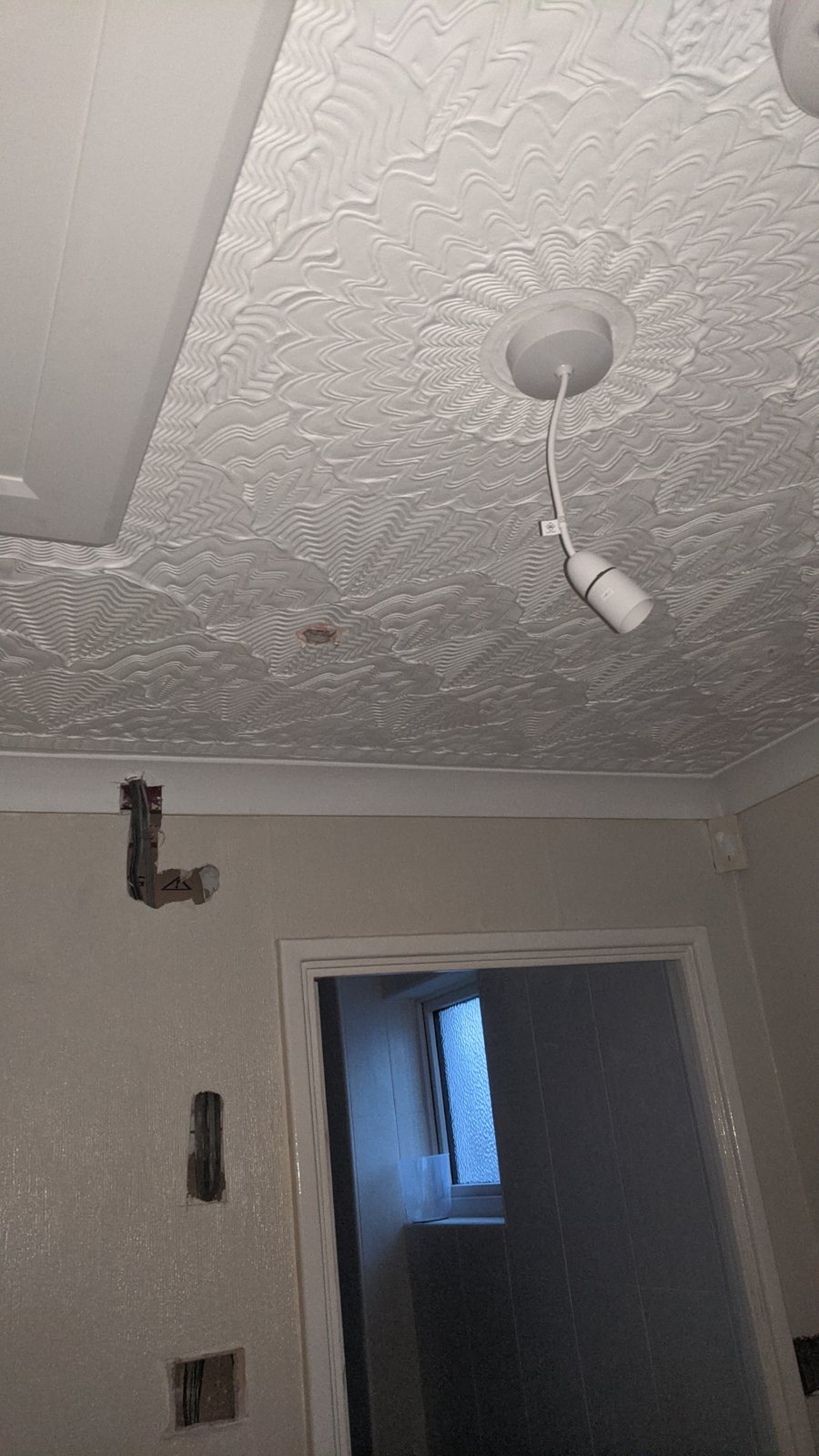

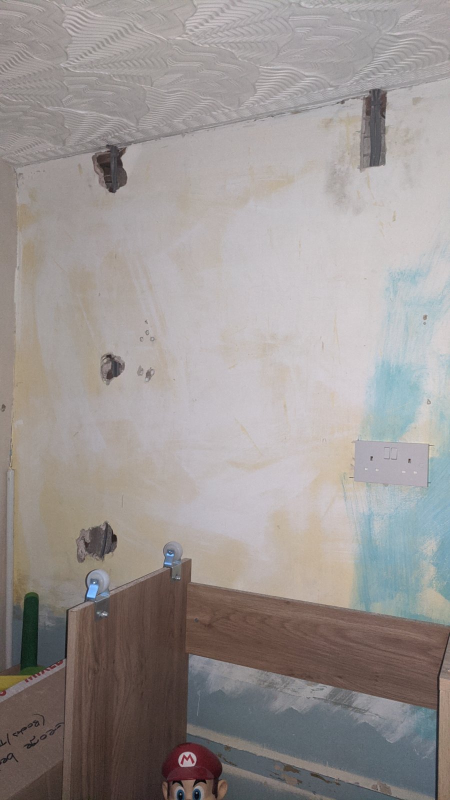

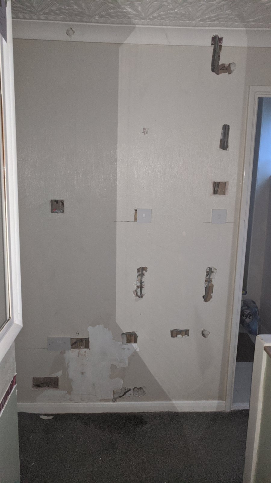

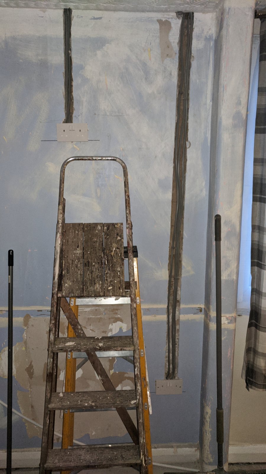

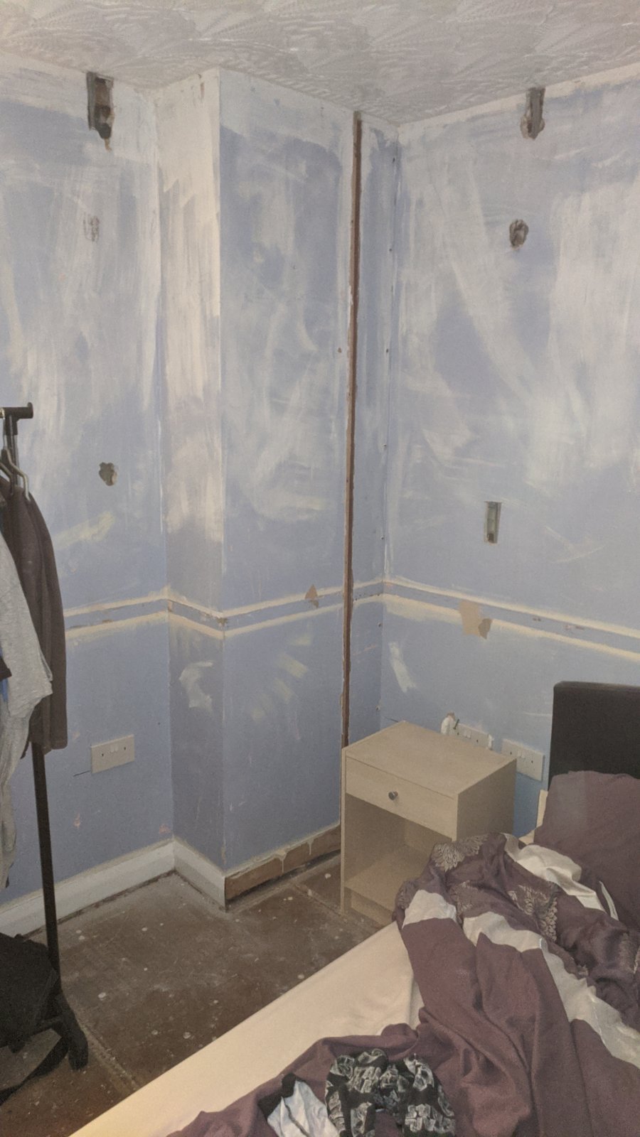

On a rewire, is it normal to have the electrician to cut 4" square chunks out of the plasterboard to put the wires in?

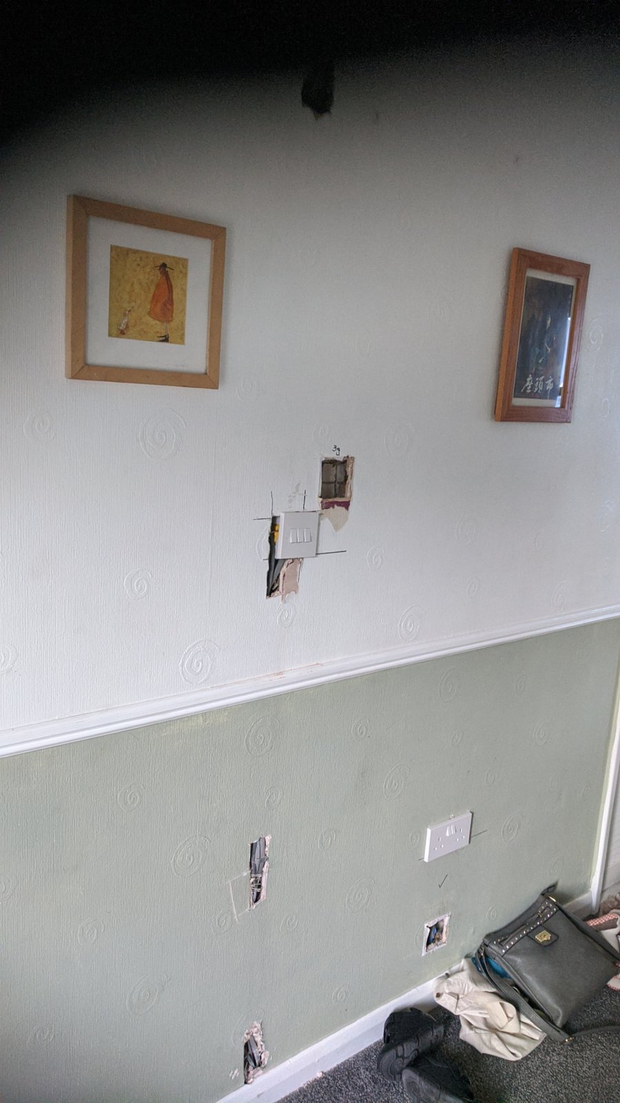

The old sockets were about 4" above the skirting but he's put all the new sockets 450mm from the floor, leaving just holes where the old sockets were.
The light switches have all be dropped to 1200mm from the floor, leaving the holes of the old switches.
When I asked about them, he said it was new regulations that required them to be that high. Is that correct?

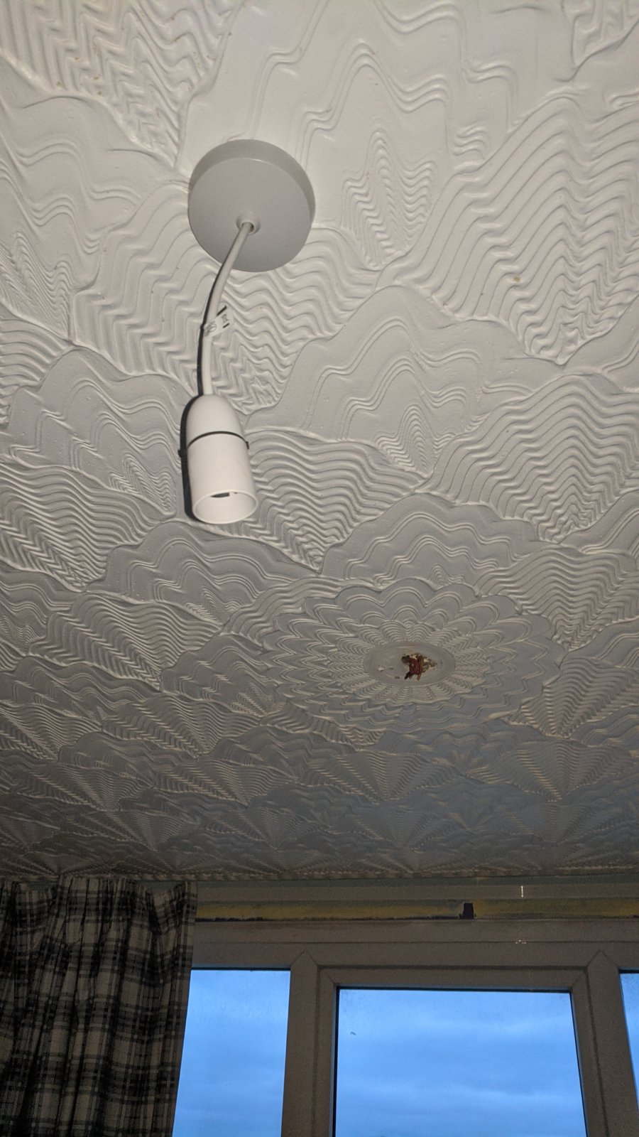

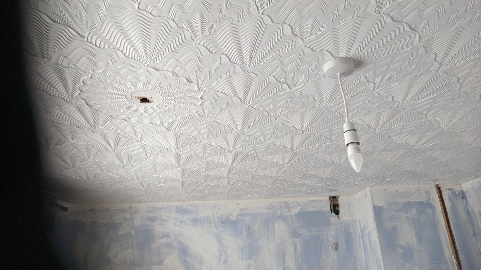

The ceilings were artexed with a round pattern for the light fitting but he's discarded those and drilled though the ceiling in the centre of the room to put a new light fitting, leaving the hole and pattern where the old one used to be. The old fittings weren't centre but they worked with the layout of the rooms. When I asked why he'd done it, he said it was regulations that required it to be centre of the room.

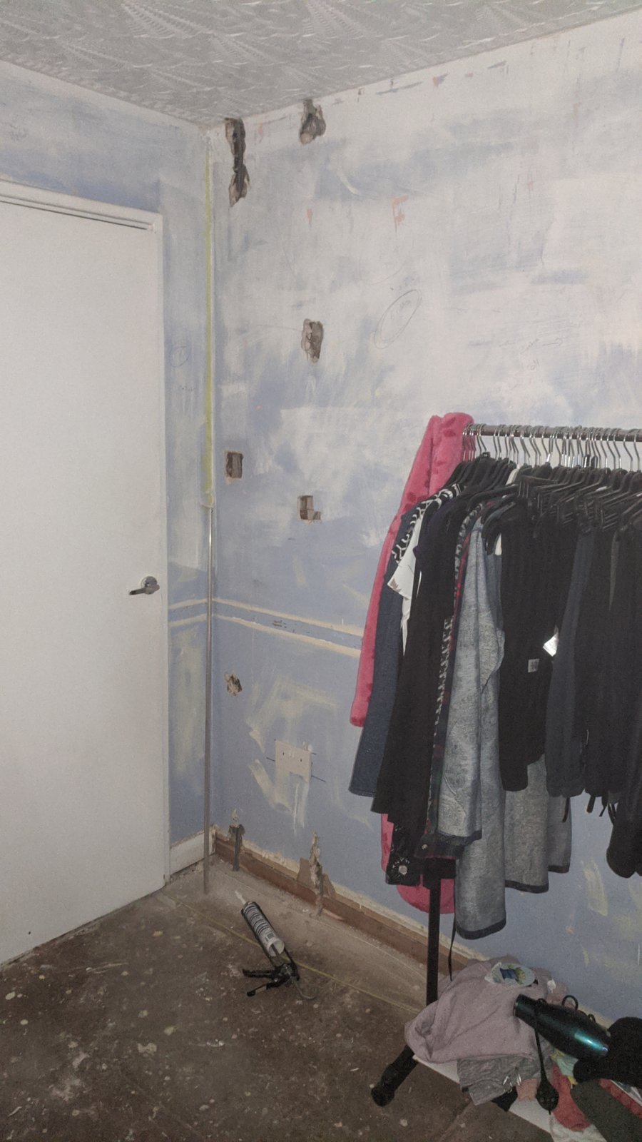

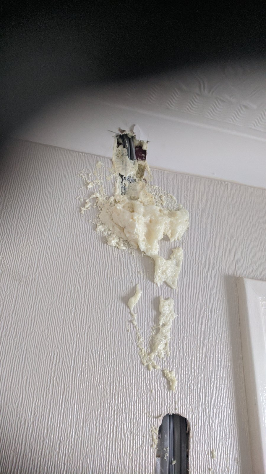

He's also cut chunks out of the Coving and drilled 1" holes in the ceiling too for some reason, even though he had access to under the floorboards and in the loft.
I'm just querying if the socket/switch heights and ceiling rose location regulations he's stated are correct.

He's a to$$er. The new regulations only apply to new build. Sorry, no real comfort to you.
And I have never heard of a 'centre of the room' rule.
Hi,
Its often necessary to cut an access to drill noggins, bits that came out should have been saved, and can be fixed back in by whoever is making good using a bit of timber
New builds are required to have them at those heights, no need to so so on a rewire, although if doing a full refurbishment, some might choose to. Those heights are considered standard spec, however on a re-wire its something that should have been discussed, as much as, whether or not you are happy with the locations in the room for the sockets, or if you want more.
Nothing requires them in any particular place even on newbuilds, but again, centre of the room would be standard spec, but given the way the ceiling is decorated, its more than silly on his part to assume that you'd want to adopt that without even asking!
While a lot of times its possible to get up behind coving, in some situations it might prove necessary to take a slice out, again, should be done neatly and saved to go back in if its necessary. the 1" holes in the ceiling are confusing if there is access above.

In the 2nd to last picture, I've added the filler (badly I know).

How utterly annoying. At least you hadn't freshly decorated it I guess!
In all honest, I expected the new sockets and switches going back into the holes the old ones were in.
I told him to do minimal damage to the walls but I could patch up small bits. But I told him not to damage the ceilings because of the pattern and there was no room in the budget to get walls replastered. The house is a 60s prefab so the walls are all hollow, with the odd one having an egg box construction inside. So we've had to use our kitchen budget to replaster all the walks and ceilings throughout the house.

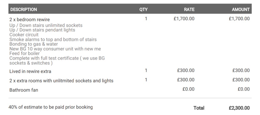

We still owe him £1400
