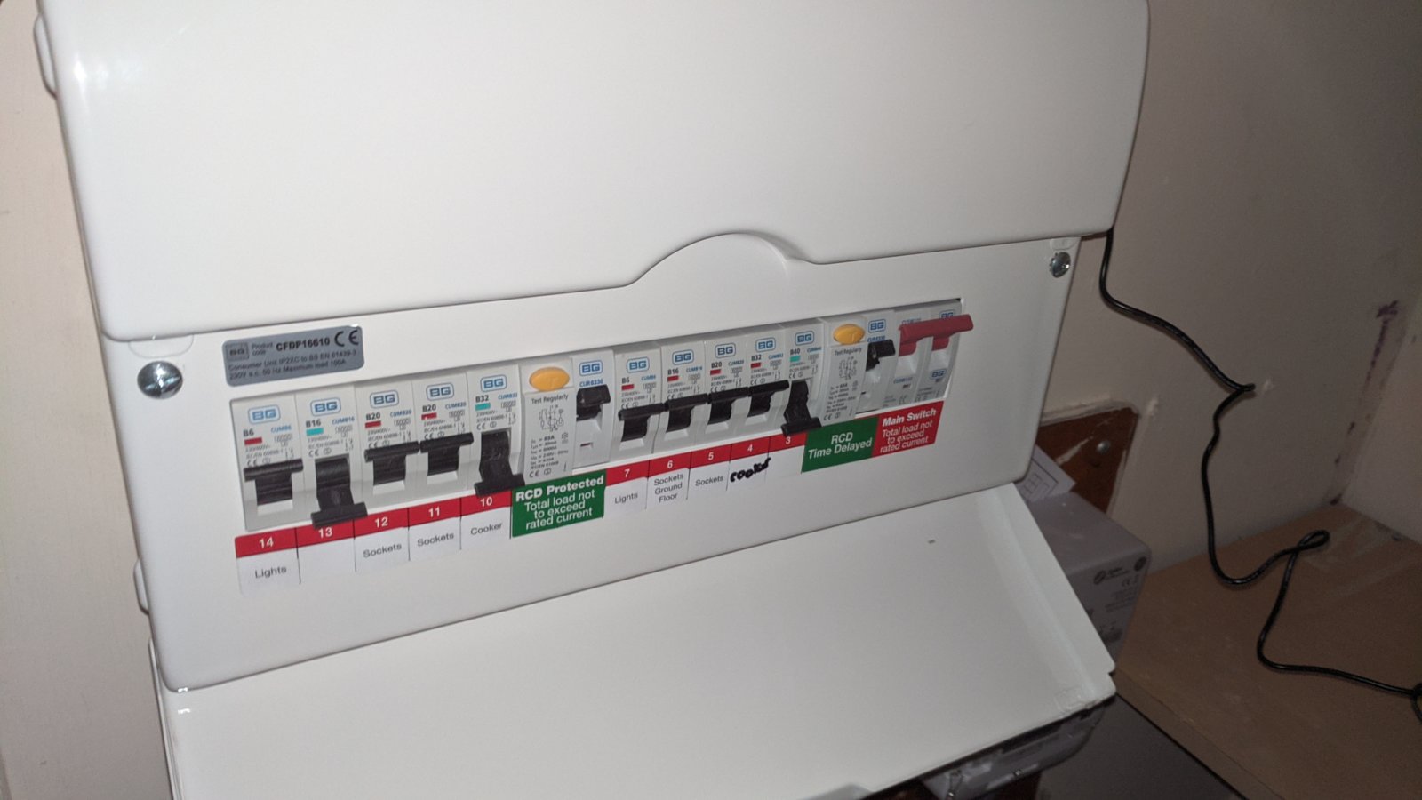

I take it h hasn't actually finished yet as such - The labelling isn't ideal yet "Lights" for instance should be "Lights up" or "Lights Down" but have to give him slack until you get the install Cert with all Test results,
He's finished and invoiced me for the final £1380 which is due now. He says he will send out the certificate once I've paid the balance. He also says he can't leave my power on for too long without a certificate.
... He says he will send out the certificate once I've paid the balance. He also says he can't leave my power on for too long without a certificate.

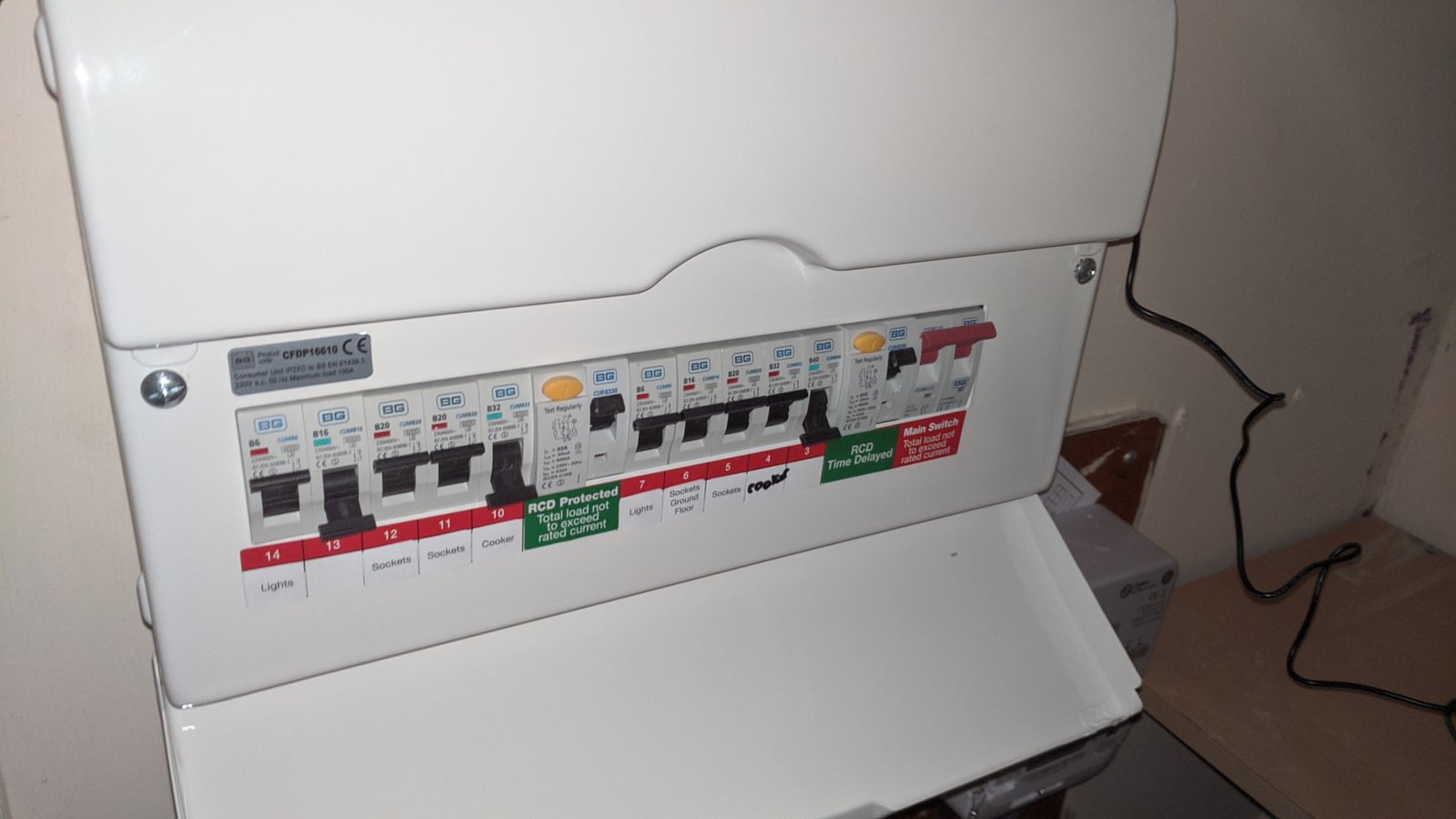

What did the previous board have with regards to circuits? Have you got a garage? Is it a large house? I find it a little odd there are four MCBs labelled sockets and two are labelled Cooker yet one is switched off. Just wonder if he changed his mind when terminating the cable for your cooker circuit of have you got two and one is switched off? If it's been tested correctly and there is a Cerfificate they'd be no reason to turn the power off but I think you've no doubt guessed that's just bogus to make you cough up the money.
He's now pointing to his T&Cs on his website which isn't the one on his invoices or what he informed me about to start with. He's pointing out that those T&Cs state he couldn't guarantee he wouldn't do any damage.
We requested 2 cooker switches putting in as when we get around to putting a new kitchen in, there will he a double oven and an electric hob so it will require 2. For now, one terminates inside a cooker switch and the other is connected to the existing freestanding oven.
The old board was only had about 6 switches on. It's a 2 bedroom semi with a conservatory and utility room.

Need a closer photo of the consumer unit. The label says "Time Delayed RCD" and that is very very wrong, if that is what he has fitted. Also, lets see the inside. That's the mark of an artisan.
Looks the same as the other one I suspect he's placed the wrong label on it or his apprentice or somthing. Good spot though!
