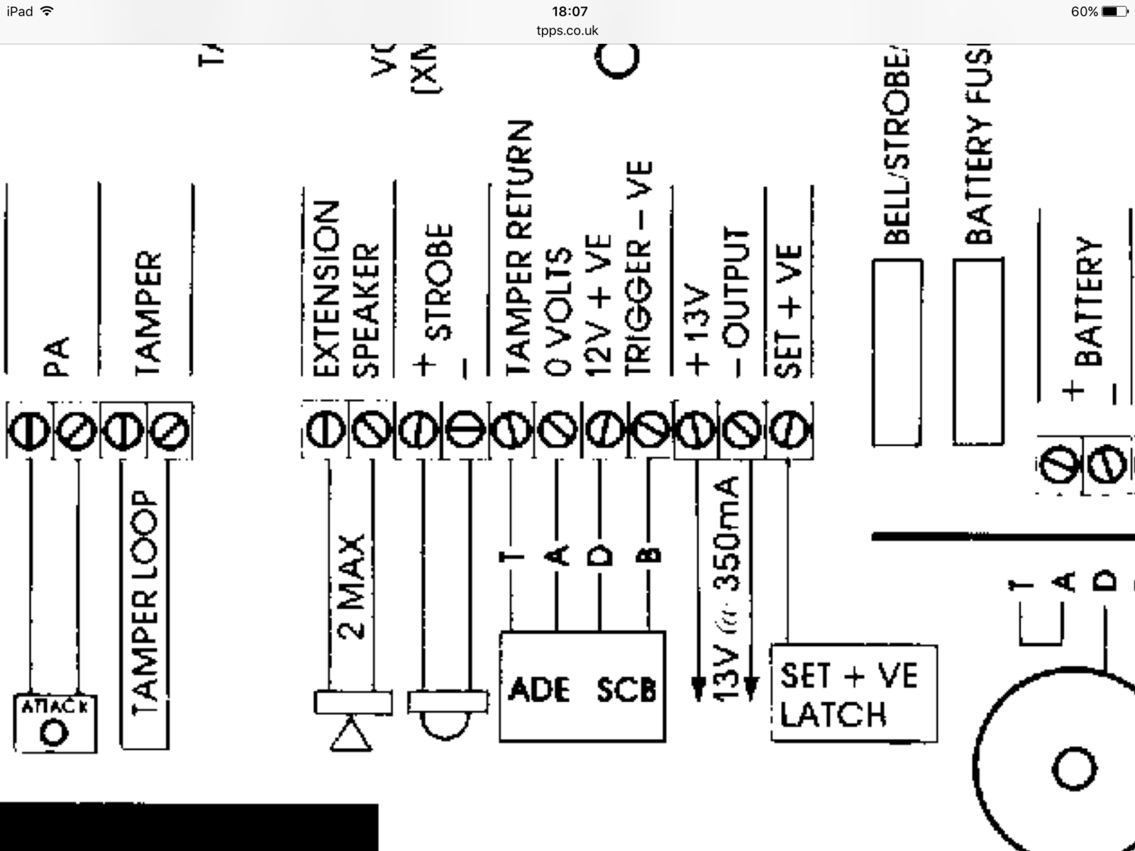

Otherwise 100% (if elderly) Optima XM6 panel with good battery, and Pyronix "Belle" outside sounder, alo with a good back up battery. I am a radio ham and when I transmit on 136kHz (yes, kHz LF) it will make the outside sounder squawk very briefly and intermittently every few minutes. The two LED's in the sounder also briefly change status. If I put some 0.1uF or 1uF ceramic caps on the bell trigger and PS wires in the control panel and the sounder box is it likely to effect a cure? I don't really want to have to run the wire from the panel to the sounder in screened cable if I can avoid it... I can't decide if RF is getting into the panel, the lead to the sounder, or the sounder itself. Neighbours are not happy as I sometimes TX at night. Thanks

Could you go into a bit more detail please? Which bell cable do I need to remove at the panel end? Do I leave the sounder battery still connected in the sounder box? Thanks, sorry to be a bit thick, alarms are a bit of a mystery, although I have some electronic knowledge. I do not have circuit diagrams for neither control box nor the sounder. In fact a generic diagram of a typical sounder would be very useful to know what's usually within them, cheers sparkymarka. I really appreciate the help on this somewhat obscure problem!
Your going to snip each wire one by one from strobe + to trigger - leave about 1 cm in the panel SO you know what colour goes to what ..ok ...now if the bellbox nicad is ok the outside bell will ring , disconnect your panel battery and strip back the wire from the 0volts connection and put it on the black terminal , now strip back the wire from the 12+ Connection and put it on the red terminal ...the bell should stop , hold it in place with some electrical tape , now do your radio transmitter test , it would be better to take the bell cable out of the control panel box if possible , reconnect when you have finished
There may be a fault or maybe I am misunderstanding, but when I disconnect all the above, and disconnect the panel from the mains, and from its internal 12V battery, the sounder sounds constantly. Do I need to supply a voltage to the Trigger -ve wire to the bell box as well? What I may end up doing is putting a screened 8 core cable to the bell box and panel and use the 2 spare wires for a manual off switch for the sounder. The cores are failrly hefty to V drop should be minimal. Thanks for your help, if you have other ideas they are more than welcome! Cheers.
Where did it say disconnect mains ? , the idea was disconnect the bell box from the panel , keep it powered by the alarm panel battery and test your transmitter
That's the bell box's internal battery making the bell box sound. Put the wires supplying the hold off voltage to the bell box onto the + and - terminals on the backup battery. Unless you hide that switch really well and have constant knowledge that it exists and that it is on/off you really shouldn't add one to the bell circuitry at all.
But which wires supply the hold off voltage please, at the panel? I am not understanding the sounder hold off circuit I think....
I told you in the post above which wire to put on the battery , It could be wired in any colour combination so that why the diagram was posted , post picture of pcb with wires connected
