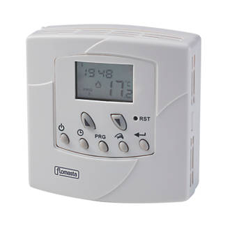

Does changing the temp setting make any difference & is it one of these https://usermanual.wiki/Flomasta/Flomasta4718GManual1002605.486932721 if so have you tried ringing the helpline
That's the one - I'd looked at the manual but hadn't actually spotted the number thank you! Don't tend to expect big brands to make themselves available by phone these days :) I'll give them a try.
Changing the temp doesn't help - as I say, the controller/transmitter seems to be working fine, the flame icon appears showing that it's trying to turn on the boiler, and the boiler controller/receiver responds by audibly and visibly switching over to "on" with a green light, but it immediately (within a second usually, sometimes 2 to 3 seconds later) clicks back off again. It tries again a few seconds later and then gives up until the transmitter sends the signal again (maybe 10/15m later) or the transmitter is power cycled and sends again.

Well, having observed that the problem was much worse (almost 100%) first thing in the morning, I developed a theory. And having tested the theory three days in a row, I have solidified a conclusion, which is that the receiver won't work if it's too cold. Which means, as you'll have realised if you're following along at home, that I have a heating system WHICH ONLY WORKS WHEN IT'S WARM :LOL: GOOD JOB FLOMASTA! (y)
(I cycled it half a dozen times, then ran a heat gun over it on a low setting for 10-15 seconds until the casing felt warm, in case you're interested)

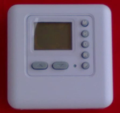

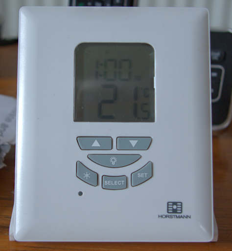

Yes old post, however my problem spanned quite a time, this IMGP7319_20_21_tonemapped.jpg seemed the ideal wireless thermostat, would have preferred hard wired like this ae235.jpg but the people who fitted my mothers central heating fitted this 84067_P.jpg thermostat, and cut off all the wires, the thermostat they fitted was expensive, and it had a fail safe, if the base did not get a signal every ½ hour it auto shut down, but is also had anti-hysteresis software which caused it to start cycling as target temperature was approached, which is last thing you want with a modulating gas boiler. This ae235.jpg in my own house replaced a Horstmann DT2 upload_2021-11-26_11-36-58.png nearly the same size, but DT2 only 4 program times the replacement had 6 but the old DT2 simple press up button for warmer, down for cooler, the replacement had to keep instructions with it.

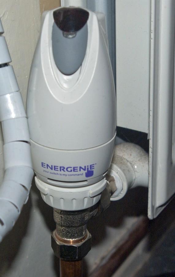

The IMGP7319_20_21_tonemapped.jpg got slowly worse over time, the first time it failed that I found out about it failed to turn off, mothers living room at 32°C not what is wanted for 90 year old, ended up facing the base in the kitchen, with the 84067_P.jpg wired in parallel so if one failed the other worked, and electronic TRV heads IMGP8035.jpg to ensure it did not over shoot, and also allowed me to monitor at home temperature of mothers house.

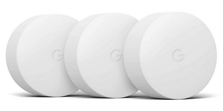

Main reason for IMGP8035.jpg was didn't want to get another thermostat which would also fail, but actually still got caught out, they were claimed to work with Nest, so new house had 4 TRV's from mothers old house, so seemed good idea to get Nest Gen 3 which they were designed to work with, but seems Google has bought out Nest and removed support, seems new idea is to have remote temperature sensors upload_2021-11-26_11-56-42.png but not released in UK, and not sure if USA version would work.
