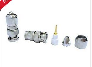

Am installing a second hand 2MP AHD from a friend, but need some RG59 cable, probably Shotgun as that seems to be cheaper than buying a separate .75mm power cable.
Seem there are varying qualities, some say with Solid Copper Conductor, (the best ?) others with copper clad Alum or Steel, plus the screen could be plain Alum or copper coated .
The max distance for our cables would be 20 mtrs, so wondered which is the best one to buy? ..though we may upgrade the 5MP in the future ?
Also need a 5A power brick, though there are many around, know that some can be poor quality, any suggestion as to a supplier of good ones.

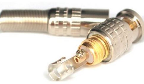

As we are only doing about 8 bnc connectors anything wrong with these screw on or solder types vs the crimp ones ?
thanks
Have to make a confession here, I love the twist on bnc rather than crimps when I do analogue, but then again I don't really do any.
if the end is cut correctly and its twisted on hard found it ever so reliable, you know when you haven't done it proper as a gently tug and it falls apart a good hard tug when its done right it doesn't move at all.
I use good cable from my local distributor and it doesn't cost the earth.
Not a fan of Cat5e/Cat6 and baluns, getting good baluns right for the tech used seems to be an issue for me.
Then again I am talking of an interference no one else could see until I pointed it out to them. so not sure if I was being fussy to be fair.
tend to do IP only.
As above really, genuine copper cable, twist on BNCs will do for a one-off job like this and a decent boxed power supply from Haydon will be miles better than a power brick.
