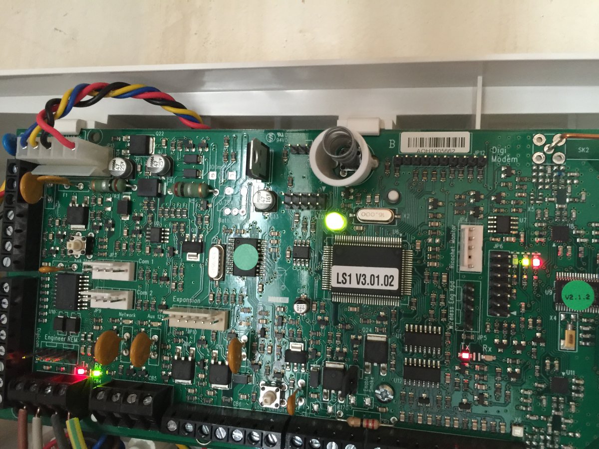

Hi guys, I've just installed this alarm in my new house, the electricians did all the connections, but it keeps saying battery fault...what battery is it talking about?
I would really appreciate some help here.
Also not 100% sure the connections are right, I will upload a picture so you can see, there are 2 cables on the left black and red which has not been used yet...

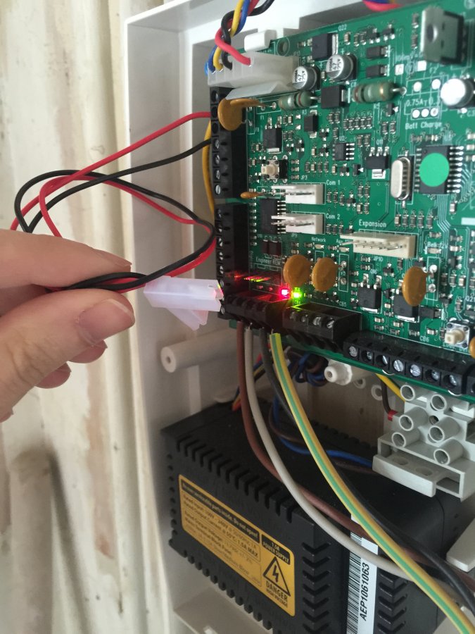

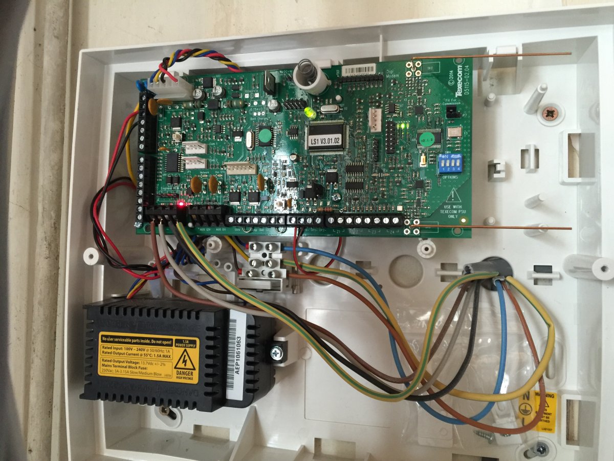

I can't see any honestly...I attach 2 photos

Electricians ....say no more I would check to make sure it works ! Lol
Yes it's missing the battery as reporting !
Well he was not supposed to install it, it just connected the electricity to it.
So what battery shall I put? And where? They don't explain anything about it on the manual...
What is the commission link? Sorry I'm very new to this
I found the installation instructions online, I think they mention a 12v 7AH battery. It is probably a SLA. But you had better check. I have always been very pleased with Varta but I am not an alarm person. You may end up needing an extra connector.
I see a battery-shaped space bottom right of the case.
12v 2.8 / 3.2 ah ( yuasa / power sonic ) will be fine as I assume there are no wired devices or bell ?

I've ordered the battery. So when I'll receive it I just need to connect the black and red cables and then the error about the battery will disappear right?
