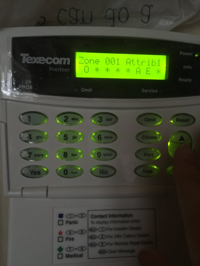

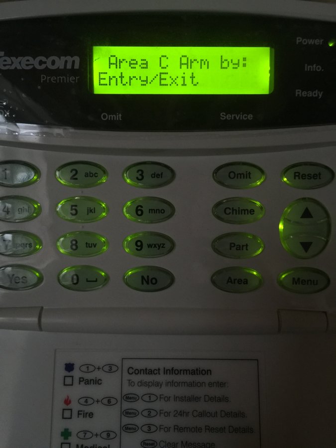

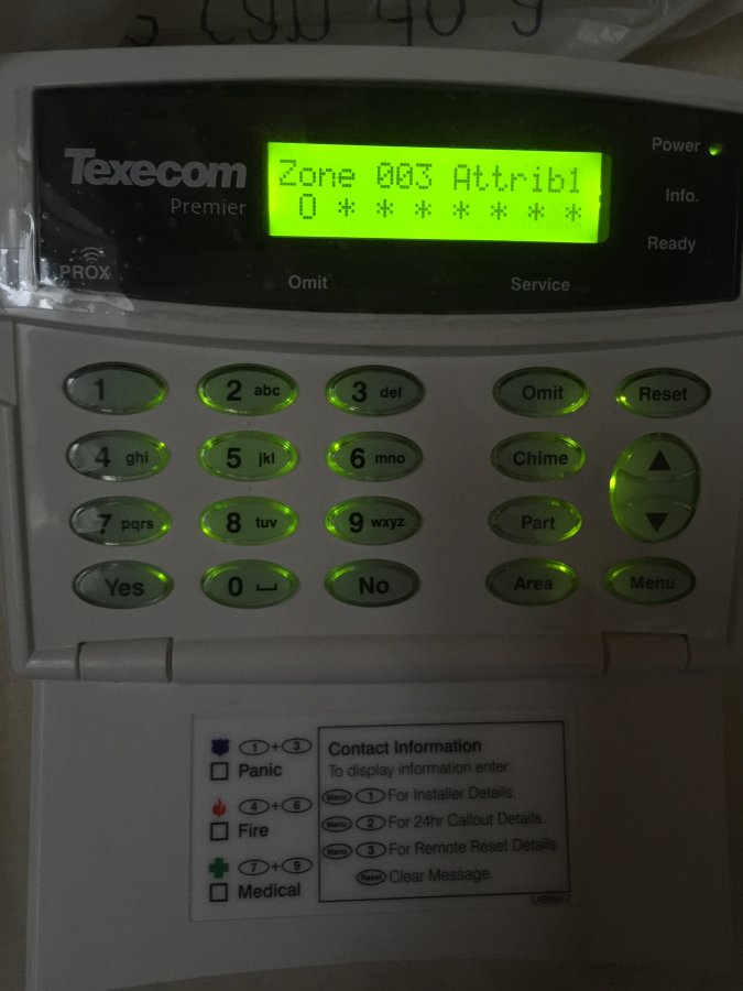

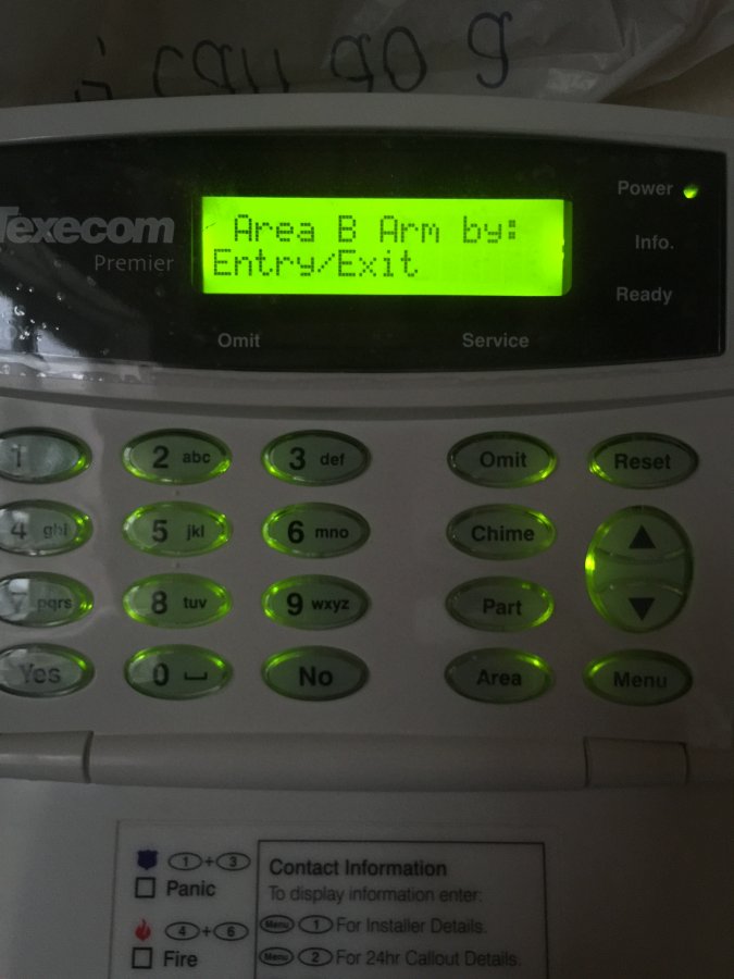

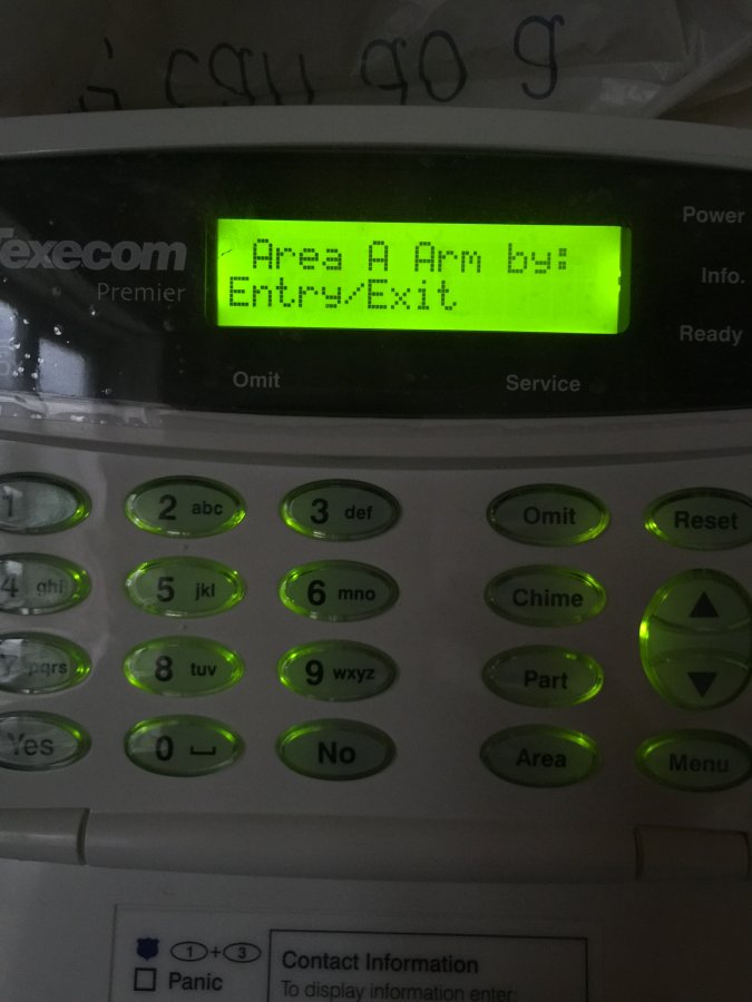

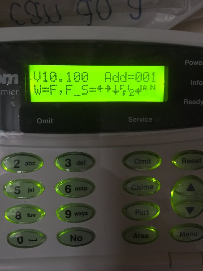

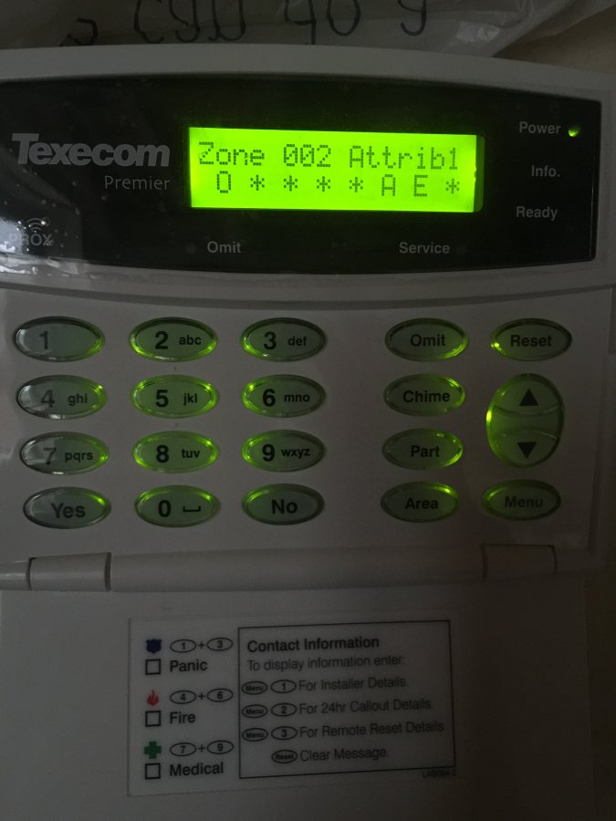

Ok I took some screenshots.
How can I turn the battery monitoring off to see if it would arm?

turning off the battery monitoring isn't going to help.
1. the keypad is address 1. check the area keypad I is assigned to.(Keypad setup) default is area A
2. I see attributes for zones but no zone type, zone wiring, no area, note wireless should start at zone 9 if its wireless.
3. if arming mode is entry exit need to see the entry exit zone open and close after the exit has started.
you have a lot still to learn, but your getting about in the menus which is good.

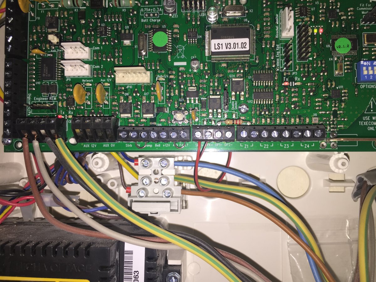

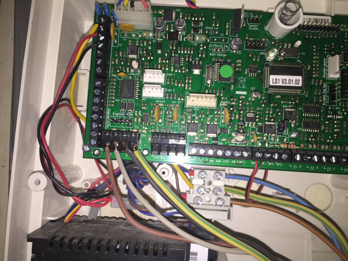

Also, has the wiring been done correctly?

No the wiring is not correct ?
Using a mains cable to wire the bell circuit has not enough cores so you will have to link the strobe to make that work !
Also you could cause yourself a problem if 240 volts is connected to that. Cable?
It will blown the control panel up as all connections are low voltage on the pcb.
Your pics show zone 1,2 etc wireless devices should to learnt and programed from zone 9 onwards
Oh ****...the electrician did that wiring.
The bell is wireless.
Do you guys have any pictures of a correct wiring?
The network is wired with mains cable, wow, there is no bell wiring from the picture.

Get some 8 core alarm cable, want to do this because I am scared you are going to get injured.
