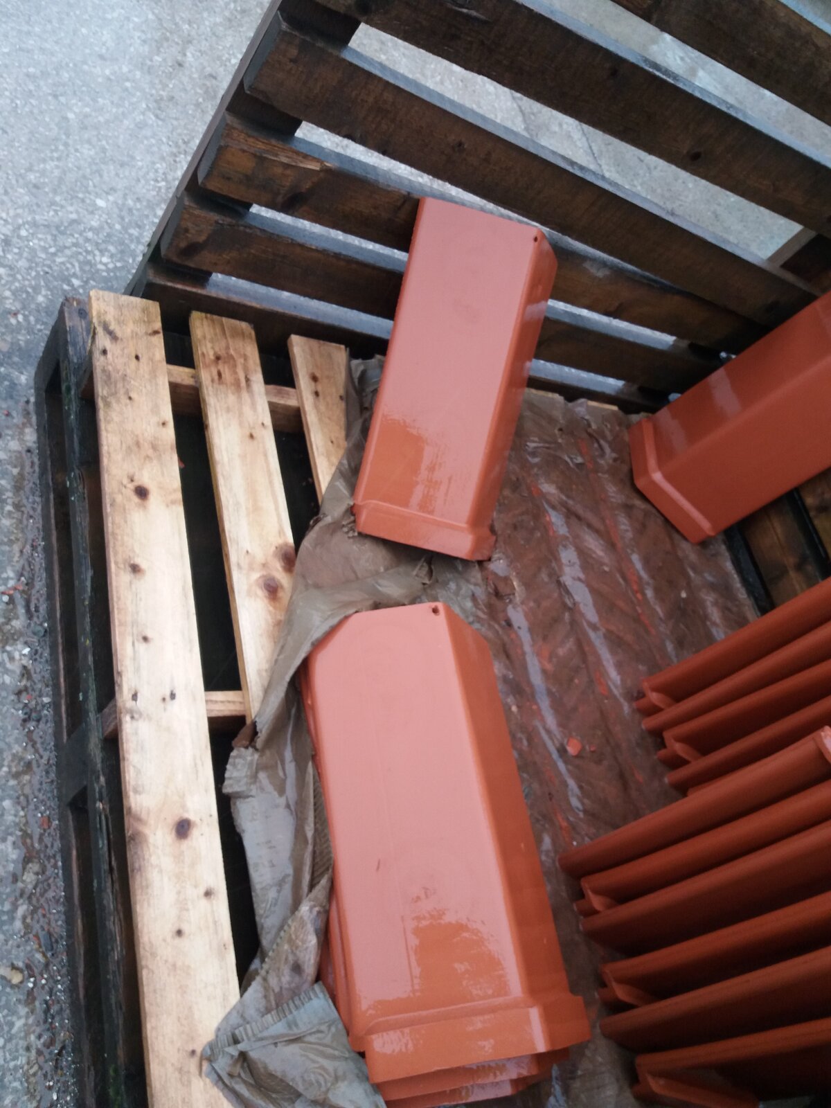

I couldn't see any holes in the Marley angled clay capped ridge tiles so I asked the manufacturers. They say that we must drill holes in them ourselves if we want to mechanically fix them to comply with BS5534. It would be so much simpler if they supplied them ready to use with the holes already in place...
Ok well maybe I was mistaken! All the Clay Capped ridge tiles I have bought from UK Slate over the last few years have certainly got fixing holes.
I was at the builders yard this morning and I saw these! 20210206_104411.jpg

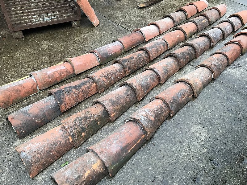

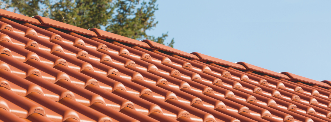

When I was in Germany, I noticed that most of the ridge tiles were tapered, so that one fits into the next. On the skinny end there is often a hole for a screw at the top, and sometimes there is also a clip attached that comes out from under the big end. These would have a dry fit type seal underneath I suppose.
Whereas these would have been cemented and screwed down.
I have not seen tapered ridge tiles here, they all seem to be straight, which leaves a joint between each one that depends on cement, whereas these ones mostly don't leak even when the cement is missing.
Yep seen those . There is a metal clip system too for them .
