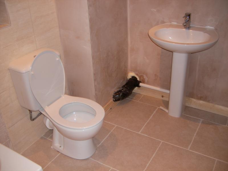

Hello all
Hoping someone can help.

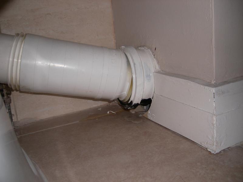

Had a toilet fitted about 10 months ago and have had a couple of problems with a small amount of leaking arond the joint with the soil stack.
:?: Is the connector the right one - is there a better one ?
He came back once previously and put some sealant where it joins the stack but it has not fully fixed the problem.
As background information, I think the leaking happens when we use the ensuite next door and the water flows from the black pipe visible and seems to splash across the vertical stack. :?
Fitter will come back again to try to resolve in the next day or so. Meanwhile I'd like to get some background to help steer the solution!
TIA
you could do the job proper, take the whole contraption off, put a lenght of 4" soil into the junction where the staight pan connector is, put a 4" 90 degree bend on it just under the pan outlet, then a bent pan connector into the 90 bend, use a small piece of 4 "pipe into the bent as a pan connector is meant to go into pipe and not a socket, all those flexi connectors are for diy ers, we don't use um,

I'd try a 135 degree single socket bend.
Not saying it will work but worth a try.
Yep, think I follow this.
Given the fitting was not done as a DIY job, I would hope for a robust solution. :D
I think the pan outlet is not quite in ideal position - as in both are not quite in the right plane to link simply. It may give a backup option though.
Thanks for the help from all.
Sorry to get back to topic - but the way it's been done is a hopeless bodge.
The fins of the pan connector are not designed to fit inside a soil SOCKET but into plain 4" pipe. As said above, put a short length of soil pipe inside the socket then use a flexi so it lines up properly.
