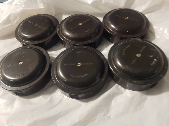

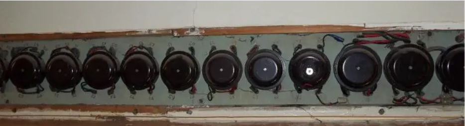

Ring final spurred off from a JB to each socket
well at least it's done with JB's and not chocbloc, My daughter purchased a house where the lighting circuit where a piece was screwed to a joist at every light position and the 2 core flex for the pendant drop was knotted to stop it pulling through the PB Annoyingly each simply passed through a rose so it appeared to look correct.

This video from 10 years ago today is one of those but this one has a T&E 'tail', in the kitchen which was a round enclosed fitting
