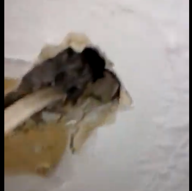

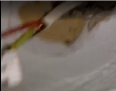

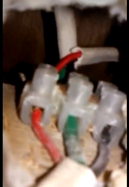

well at least it's done with JB's and not chocbloc, My daughter purchased a house where the lighting circuit where a piece was screwed to a joist at every light position and the 2 core flex for the pendant drop was knotted to stop it pulling through the PB Annoyingly each simply passed through a rose so it appeared to look correct.
And they were well painted in so not a selling action.

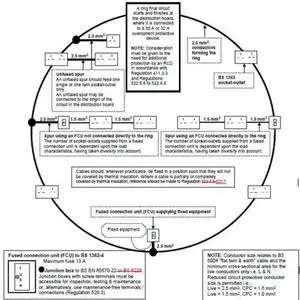

I forgot to say that another common method of wiring a ring final in the 60s was to do the GF as you would normally, but the upstairs sockets were just spurs off the GF RF.
