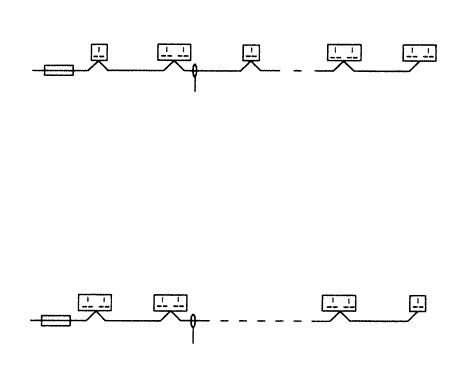

A radial usually means your sockets are wired up in a star configuration where all the sockets are on seperate wires, all of them leading back to the fuse box.
I think it usually means circuits like these...
