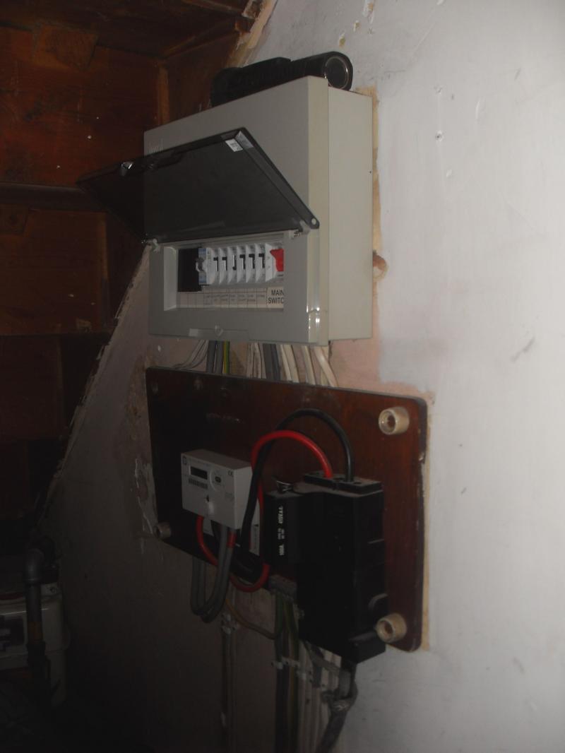

Having done Part P I am having a go at upgrading my electrics but have realised that although having the theory is fine the practicalities are more challenging. I've started with the first floor which seems to be laid out as follows:- starting from the dormer room in the roof there is a radial circuit of four sockets. The originating socket has two other cables going down to the first floor. One serves three sockets and ends. The other serves three sockets and (presumably, as the room in question is wooden floored and I haven't checked yet) goes straight back down to the fuse box.
I have two questions - firstly, is this an acceptable setup as it seems to be three separate radials originating out of one socket and there are thirteen sockets altogether ? Secondly, I have five pairs of 2.5mm coming out of the fusebox and under the top of a wooden plate with the fuse and meter on it (up, down, cooker, garage and kitchen) but only four pairs coming out of the bottom of the wooden plate going under the floor. Not sure where the fifth pair goes ? If the up and down circuits are radial as appears to be the case then there should only be eight cables altogether anyway (three pairs and two radial).

The up and down "rings" are both 32A. This isn't a great pic but there are five pairs of 2.5 going in the top and four coming out the bottom of the wooden plate. Sorry, just realised you asked for cover off. I'll do that tomorrow if necessary. It's just occurred to me that it's actually just one radial from the dormer to the fusebox with another radial of three sockets spurred off the originating dormer socket but I don't think even that is correct under current regs.

A radial can have branches of it, but a 2.5 wired one would rarely be fused above 16/20 amp.
The guy who owned the house before us was a bodge up artist (did property maintenance as a job amazingly) so I'm not surprised at what he's done. Perhaps it was a ring originally and he broke it to extend it into the dormer. There are several junction boxes on the first floor. The dormer room is about 9 years old though and signed off by the council - would they not have looked at the wiring ?

I'm still mystified about the number of cables in the CU. Guess I need to look inside the CU/post a pic as requested. As for the circuit, I'm assuming it needs to be either made into a ring or rewired 4mm/20A. There are 12 sockets altogether and I think it is under 50m but have to check that cos of the dormer. The work to add the dormer to a ring wouldn't have been any more than the work to make this bodge up so far as I can see. I'm going to have to change the CU anyhow as part of the work as it has no RCDs currently.
