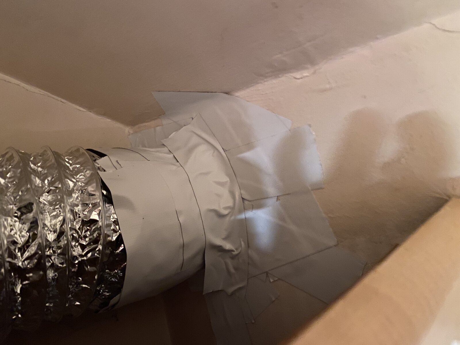

1. He asked for duct tape - i thought just to reinforce the fittings of the ducting ring - fair enough ( old one had that) - turns out it seems he has used 3/4 roll to fit the ducting to the wall outlet only with duct tape.

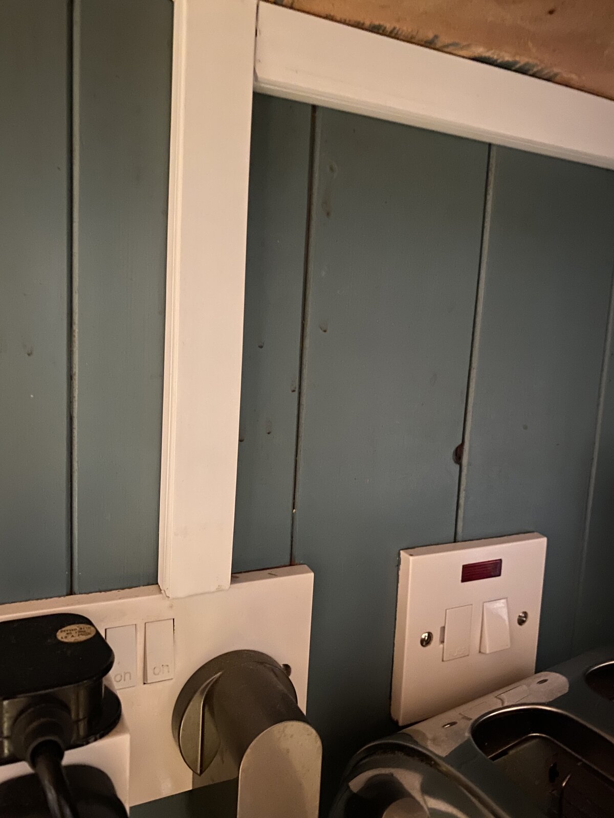

2. The old wiring was hidden - i asked when seeing what he was doing - said expected it to be hidden like old wiring was. His idea of hidden turns out to be plastic moulding covering wires stuck onto top of plug socket. Not hidden enough for me.

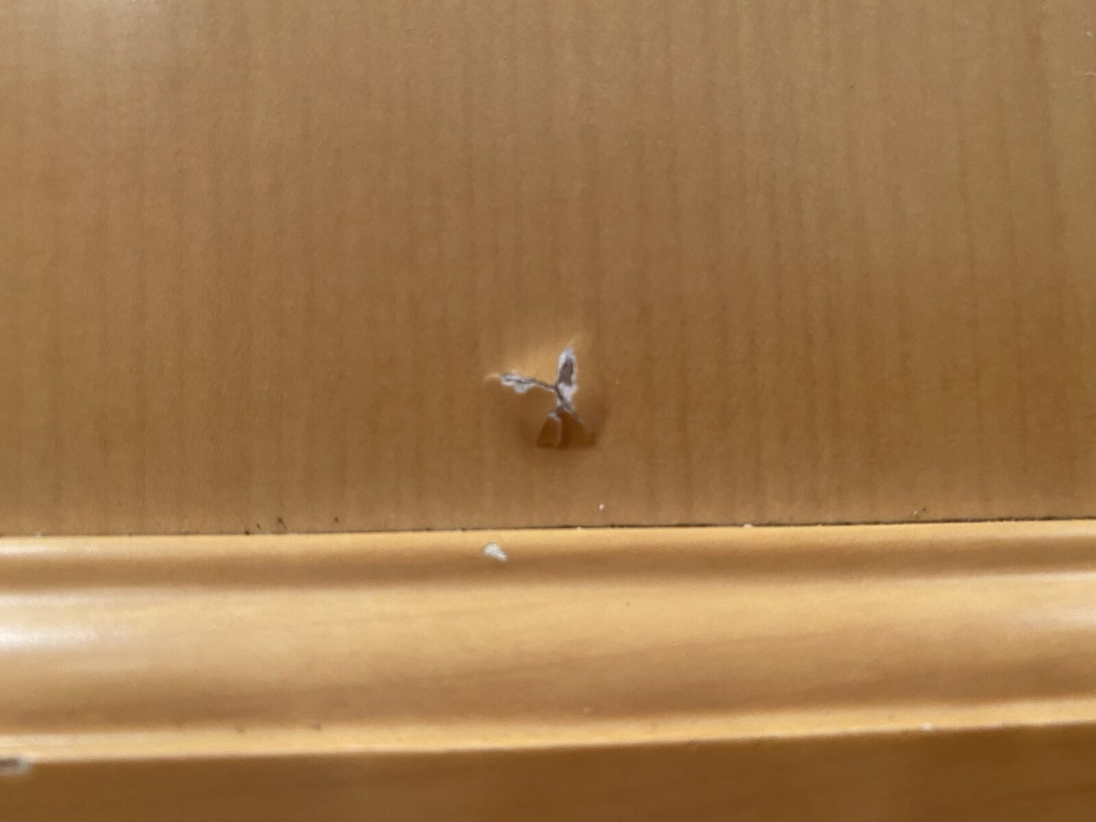

3. He's pierced through the laminate of the cupboard door where he screwed in the fan cover/door.

I am not an electrician but I have never used duct tape to hold an extractor duct.

A like for like swap should have been done and dusted easily in a couple of hours. The duct tape looks like a complete botch. I did a like for almost like, in an hour here.

If it was like for like, where was the wiring previously? And why new ducting?
The cost is excessive for sure.
Can't understand why existing wiring was not used - perhaps he drilled through it?

You shouldn't have to pay anything, what with the damage, the shoddiness, and the unnecessary (we think) surface trunking.
