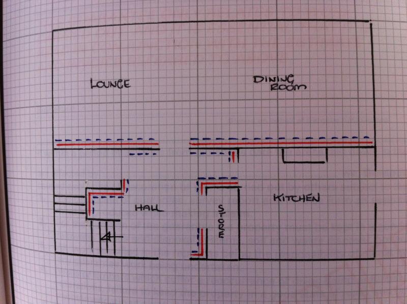

Exactly which wall is affected? (Any chance of a plan)How high above floor level is the damp area and is it spreading.? Does the weather affect it? What is the wall made from and what supports it?
Just ignore all the encamped rhetoric, concentrate on the actual advice already given and you'll get there, forums are like this...pinenot :)

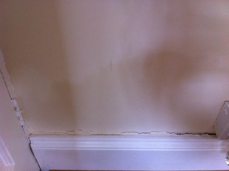

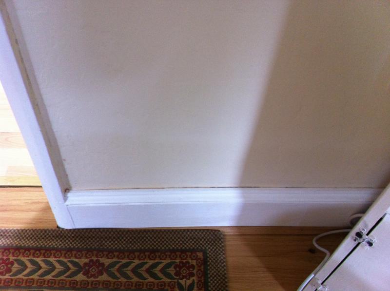

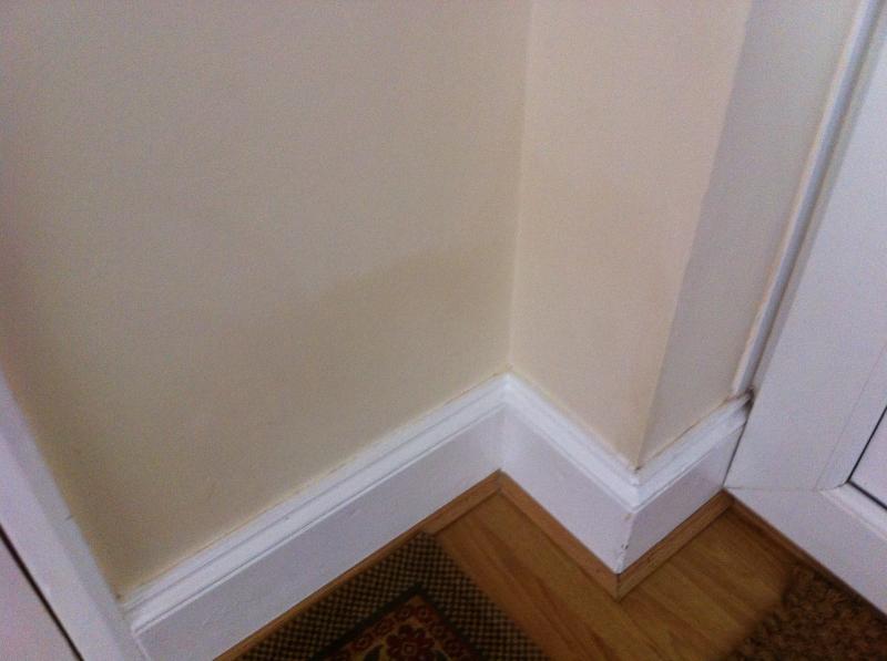

Yes the damp is spreading, i first noticed it on in the hall walls(blue line only) and then has spread across all of the hall walls. The living room has white paint and only noticed when I was looking for it so may be the damp on those wall were at the same time as the first hall walls. Here is the plan. The coal fire is situated in the kitchen.thanks Sophie
To be honest seems to look the same what ever the weather. And it's about 1 foot, in some places higher or lower. The walls are brick as far as I can tell.

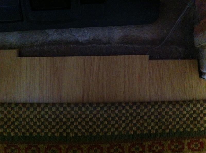

This is a pic of inside the cupboard in hall way, hopefully you can see in the pic that the floor under the laminate looks wet, but stops at the inside of cupboard :?

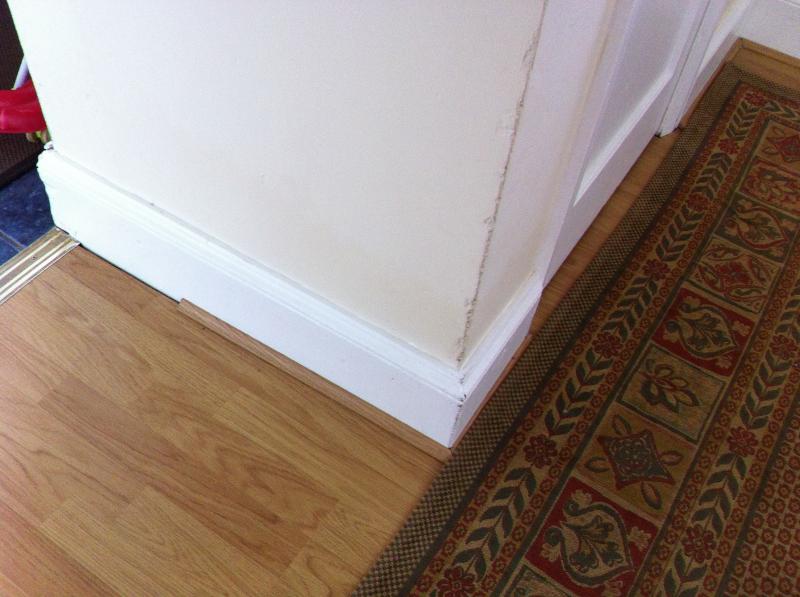

I had something similar in my hall, base of internal wall, and i've posted on here about it a while back (and several threads with varying angles on the same issue).
Anyway, this particular case was caused by the plaster touching the floor slab and the plaster was basically wicking up moisture in the solid concrete floor which was then going up the wall in one very localised place by about 1 foot.
Edit: see here:
(looks similar?)
I chopped back the plaster so it no longer touches the floor and that problem has gone away.
The underlying problem (i think) was a soil pipe in the concrete floor about 6 feet away was leaking underground inside the boundary of the floor area for a very long time indeed. As the ground is a heavy clay with poor drainage, the water from the soil pipe (and a nearby outside gully = shower and sink going to ground too) was finding all sorts of routes around the interior.
Most prevalent was actually about 4m away at the base of a wall at the opposite side of an adjacent room, which has improved markedly since the drainage issue has been fixed (about a week ago). Early days yet, but at least that is another "not helping anyway" issue sorted out. The rooms "feel" better too, and we've had an awful lot of rain so i'm really hoping that is sorted at least a big part of the interior damp issues out.

Under laminate is said to be wet in hall. Is this a screeded solid floor? Anybody been putting long nails /screws/plugs into floor...eg door strip and central heating pipe?
Or where is that soil pipe able to leak?
