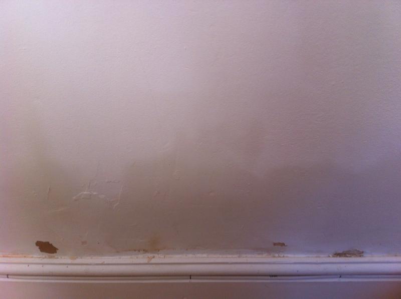

Sophie, it is difficult to work all this out without seeing it first hand, so I'm afraid some of this is going to be general information. I think you are saying that the dampness has got worse as time has gone on. That would indicate it is more likely to be related to how you use the house rather than an increasing source. You also mentioned part of the dampness may have got worse after laying the laminate floor. It is possible that your floor has always been a bit damp but not so much to cause an obvious problem. You then cover the floor with laminate and this pushes moisture (or moisture vapour) to the edges. One way to check this is lift a section of laminate and see if there is dampness underneath. Then re-lay the laminate temporarily on a sheet of polythene. Leave it for a month or two and lift it again. Is there moisture under the polythene or on top?
Check outside when it’s raining. (as somebody else suggested) Make sure the gutters and drains are not backing up or overflowing. Also check your hard surfaces and make sure they are not pooling up against the house. If you’ve got any of this you need to get it sorted.
The damp walls are not likely to be rising damp but there are tests that can be done that will prove it one way or the other. If you really want to be certain get a specialist in to carry out some tests for you. Not a treatment company. Go to a chartered surveyor that specialises or an independent damp specialist. It will cost you but at least you’ll then know for sure.

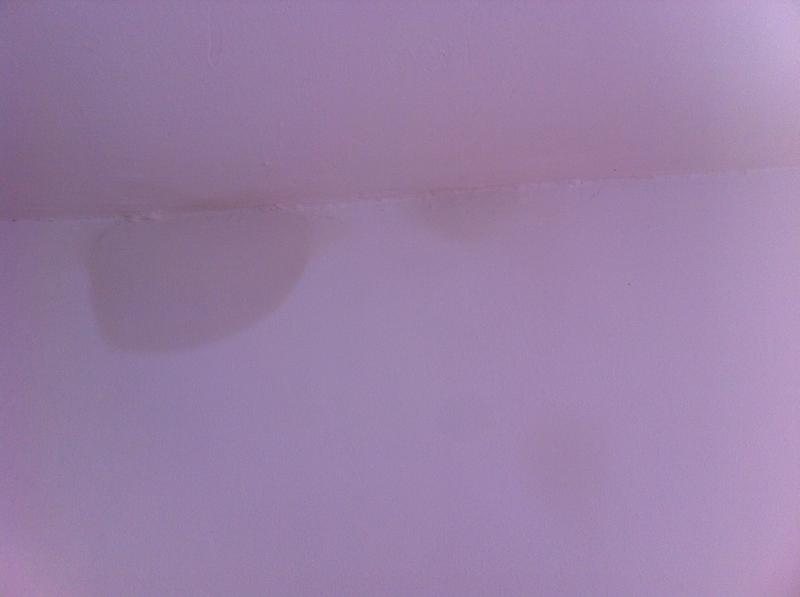

That said it is more likely to be interstitial condensation. This is water vapour that condenses within the wall and manifests as dampness on the surface. The reason it occurs at the base of the walls is because that’s where the walls are coldest – due to cold bridging with the sub-floor. There are two basic options really; you can tackle the wall itself (with insulation or a thermal break) or you can alter the environment. The first option is disruptive so if you are not going to be knocking stuff about anyway you will probably want to try altering the environment first. Basically that means reduce moisture sources, keep a bit warmer and increase ventilation.

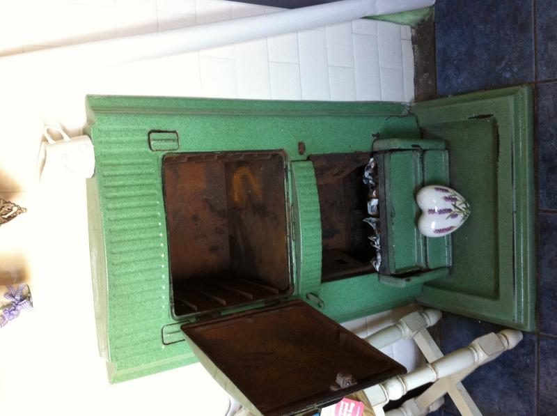

Thank you for your information and advice John. But I have a question mark over the chimney, as I have now seen a few damp patches on the top of the wall where the old fire backs onto. Shat are your thought and experience of this coursing the damp? Thanks
Old chimneys often cause dampness issues. If you look down the flue when a fire is going, at certain times it can literally be running with water. Over the years that water soaks into the masonry and mortar joints and contaminates the wall and plaster. That contamination causes dampness and staining on the internal plaster surface. First thing I would do is make sure it is actually dampness. What looks like dampness might just be staining. It can be hard to tell them apart.
Chimneys are also a weak spot in the construction. Older ones often had no damp proof course built in, so if the masonry gets saturated with rainwater it will eventually seep into the walls below. Water might also get in around the pot, through the mortar weathering on top (called the flaunching) or into the masonry itself via poor joints or rendering. If the lead flashings are not properly fixed water will obviously get in there as well. So if it does turn out to be dampness these things need to be checked.
Also make sure the chimney is well ventilated. (I can't remember if you said the chimney is used or not)
No we don't use it, we moved in last November and dint see an issue then. Unsure if it was used by previous owners. May be why I'm seeing damp now it's not being used?. From your experience how would you go about solving the problem if it is the chimney causing this? I am in the process of getting a professional to come and hopefully find the cause.

Check the ventilation to be begin with. Maybe do a smoke test to make sure it's drawing. You can buy a box of test matches or pellets from a local DIY. Secondly make sure it is definitely dampness and not staining. If dampness, is it penetrating dampness or condensation dampness? Either way you will have to track down the source. Staining is usually slightly brown in colour rather than just dark and it's more likely to correspond with the centre of the flue. (which might not be the centre of the breast) If it's staining you could try a stain block but that is usually only good for a short term. The only certain remedy is hack off and re-plaster. Unfortunately old chimneys are always a bit of a pain, especially when they are not used. There's lots of possible problems and sometimes it could be a combination of two or more.

How do you mean check the ventilation?(sorry first house and clueless).the dampness feels wet to touch and is yellow in colour with paint peeling. This pic is of the wall in the living room shared with the chimney breast in kitchen. (top of wall) (bottom)
