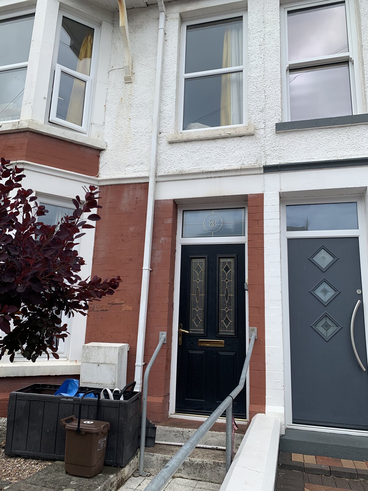

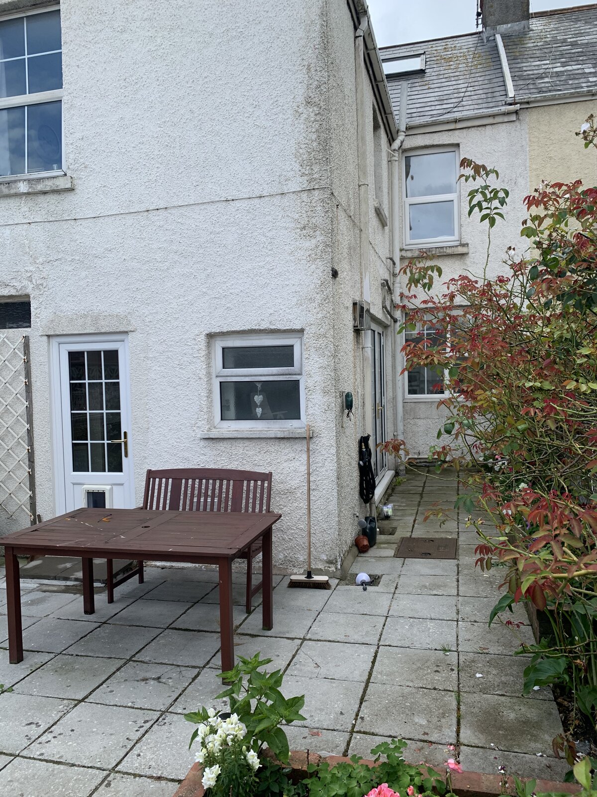

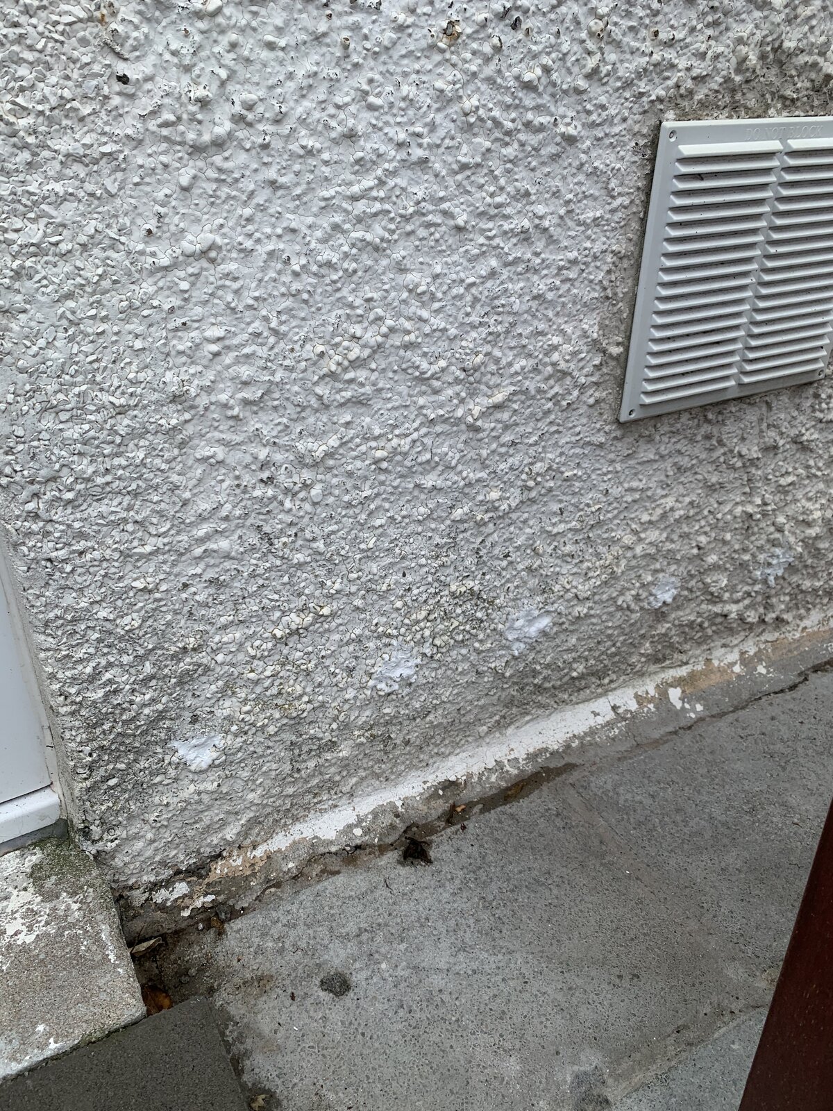

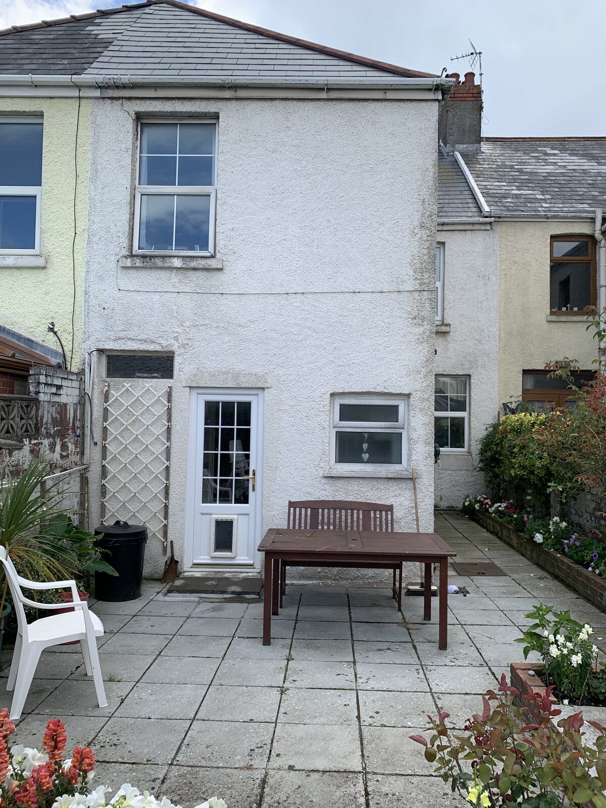

Post some photos please, inside and out. Include drains and downpipes. A house of that age usually (always) has drains that are cracked and leaking. Show the position and shape of the damp patches (flat, hilly, or mountain).
Walk round the house looking for the DPC. Mark it with chalk. It is pretty certain to be at the same height all round the house. Note any points where it has been covered up with paving, earth or render.

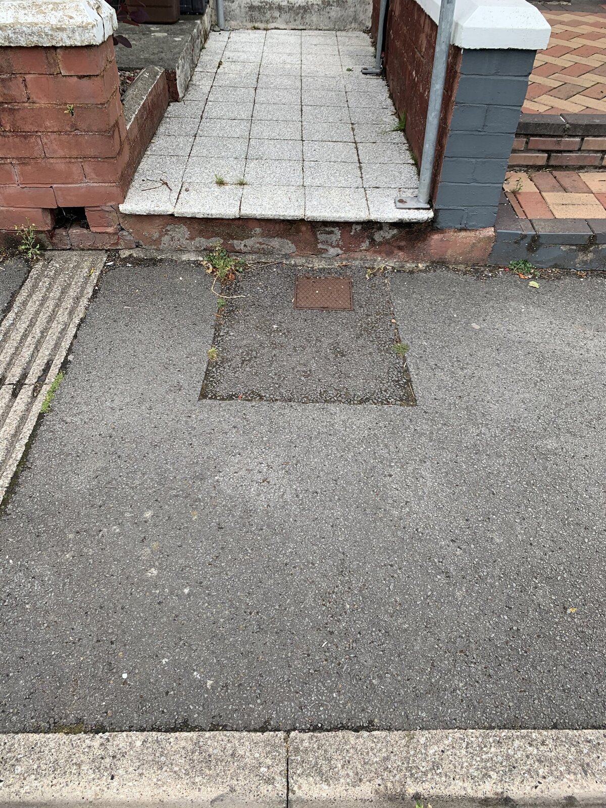

Find the outside stopcock (usually next to where the front gate used to be seen the house was built) and the inside stopcock (usually underneath where the sink used to be when the house was built). The supply pipe almost certainly runs in a straight line between them. It may well be leaking into the floor, often at the elbow where it turned up under the sink.

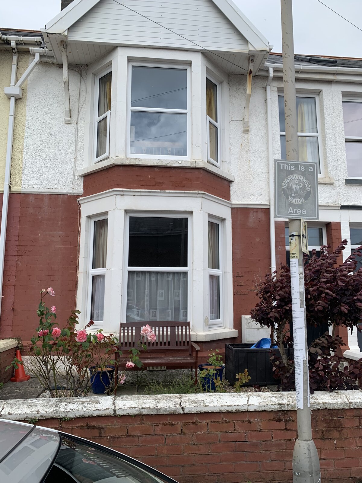

123= outside and water main

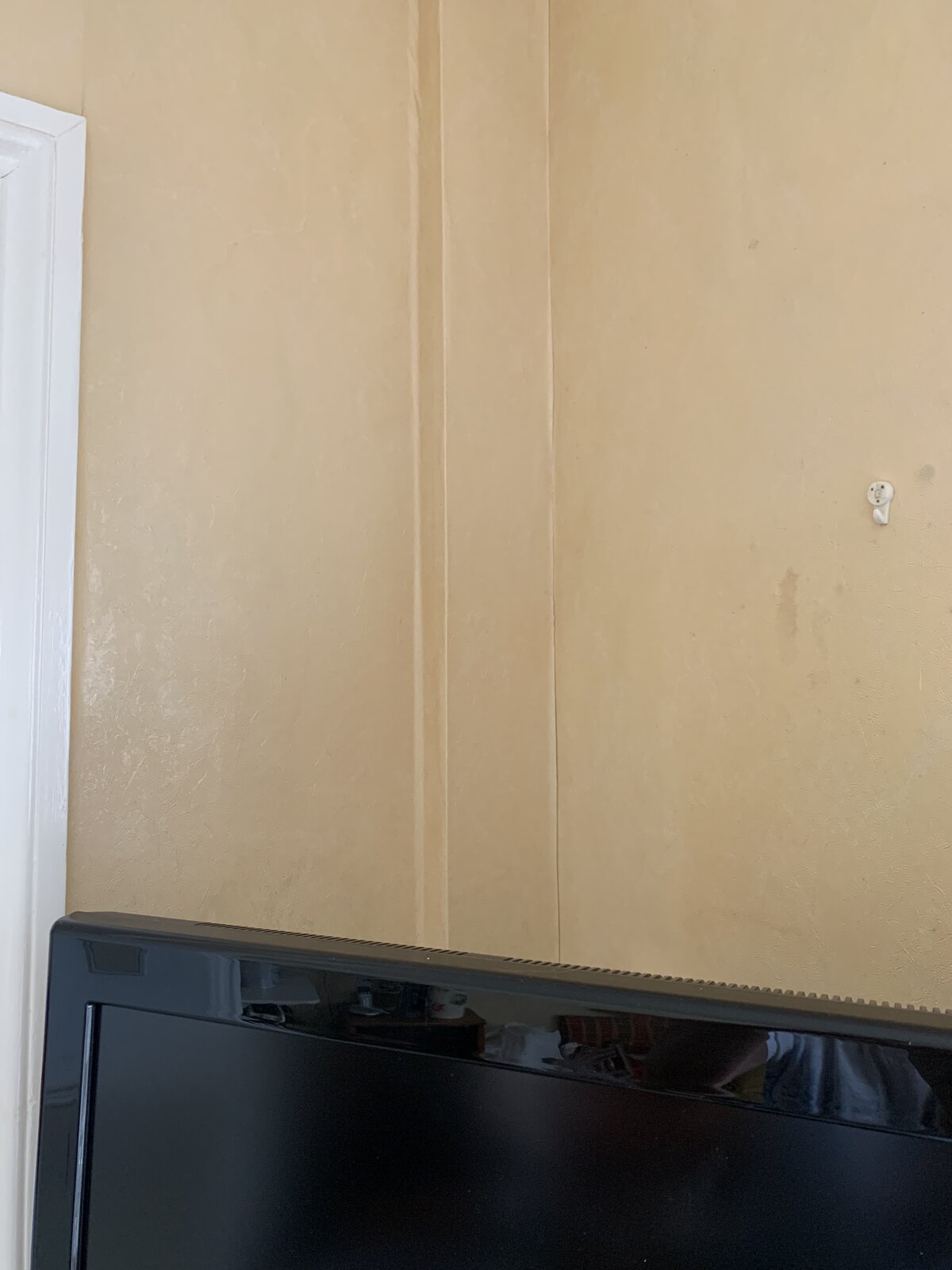

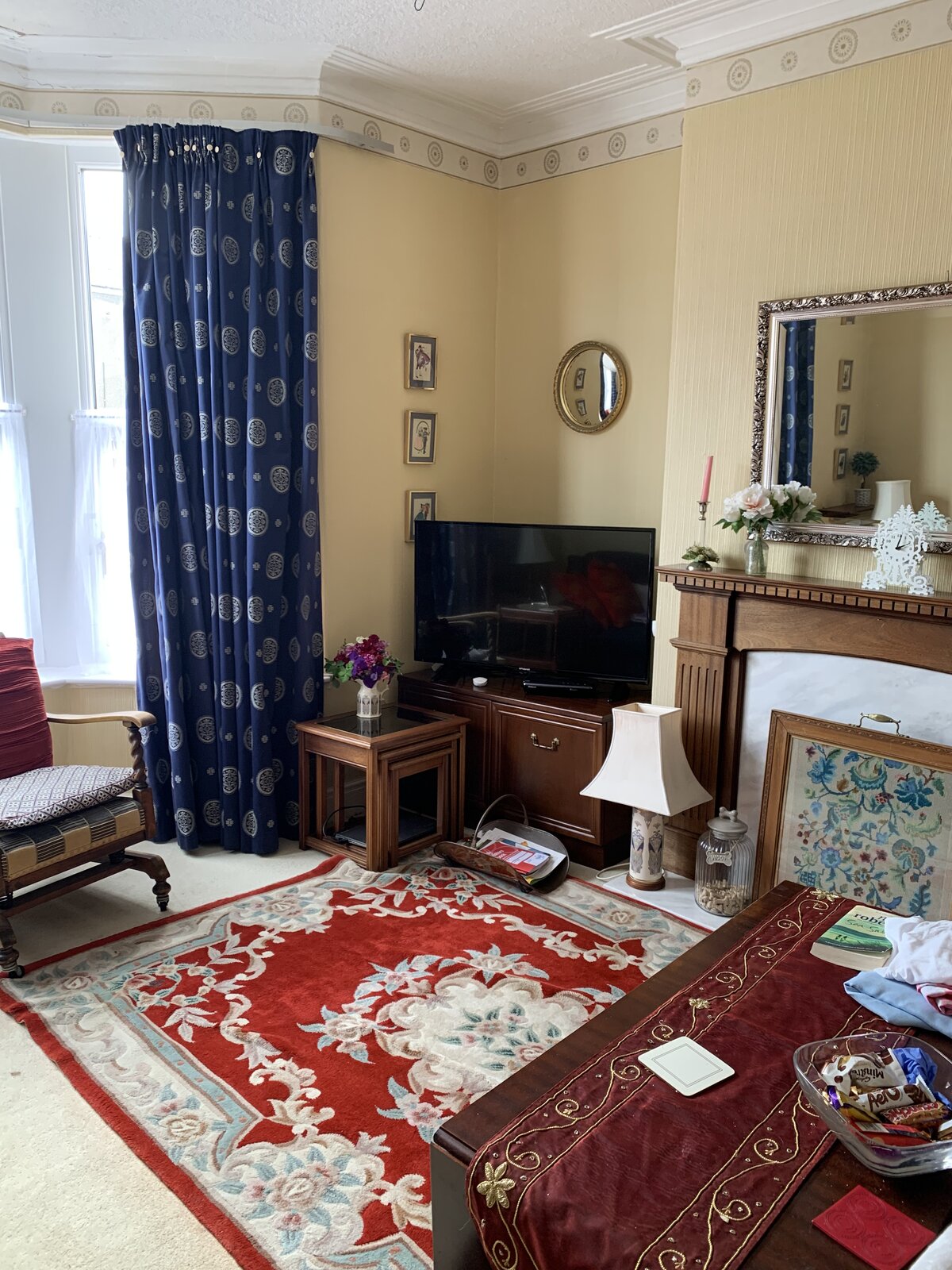

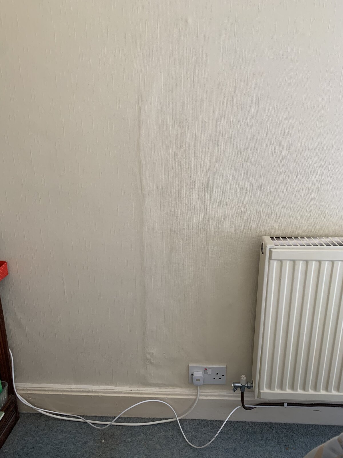

4= lounge behind tv unit party wall

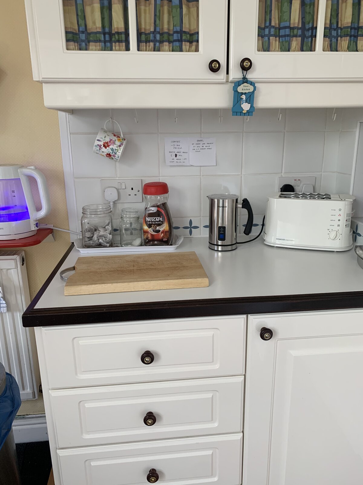

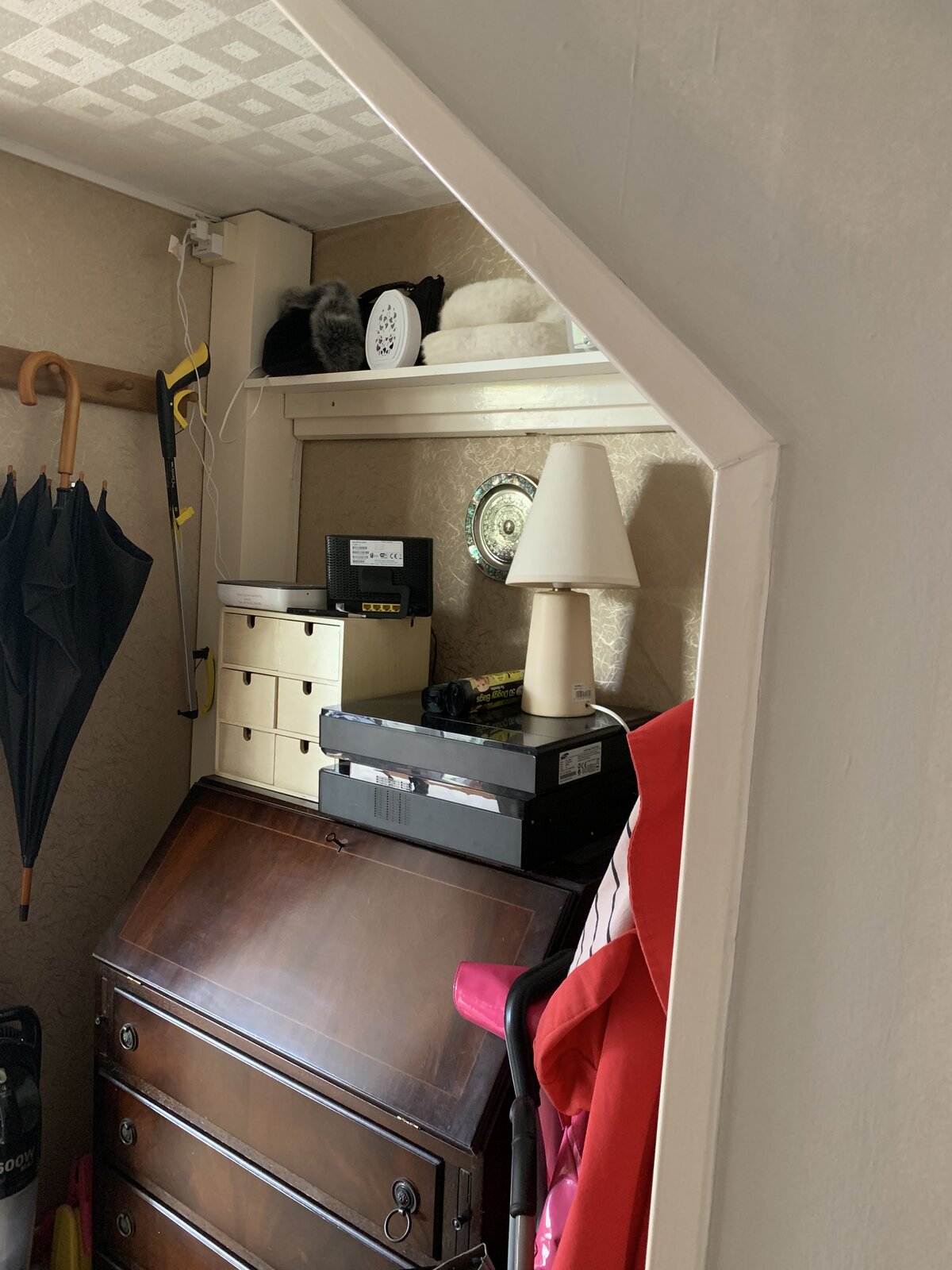

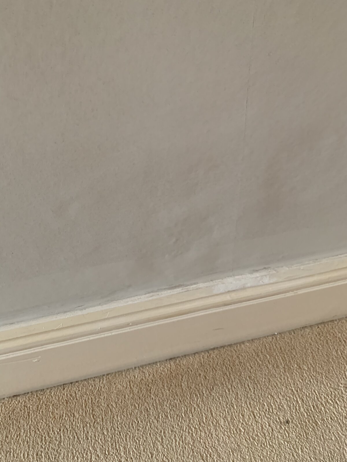

5+6=hall+kitchen behind

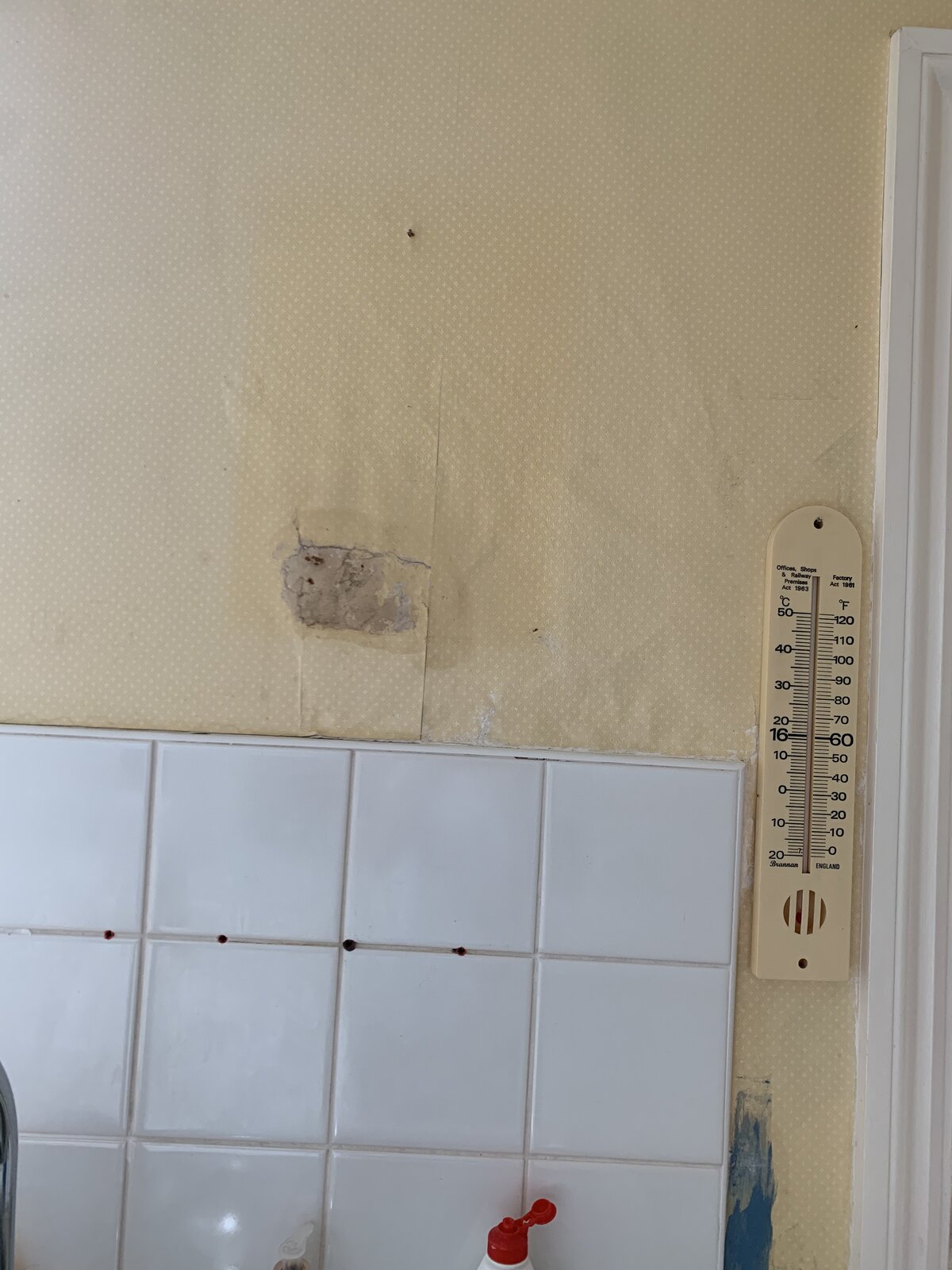

7+8=kitchen above sink +boxed in pipes behind

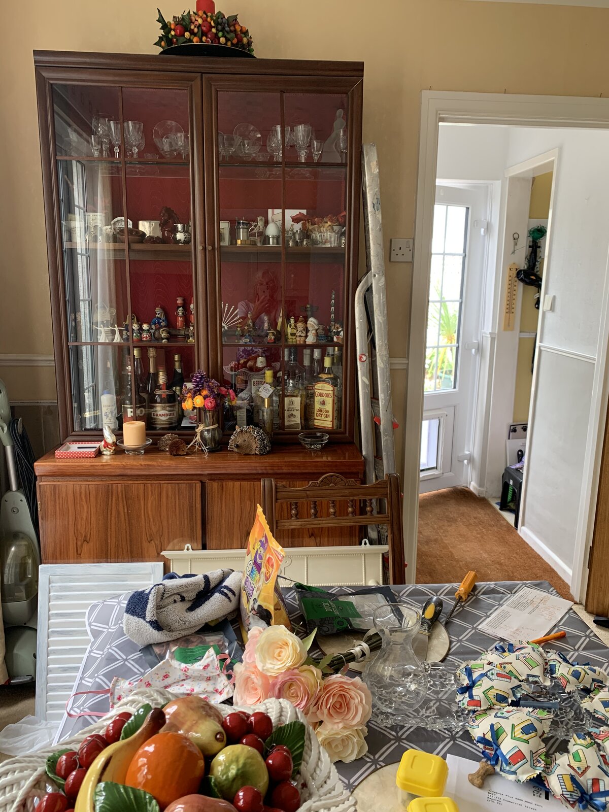

10=dining room behind unit

All walls built off foundations or a concrete floor should have a DPC, else rising damp may well happen.
However rising damp would only be at a height of around 900mm or so, and looking at some of the photos there is dampness at higher levels which would mean a different cause or problem

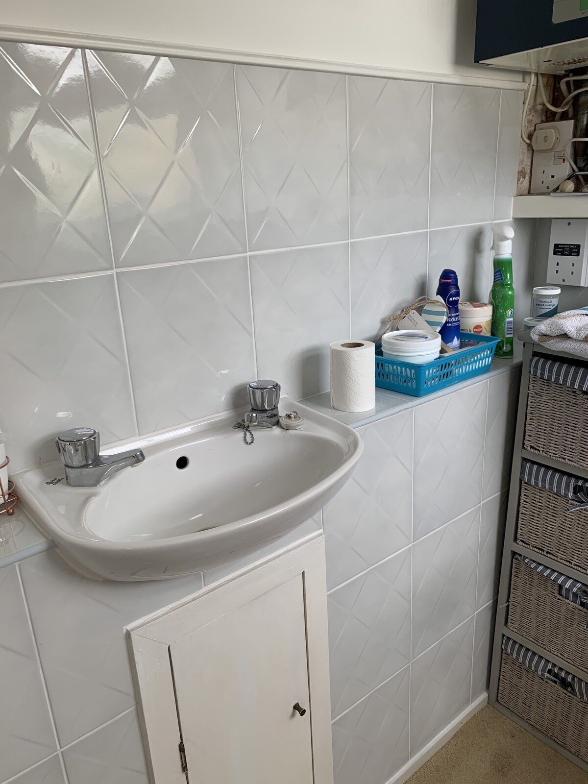

in the picture with the thermometer, it looks like it is running from above, for example if there is a bathroom overhead with a plumbing leak. Or, if an addition, perhaps a roof or gutter leak. Was there formerly a water-heater above the tiles?
in the pic with the TV, is that corner damp, and is that a boxed-in pipe in the corner? What is above?
i can't make out other damp walls.
though it does look like the incoming water pipe will be under the hall floor. is that damp?

The thermometer is near the kitchen sink with a bedroom above There’s a bathroom next to that and there’ve been a few leaks (repaired now) but the damp predates that

Tv’s in lounge with bedroom above with fitted wardrobes- no smell- but who knows? There’s no boxed in pipe but wallpapers bubbling/detached same as under stairs and behind unit in dining room.
The hall floors the original ?tile? from maybe 1900. I think it’s got ply then underlay then carpet. I’m hoping to replace with engineered wood.
