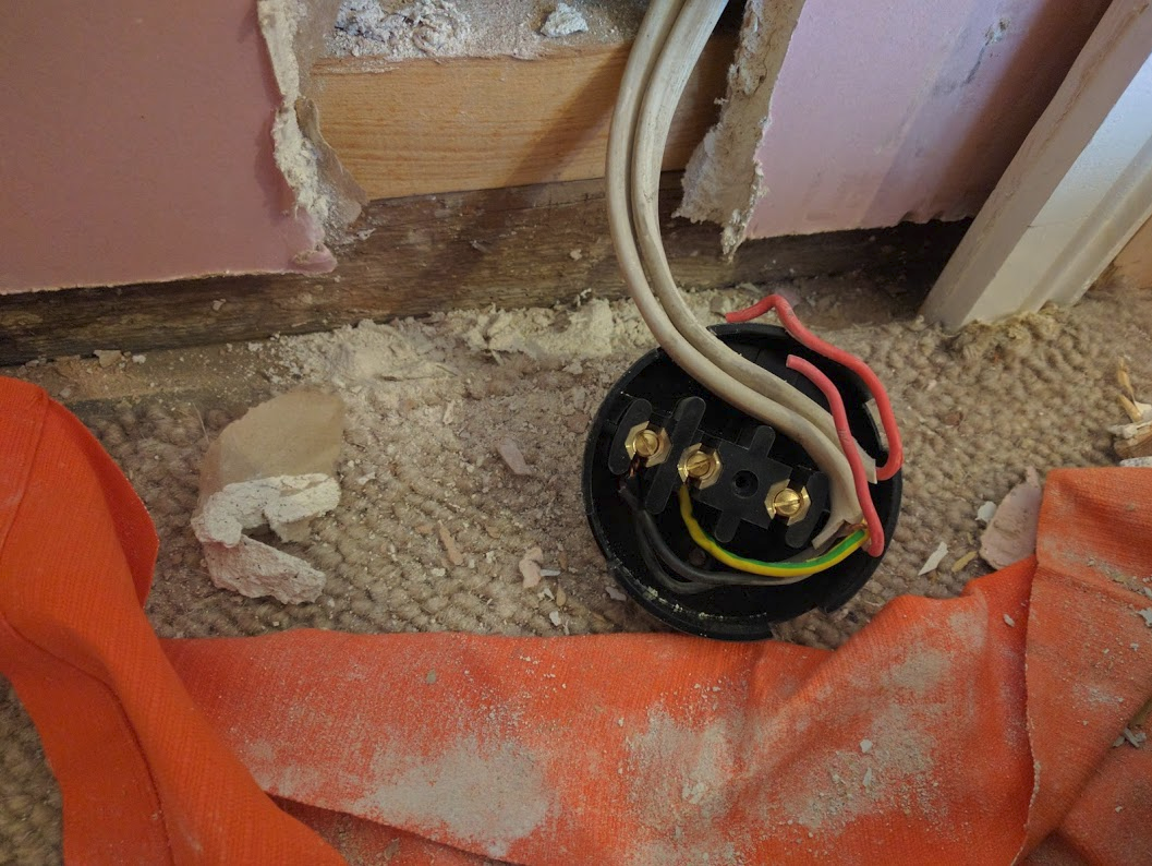

I recently found this junction box stuffed in a stud wall.
I knew there was a break somewhere in the ring final concerned from when I previously installed an extra socket. I had tracked it down to the leg running past this point but I assumed it was a damaged cable under the suspended floor.
I opened the wall to put in another new socket so finding this was just a coincidence (though it is an obvious location to put a socket). The plan was to fix the imagined break when I crawled below to wire it in.
I can understand that someone would provide for a socket but not install one and join the cables instead. But why leave the lines disconnected??

OK. Who knows the reason why its like that!. Are those two red conductors both live? Use proper test meter between neutral and the reds to confirm.
If you connect the two reds together, do you then get continuity on the R1 conductors round the ring?
If so, you are probably all set with an easy job for your new socket!
Yeah both live with the MCB closed, continuity between them with it open. It certainly makes it an easy job. I just wondered if there was any good reason why it might have been left like that even temporarily and forgotten about.
