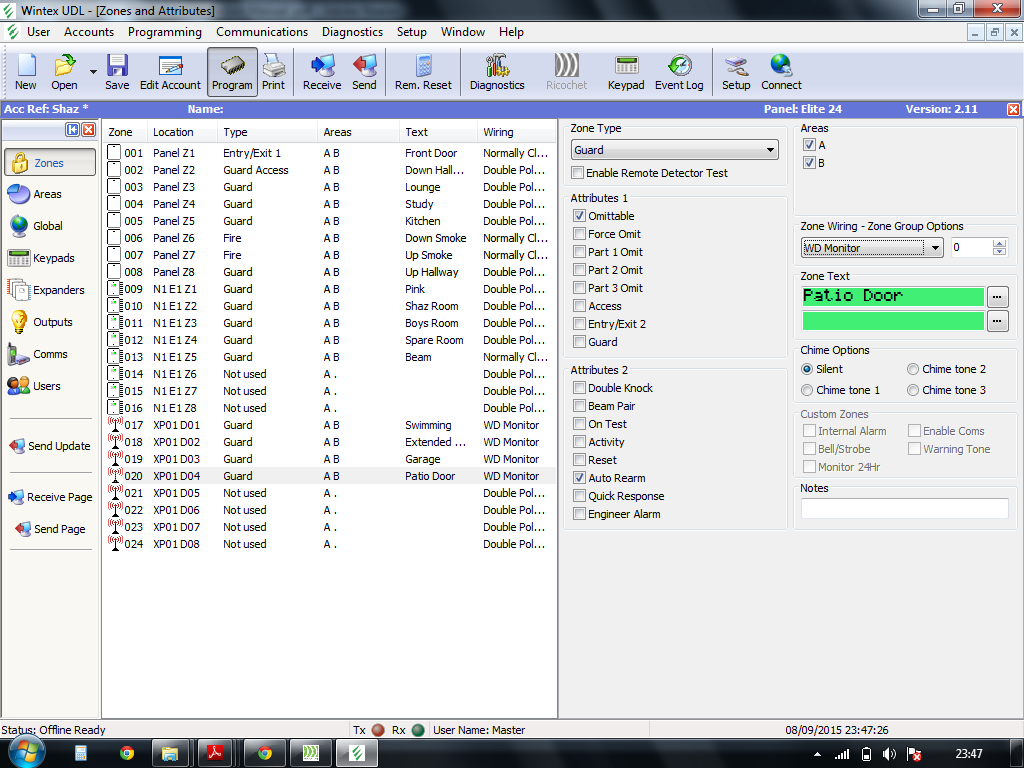

Here are pictures of wintex. Can someone take a look and let me know if zone setup is correct?

expander option switches 1 and 2 on press the learn button on the expander until the leds illuminate all the way across, turn option switches off.
go into zone setup zone 17 start the learn process, when the timer is on press rest, move on to the next zone until zone 24.
If you have any smart keys, go to users and do the learn process then press reset, for each user that did have a smart key.
you now should be able to learn on your wireless devices with no issues.
have you checked your keypads by pressing yes and menu on them to see what address the keypad thinks it is?
the keypad is either not wired correctly or is on an unsupported keypad address.
Brilliant, I will try that and report back. I didn't know about the A and B areas being on one zone not allowed. Is it correct the wiring method for the wireless detectors should be on WD Monitor?
Regards,
no, once learned on in right place just receive the profile, there is no wiring type for wireless!
