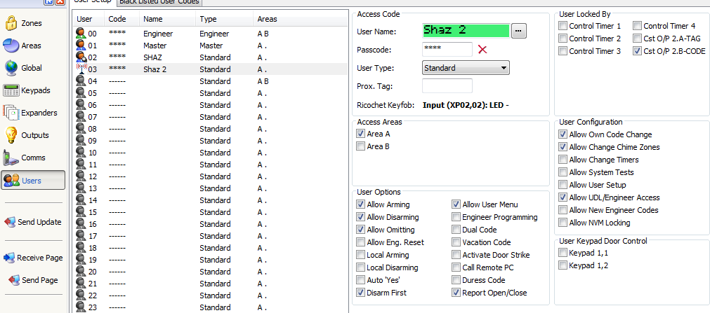

I added the Users picture from Wintex. Any idea why one of the users is shown as a wireless device instead of a person? Thats user 003
