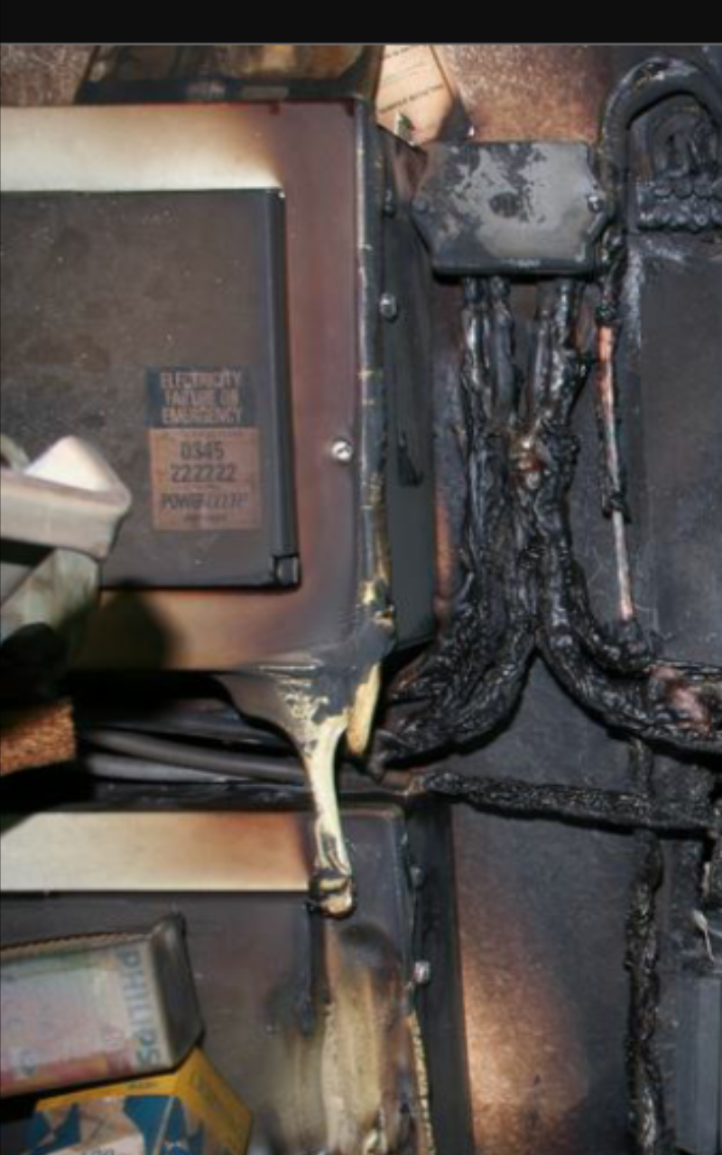

Called to a job as they could not get in as the roller shutter apeared to have no power.
No info what happened yet
full
full
From the photos it looks like the fire started at the cutout. Nasty situation, glad it didn't get much further.

assuming that the heat and smoke went upwards, it must have started somewhere low down. I can't see it.

No, some have a small ups, but most dont, had another this week where the main tripped in the night, shutter people had to force the door to get in, not sure how, it was all repaired when i got there.
Whats that thing cable tied to the meter
