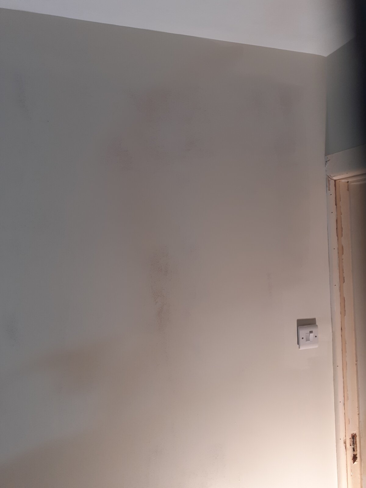

Rolling correctly and stains

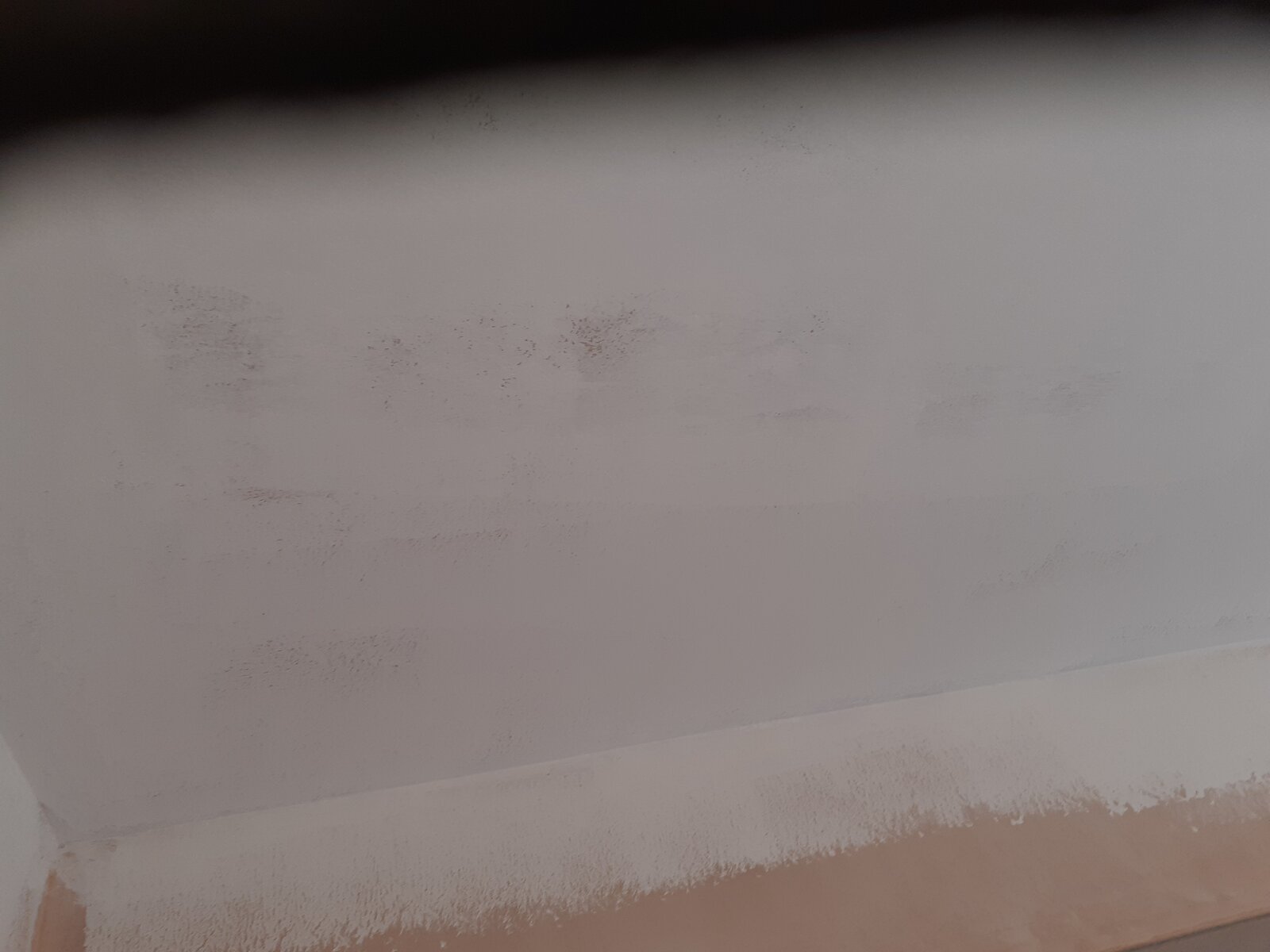

This is what I was worried about and I got a bloke at the Dulux Centre say it must be contract then vinyl over the top. I then called technical at dulux and Johnstone's and they all said it's fine to water down vinyl and use as a mist coat! Bit confusing but I'll go with technical. I guess dont go for complete coverage on first coat though I sort of have then touched up which is wrong and lazy on bare plaster. Always add water though

2 or 3 week old skim and all same colour.

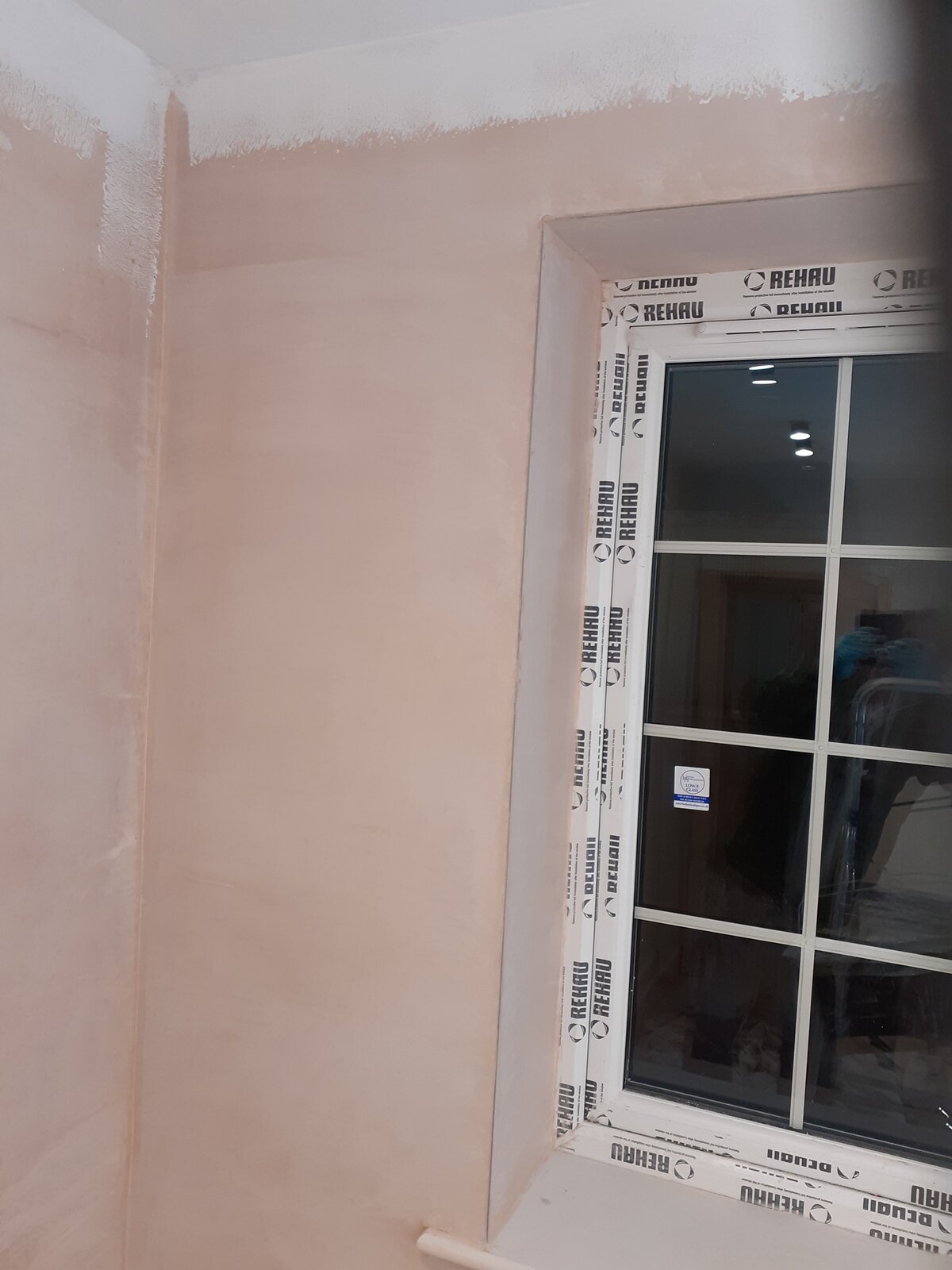

This is what my mist coat looks like in other picture a bit holey. I guess that'sright. I've watered it down
Mist it again.
Two mist coats. Ok.

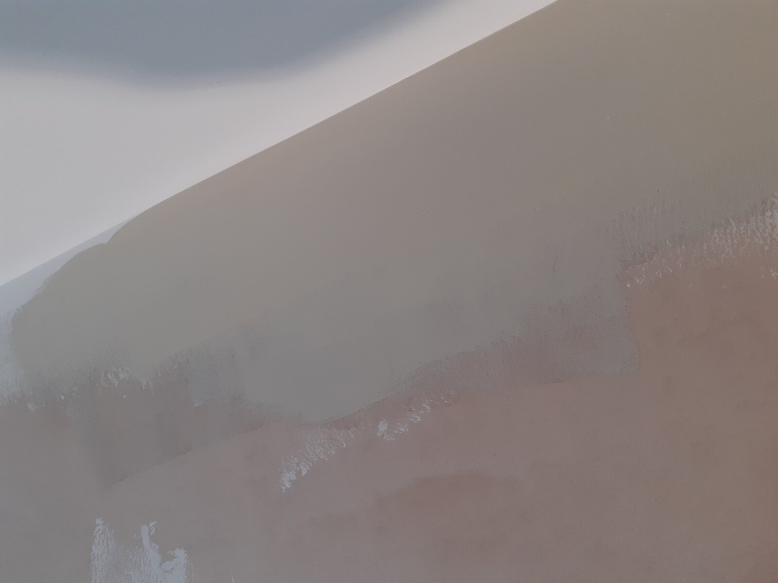

This is the watered down mist coat 20% water in vinyl. It's watery but covering almost completely. Is this ok? Shouldnt a mist coat be patchier?
have you misted the orange part? or just the top bit?
that's mostly OK, but there's a thin patch you can see. Redo that and brush it out well at the edges so there is no step.
