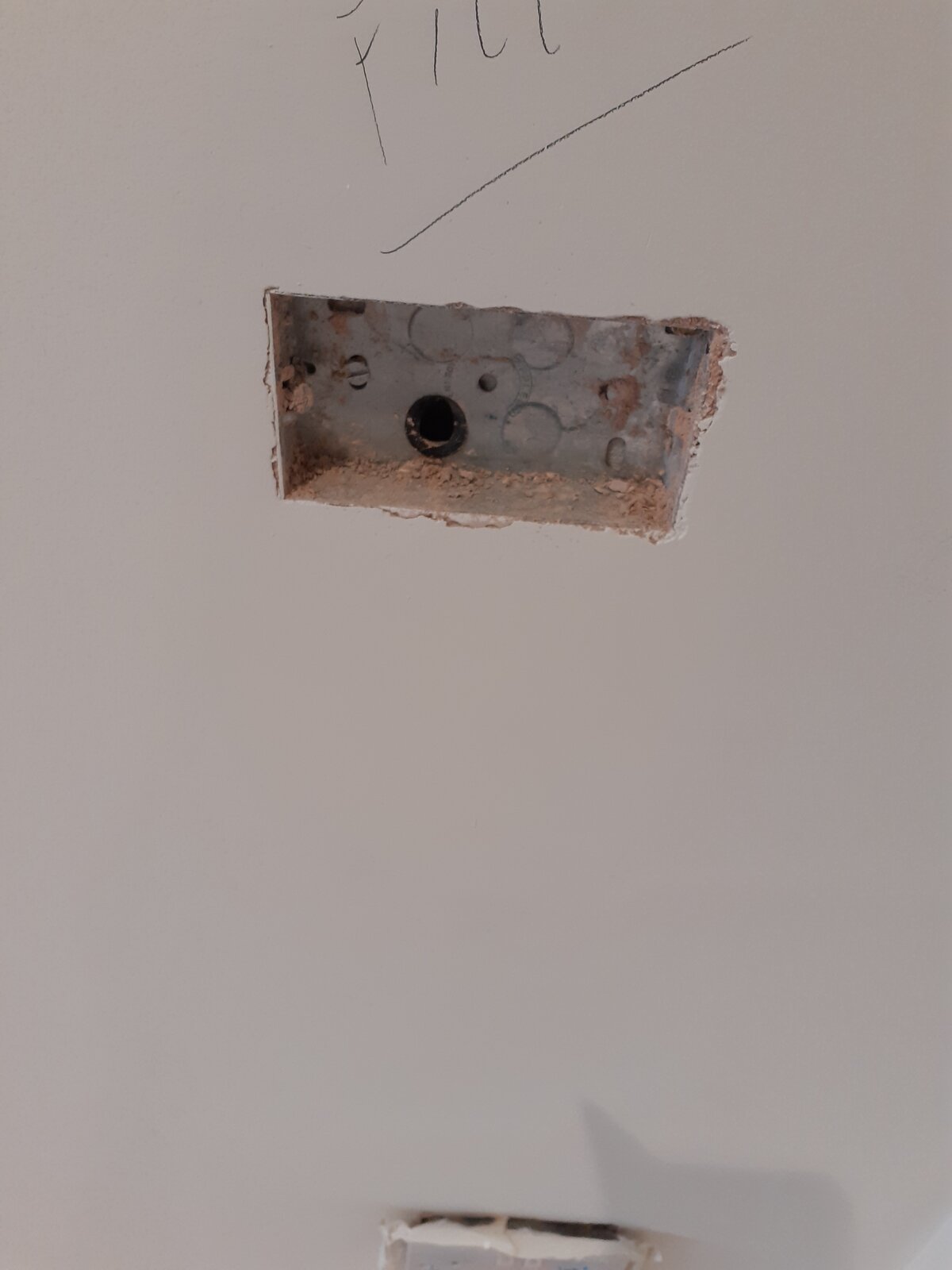

Also, what product would you use to fill this old socket casing?

As for the hole I would stick in a piece of wood slightly smaller and fill over the top, gently sand and then fill again, then sand even to wall.
Thanks. Fix the wood in with a screw I guess. Maybe use 600 wet/dry on final sand?

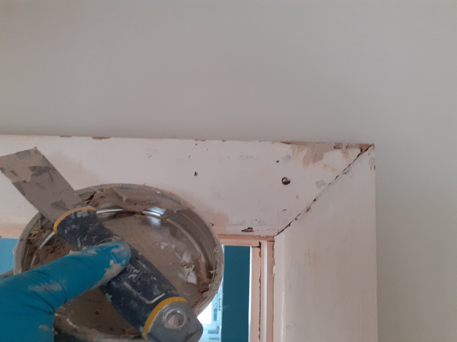

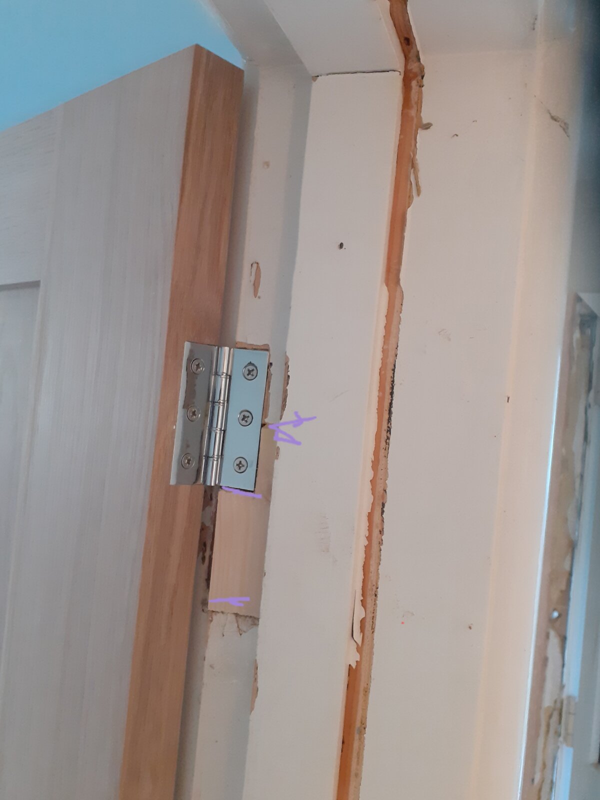

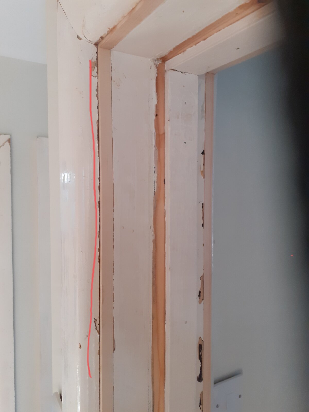

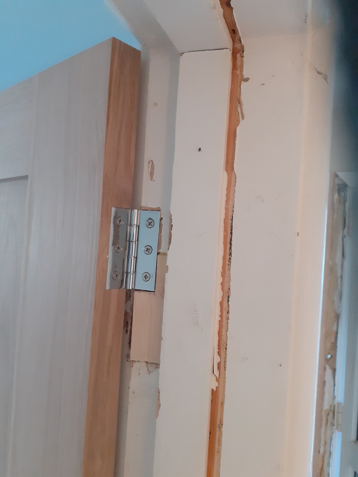

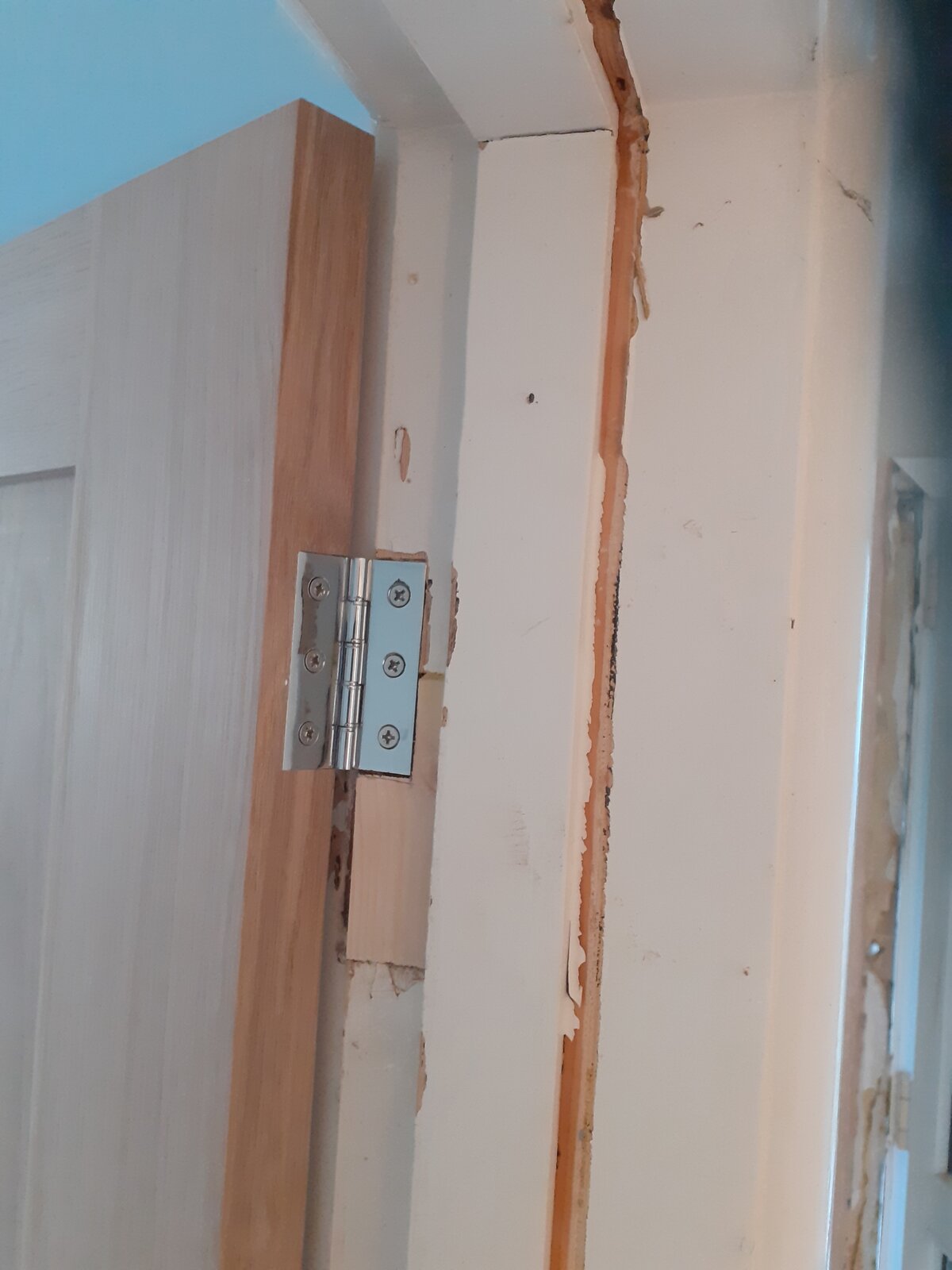

With this rubbish woodwork in photos I was gonna use 80 grit electric sander on skirting to get rid of stains etc. Regarding the doors shall I caulk or fill the small gaps between wood (red)? Sand out old paint on architraves with 120 grit electric sander feather into bare wood?
Hand sand curves. Dont think electric Sanders can do this
Fill gaps near hinge (purple)? Using two part filler

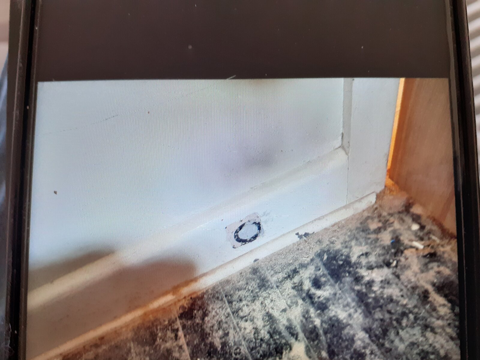

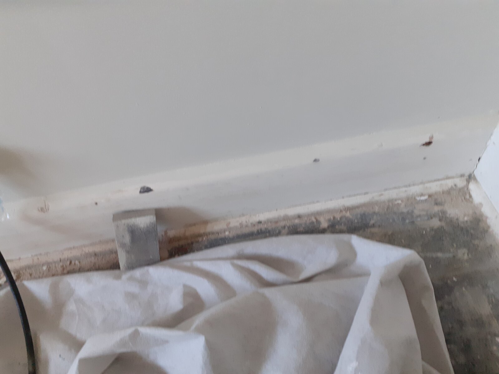

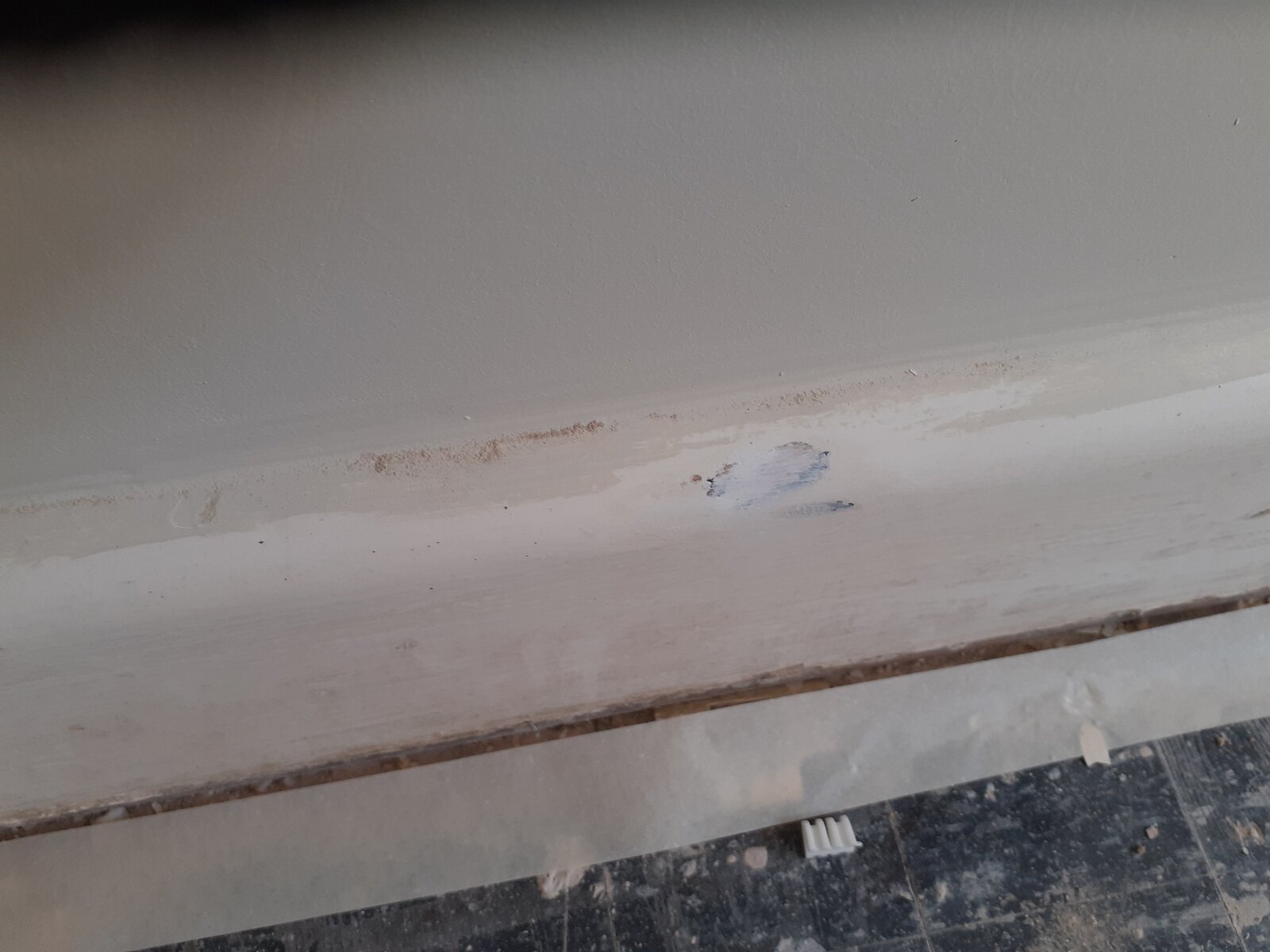

These chips in the rubbish skirting are an issue. I'm trying two ways- sanding them out to feather in and filling. I
guess after undercoat goes on I'll get an idea of how they'll look. With door - total nightmare, shall I hit the bits of wood with bits of paint already half on it with 80 grit electric square sander? To strip the paint off. Tryong to feather other bits into what's there with 120 grit electric sander? What do you think?
Or just heat gun the lot off?
Cutting in on skirting, would you freehand or tape it?

Fill it, fill it and then fill it some more! Just sand down with a block and sandpaper!
Is this what you mean fill then sand on the architraves?
I paint the emulsion down from wall onto skirting but noticed it bleeding through undercoat. Just gotta says out I guess with 80 grit
I'd use pollyfilla myself, much easier to sand. Pollyfilla and use your finger down the frames. You could even use caulk but you need to do all the sand able bits with pollyfilla first. Or a similar other branded product!
