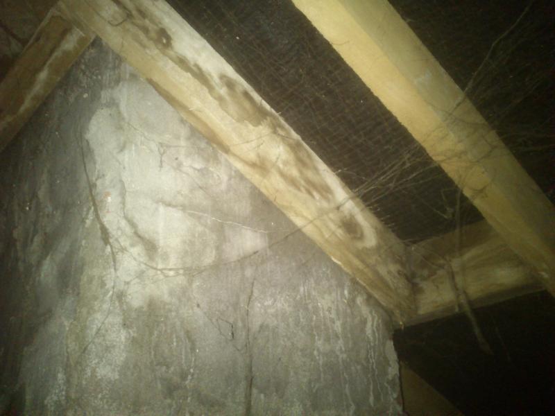

This shows the wood by the chimney stack. I've noticed some very very small leaks during the recent wild weather, with tiny amounts of water visible on the cement. It's trivial, but I'm wondering about the state of the wood? The stack isn't as wet as it looks!

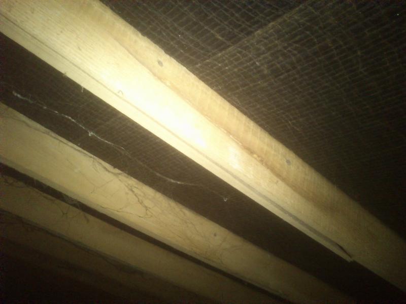

This shows a rafter I'm a bit concerned about. You can see a split in the wood, starting bottom-right and covers most of the visible length. The angle of the split is almost directly away from the camera, i.e. 45deg looking at cross-section. Also, you can see the dark centre-line, this is an area of wood that is dry, but seems soft and brittle, as if it's rotted or something, but seems stable now.

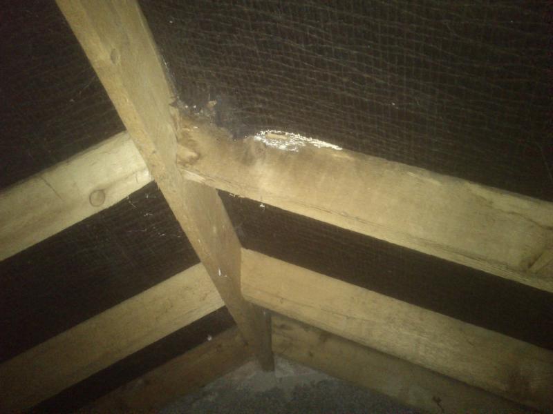

This photo shows a small hole in the felt, there appears to be a small amount of (white) wet rot on the top surface, it doesn't seem to have affected the wood any deeper, although the colouring of the wood is darker for about a metre or so, which makes me think the wood might have been damp at some point?

The staining is minor and seems to dry off, the white is just salts not rot. Also the timber does appear to be treated
The split rafter seems to tie in with a change of colour of the timber so may have split on installation or on drying out. Just screw some ply to each side or a new piece of 4x2 500mm past the split

What's the significance of the staining drying off? Is damage less likely to occur if this is the case?
