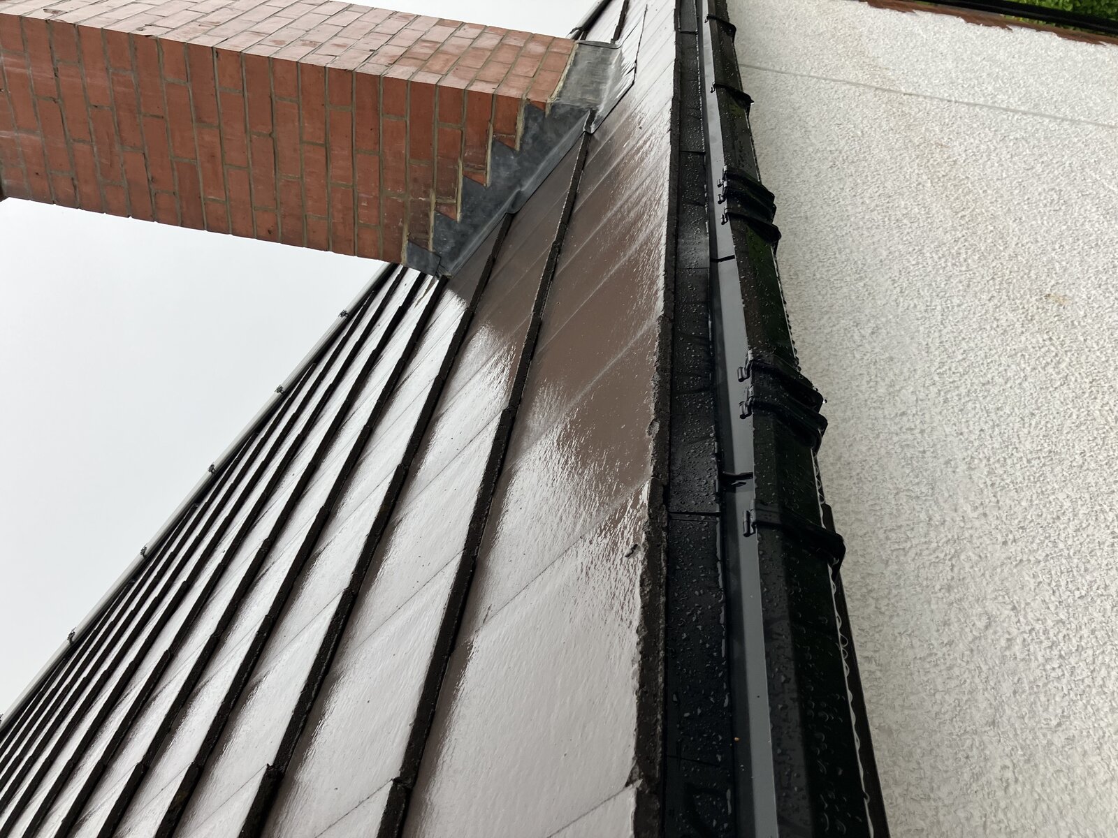

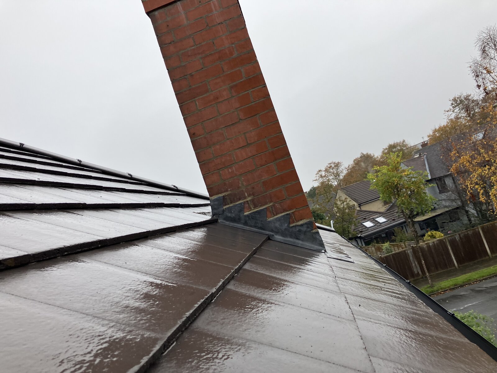

The development I've had is that:
* I've had another roofer round to look at the roof
* This new roofer wasn't able to help too much with the damp woodwork (they said they would need to erect scaffolding and take the hip and ridge tiles off to work out what was happening)
* But while he was here he said "what I can tell you though is that the flashing has been done wrong on the chimneys given the roof tile that's been used"

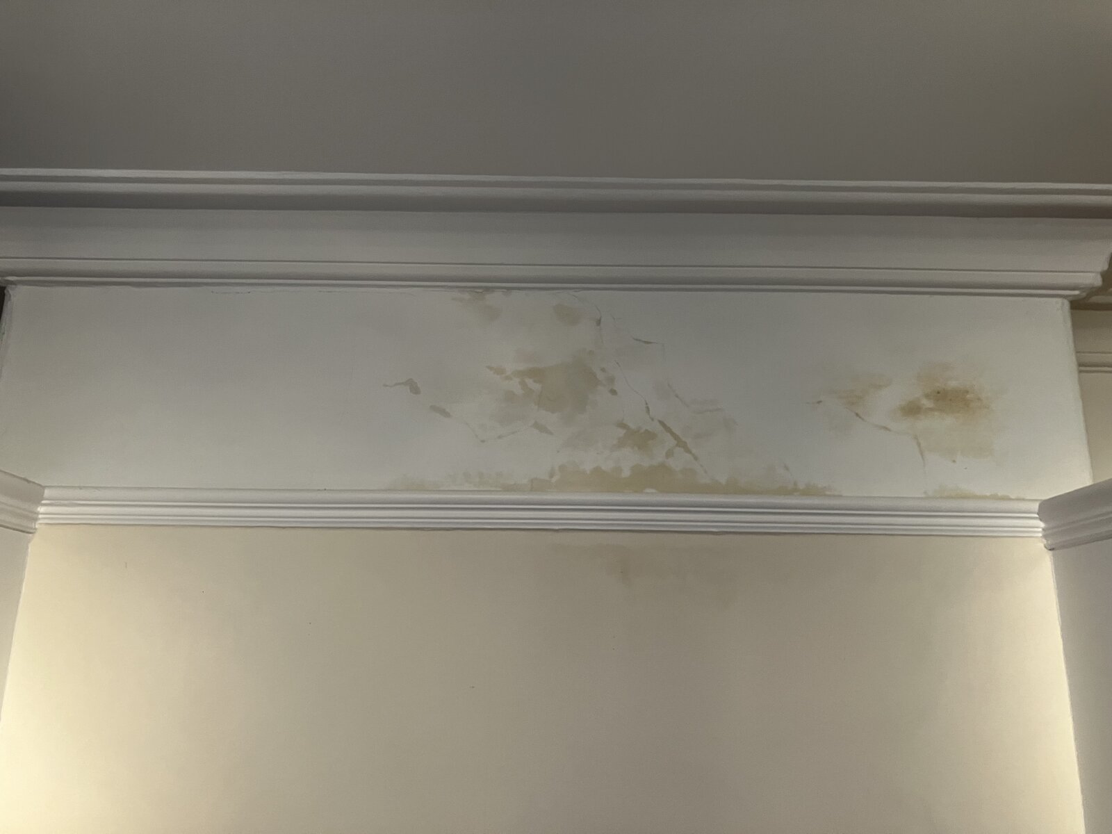

* I then took a photo of the flashing and sent it to the tile manufacturer, who agreed it hadn't been done right and said soakers needed adding as flat roof tiles have been used - I've attached photos of the flashing (see 1348 and 1349 below)
* Since then, we've had plenty of rain and we've had damp marks develop on the chimney breast in our bedroom - I've attached a photo of this (1490)
*I've also been in the loft during heavy rain and the chimney breast has been wet to touch - video here
* The roofer who did the original work came round today, peeled back the flashing and essentially said "there is no evidence of water getting beneath the flashing, the roof is all fine. Moist air must be entering the loft from the house then condensing on the chimney breast and running down into the bedroom beneath. You need to insulate the floor of the loft better and less moist air will get up there".
I'm feeling at a bit of a loss now. I'm struggling to believe that it is condensation given we've been told by two other parties that the flashing has been done incorrectly. The size of the staining and amount of water also seems high for condensation. Finally, we have a dry hip / ridge system, breathable membrane and vented eaves trays, so I would have thought there is enough ventilation up there to prevent significant amounts of condensation.
So this is just a broad plea for any advice really - any suggested next steps?! What would you do? Do you think it could be condensation?

Can you take a picture closer to the hip on the outside ?
I can see it's dry fix but I don't see hip trays .
Close up will tell all

He has now returned but he is saying that condensation is the cause of the problem and the roof is fine.
However, based on the amount of water I'm seeing on the bricks in the loft and the extent of the marks I've got on the chimney breast in our bedroom, I'm struggling to believe this (my post yesterday from 8.58pm had links to videos and some pictures).
In addition, I've only seen the chimney in the loft get wet during periods of heavy rain. I went up there yesterday morning (which was a very cold morning with no rain) and the chimney was dry to touch. If this was a condensation problem I would have expected it to be wet on a day like that as the bricks were very cold. So I'm really struggling to believe him.
