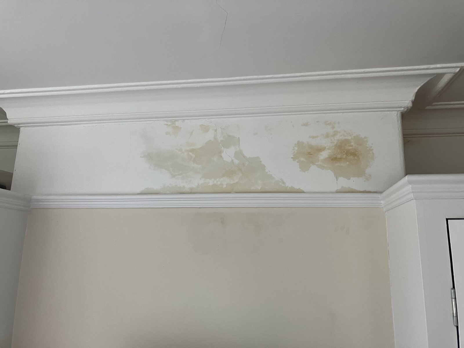

The chimney breast in our bedroom was dry prior to getting the new roof. The damp marks have only emerged since having the new roof. I should have mentioned that as part of reroofing he did rebuild the top few courses of the chimneys as they didn’t have drip courses previously.

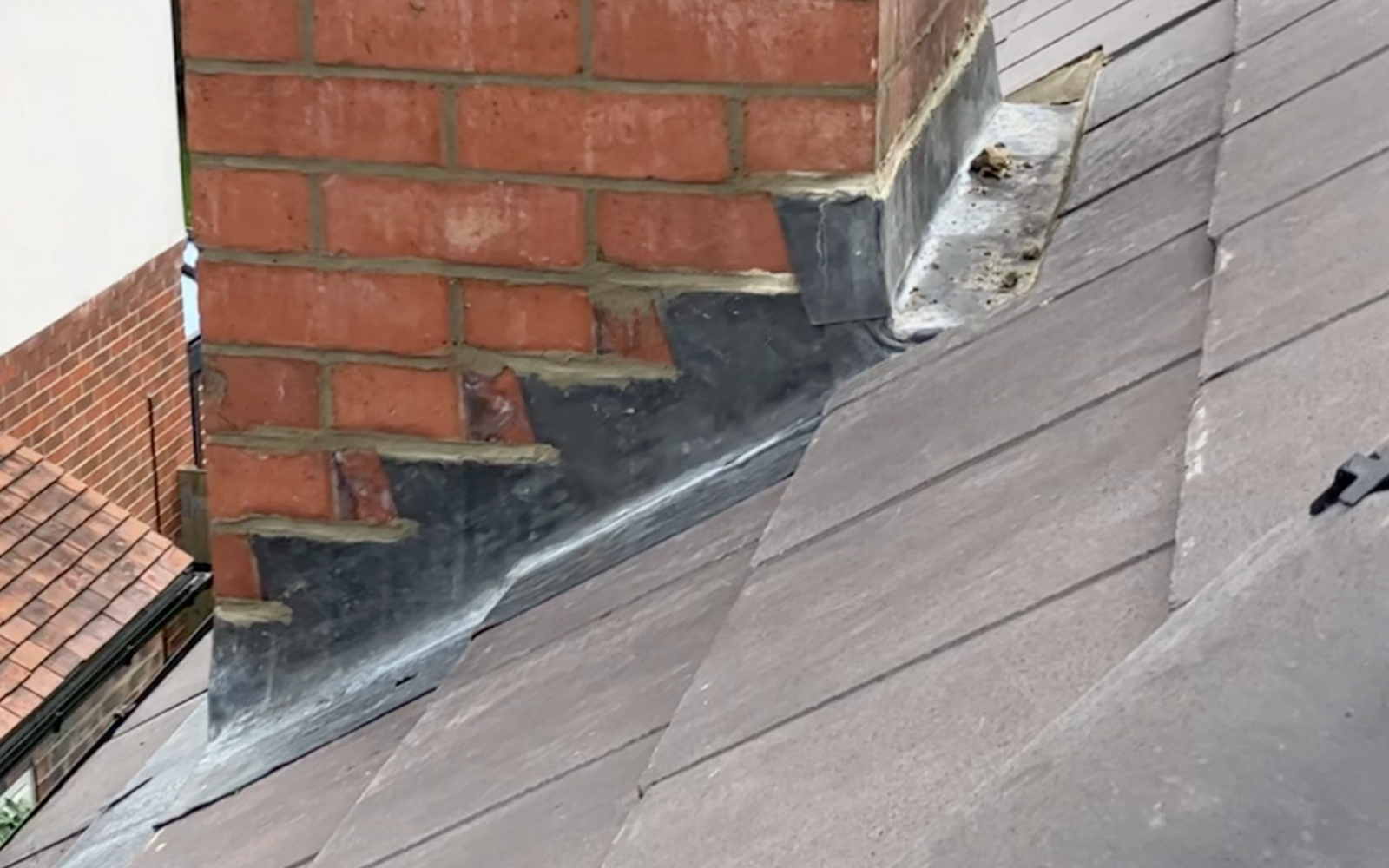

I suspect the damp in your chimney is due to the lead work especially the back gutter.

The further pics/vids don’t show the state if the back gutter, if that’s wrong it could explain the damp on the chimney breast. It might be worth getting an independent building survey, if it’s financially worthwhile given the 25% retention you hold

The damp marks on the chimney are getting worse by the day. Attached below is:
* A picture of the damp marks this morning

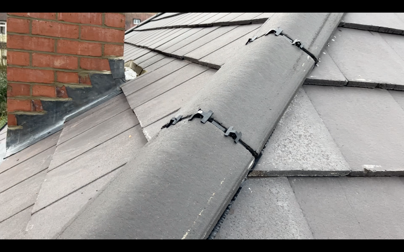

* Two pictures of the back gutter - hopefully these are helpful @blub @catlad
I've also taken a video of the back gutter that capture more aspect of the back gutter here. Apologies it's a bit wobbly - I was up a ladder with my phone sellotaped to the end of a pole!

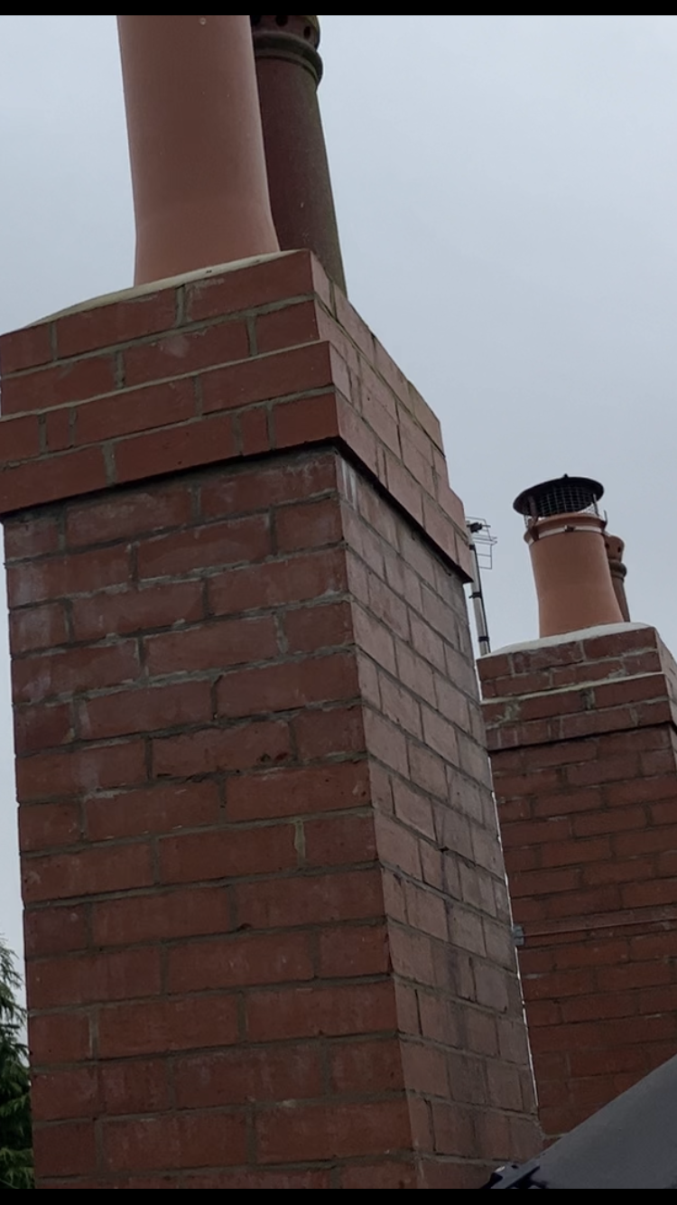

While I was up there I noticed that the pointing on the stack was darker in places and there were streaks on the chimney (as part of the re-roof the roofer re laid the top few courses of the chimney and repointed the entire thing). I'm not sure if this could be related to the issues? I've therefore also taken a video showing the full chimney stack here.

Should be left so water can drain out.
Thanks - are you referring to water that ends up between the membrane and the tiles?
I am wondering if water is getting in that space in our roof and that is causing both our problems - making the joists damp as it trickles along the membrane then hitting the cement at the chimney and going under the lead work.
It wrong! you know that, because you have problems you didn't have before.
Yep agreed I know it’s wrong.
I was just wondering where water needs to to be allowed to drain from… as I’m trying to work out if all the problems are linked and water is getting between the tiles and membrane and causing the damp joists and the wet chimney

One additional question: the roofer repointed the chimneys at the time of doing the roof. I’ve attached a picture of them below. What are people’s views on the pointing? Look ok? I ask because the different shades look a bit unusual to my untrained eye. Could this be a source of the problem? I don’t think the chimney was painted with storm dry when it was worked on. If I did this would it protect both the bricks and pointing?
