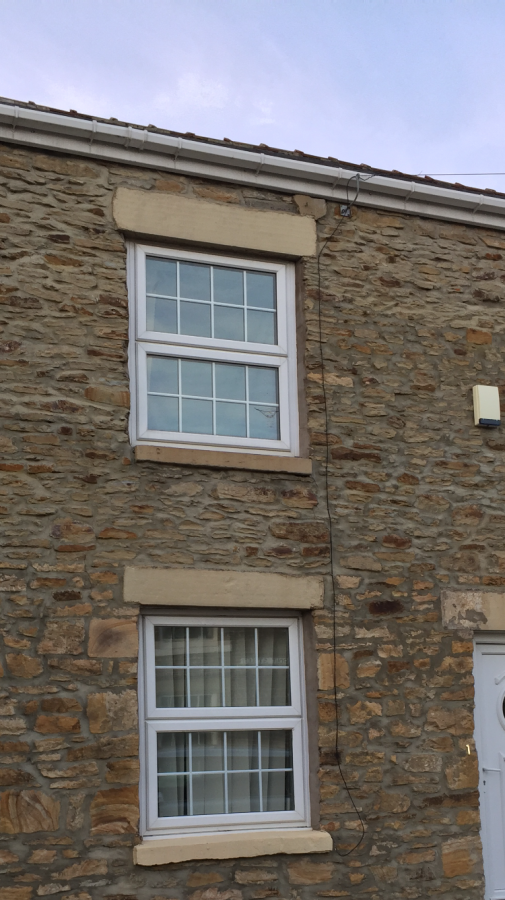

I'm having a serious problem with double decker busses passing approx 3 meters from the front door. I'd expect a certain amount of vibration but but as these tail of what I'm also getting is a horrendous jolt/ shudder coming from bedroom ceiling. Sounds like a loud creaking/ cracking sound. It's only recently when I've been in during the afternoon I have got to witness this and narrow it down to the ceiling/ roof.
Bernardgreen answered this in the loft forum with 'a pressure wave is the likely cause. Especially if there are no soffits fitted. The pressure wave would get into the attic space and cause a pressure differential between attic and bedroom and thus a downward deflection of the ceiling. If the eves of the roof are open then there would be nothing to stop the pressure wave getting into the attic.

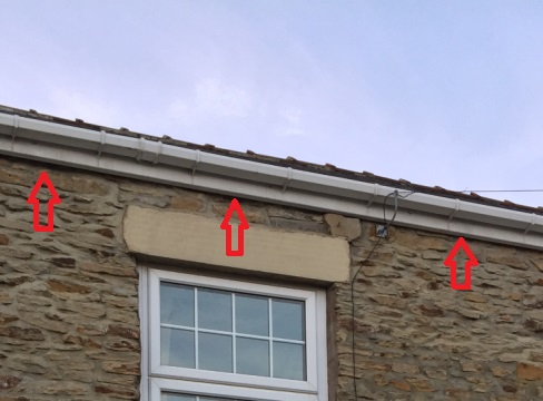

I have attached a picture of my roofline to see if anyone could possibly add to this and what steps I can take to prevent it. It's driving me to distraction to the point I'm now sleeping in the box room at the back of the house. The loft is uninsulated and not boarded. Would this make a huge difference?

Insulating your loft will benefit you in lots of ways. Noise absorption will be a major one, as will reduction in heat loss.
There appears to be a significant gap between the stone work and the facia. If it is a clear gap then a pressure wave ( or strong wind ) would get through it and into the loft space.
If there is no felt inder the tiles then that is another entry route for wind and/or pressure waves
Unless your bus company is using Typhoons as a bus, I am not conviced with the pressure wave from a bus theory.

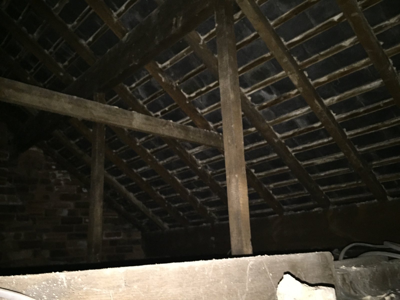

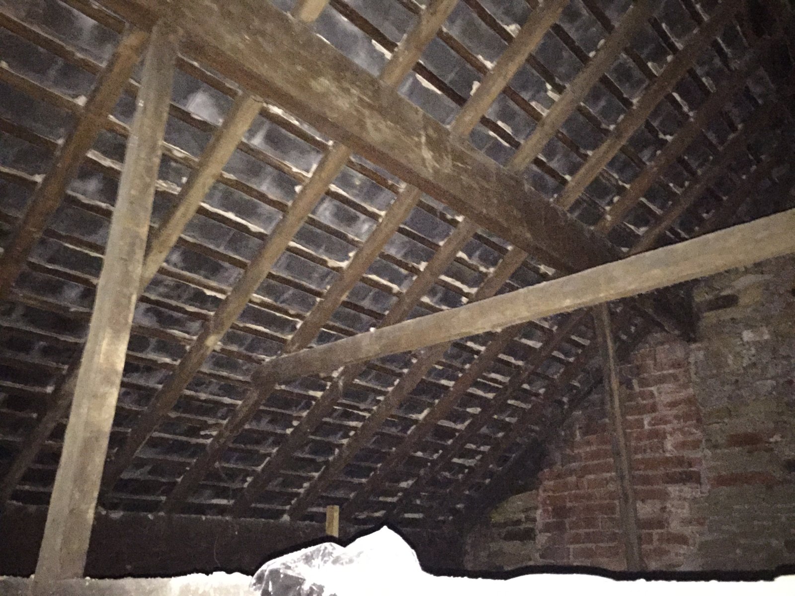

Race back from work but Sod's law had it I missed the last bus. Typical. Got some pics though and it did seem very windy up there. No sign of any movement but as I say didn't manage to catch any busses. Does it look like there is enough support for the rafters etc?

ok not an underlay issue... Slate roof with most of the torching still in place .
Rafters appear skinny but the purlin looks substantial .
wait for next bus
You've got no underfelt, so the loft should be pretty leaky in terms of air. This would imply very little resistance to air movement, so no choke points for any "pressure wave".
