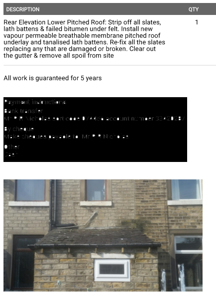

So I have decided to get the roof on the kitchen replaced / repaired. I have the following quote.
The roof is a pitched roof roughly 3m x 4m with blue/ grey slate.
Is this a fair quote?
Is that your ECG readout when you saw the price?
Or did the old sea dog send you the quote in Morse Code?

Sorry forgot to add the price. £650.00 - No that was the companys bank details. lol
sounds reasonable to me but there is no mention of renewing the flashing at the top abutment , if he is going to redress the old one make sure the lead is ok.
Thanks for that. This is my first quote. Also is it better to keep existing slates and replace the broken ones? The roofer said he doesnt like replacing slate roof with tiles as tiles are too heavy and let water in when its windy. Other people have had their roofs replaced with tiles so not sure whether to get another quote or just go with this one.
