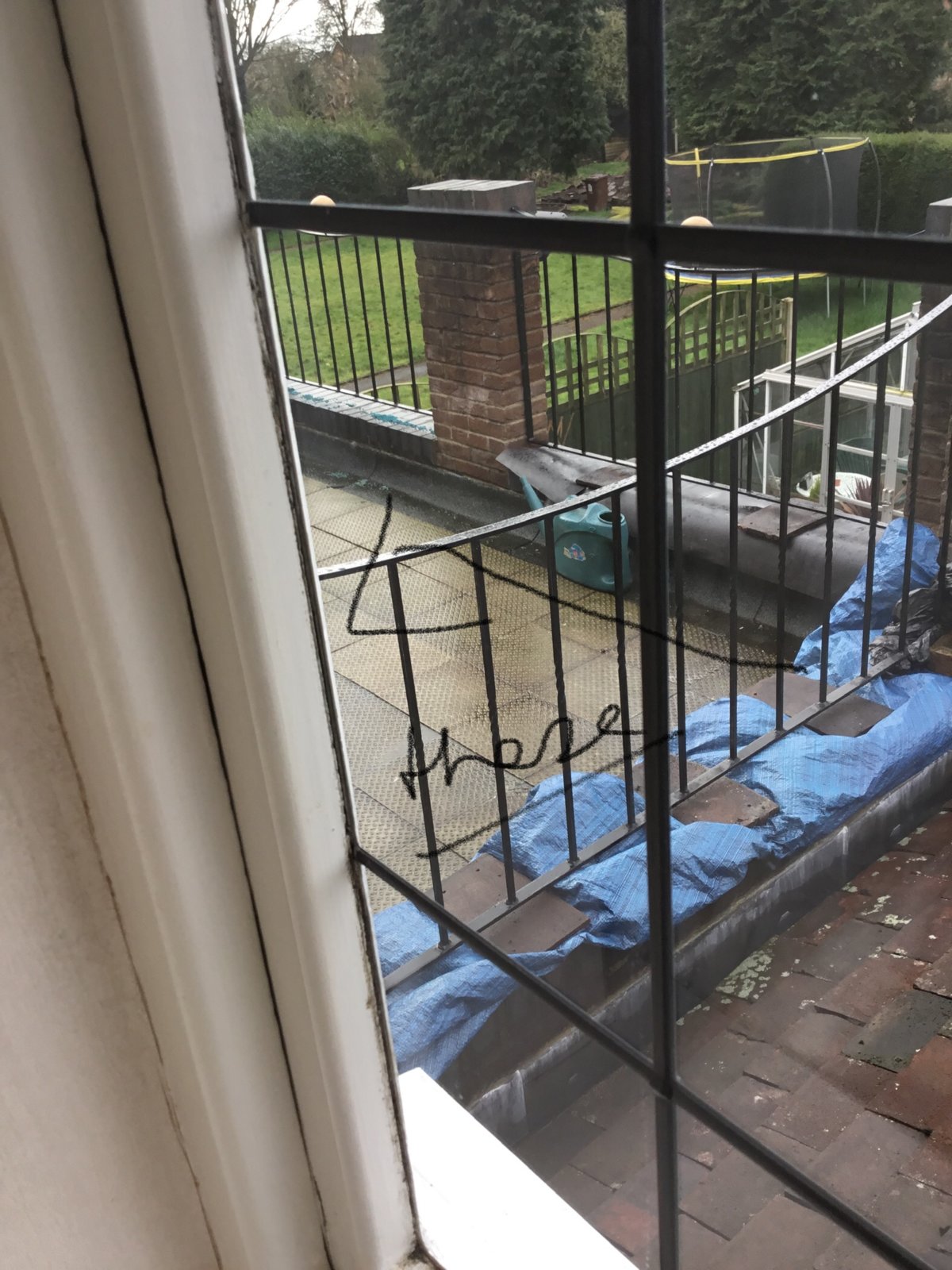

Am looking to potentially relay my balcony.
A roofer (checkatrade approved) sent a quote, but didnt mention tiles .
When i rang to ask him, he said we could keep the ones we have if we want and they would just ‘lay them back on top’
At the moment they are fixed down with black stuff (bitchumen?Glue or something?)
is it okay just to lay tiles down without adhesion? Just seems a bit odd.
ps. Am confused with the term ‘flashing’
I thought it was grey bendy stuff , but he also calls the material used for the upstands as flashing. Is that right?

Thanks for the reply. What are your thoughts regarding not securing the tiles please?
Bonkers.
Generically flashings refer to lead flashings used at abutments and where you can't bend a tile etc.
A flat roofer uses the term flashings when describing his felt upstands, drips etc.
Thanks Bonkers. Have you ever heard of just laying a promenade tile rather than glueing?
No. Flat roofers use a specific product for fixing balcony tiles. It's a foaming glue type product - messy but effective.
Noseall. Think my roofer is being lazy then as he says he will just lay them back on after re roofing and that they dont need to be stuck. I was suspicious, hence my question on here.
Whether tiles are fixed with adhesive or on pads will depend on the roof design, the covering material, the tile type and whether a drained surface is required.
Woody. Thanks they are promenade tiles, being laid on felt. All the water should go down a drain in the corner if thats what you mean?
They are these ones...
