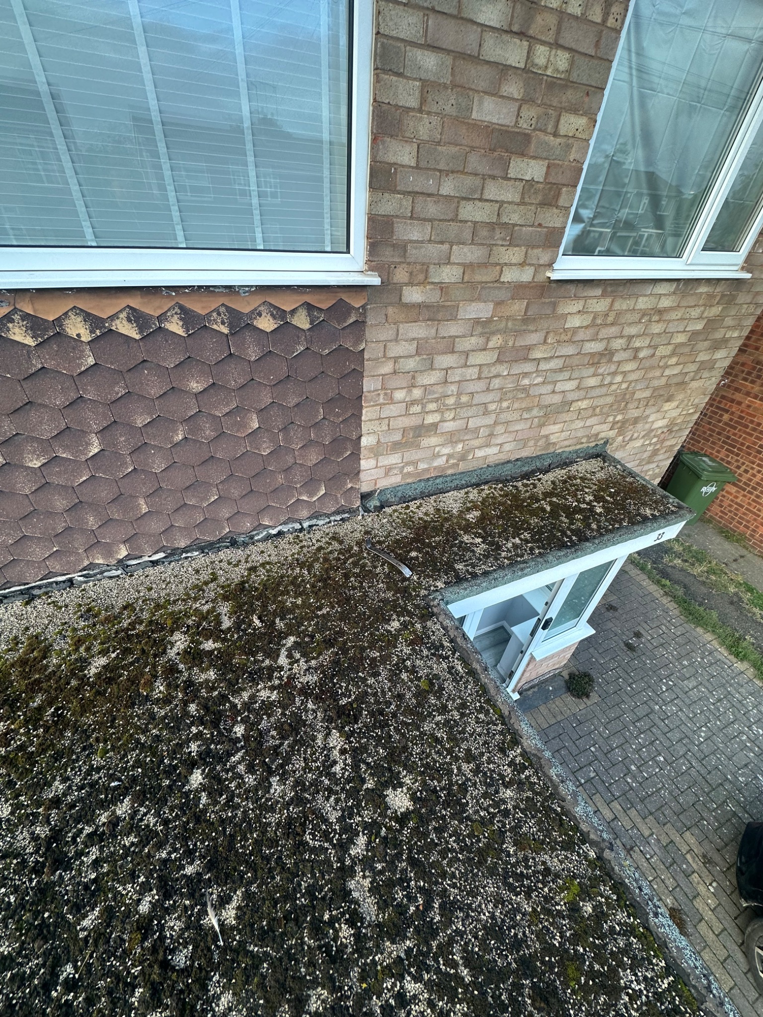

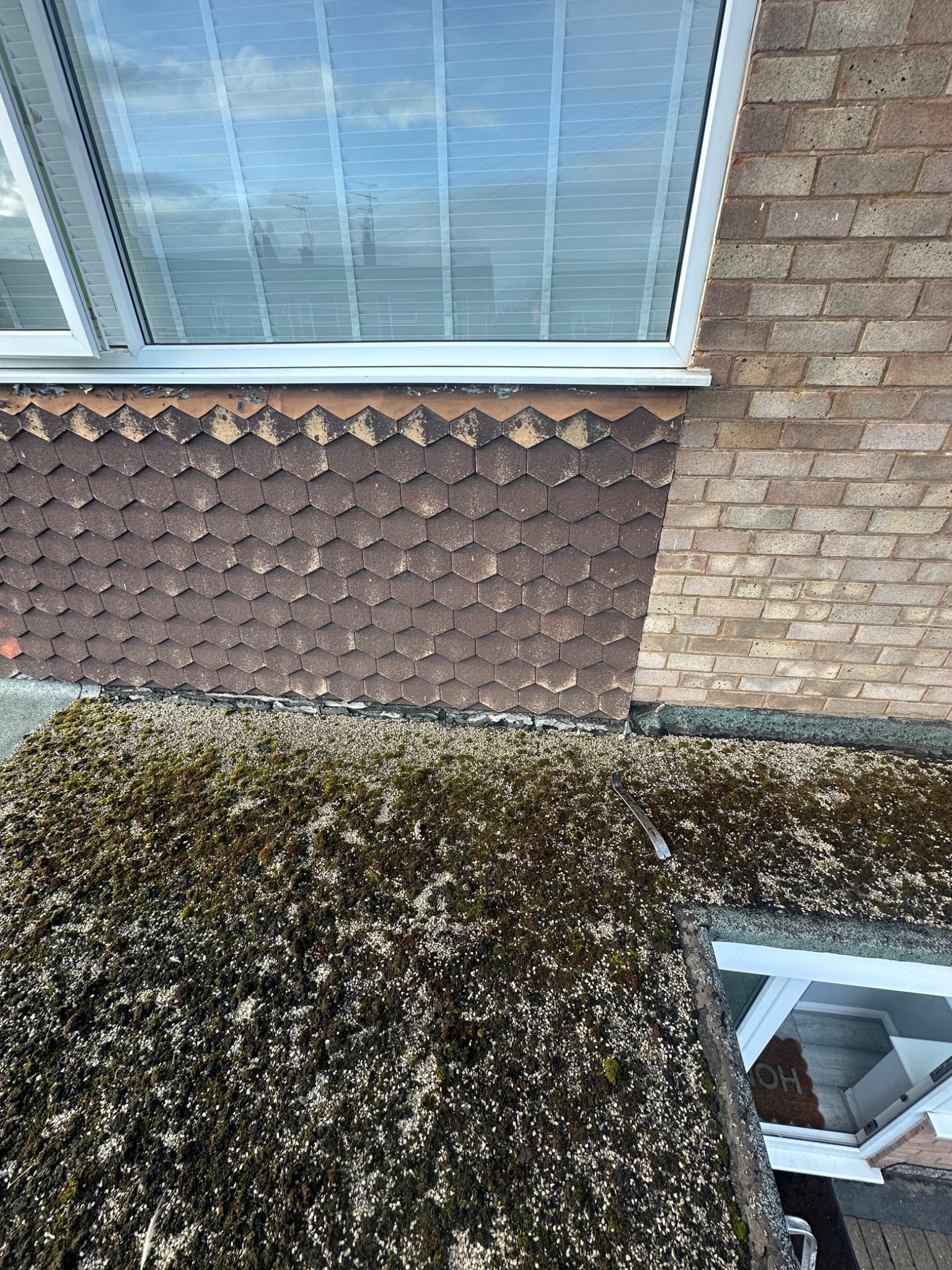

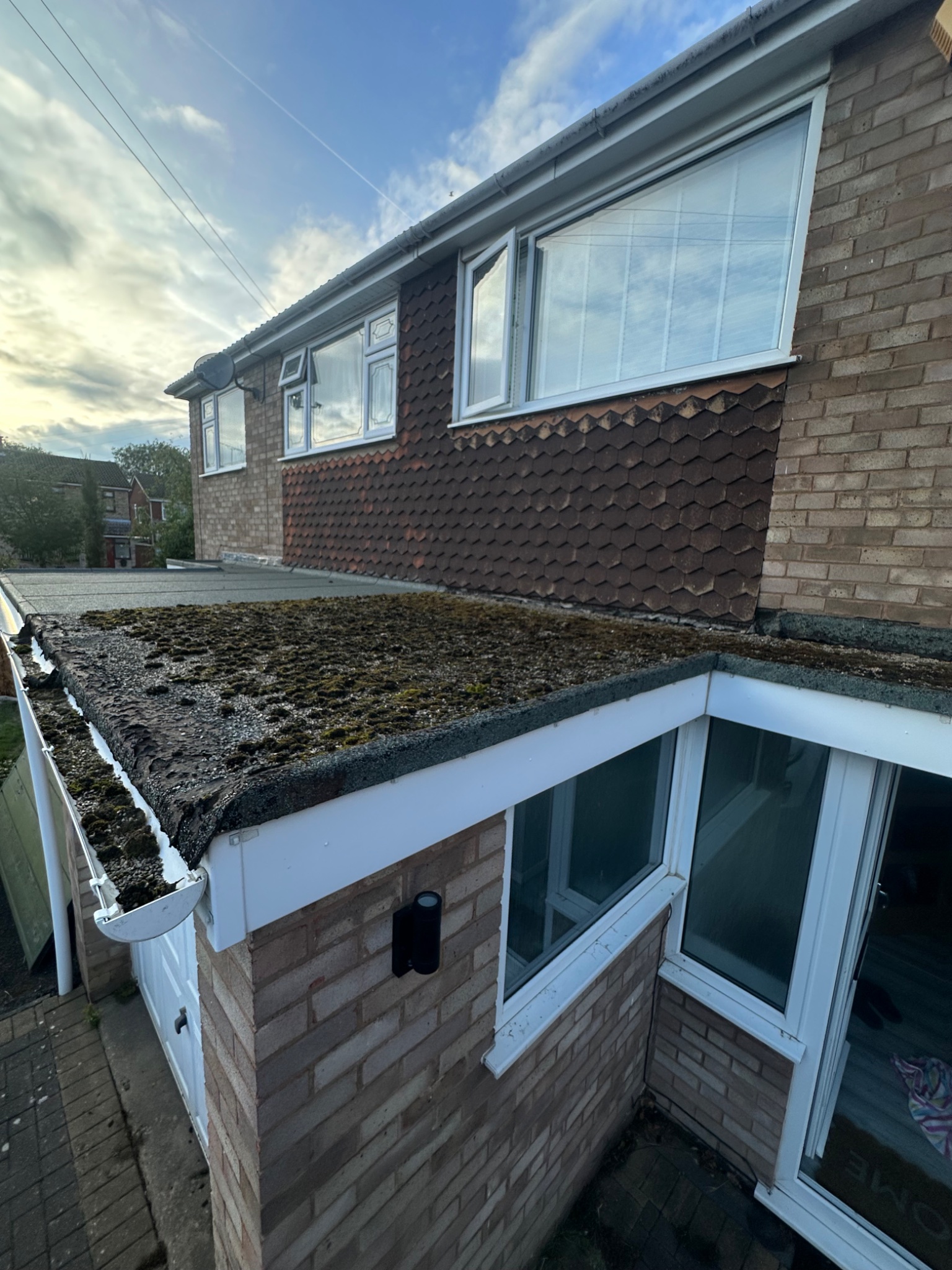

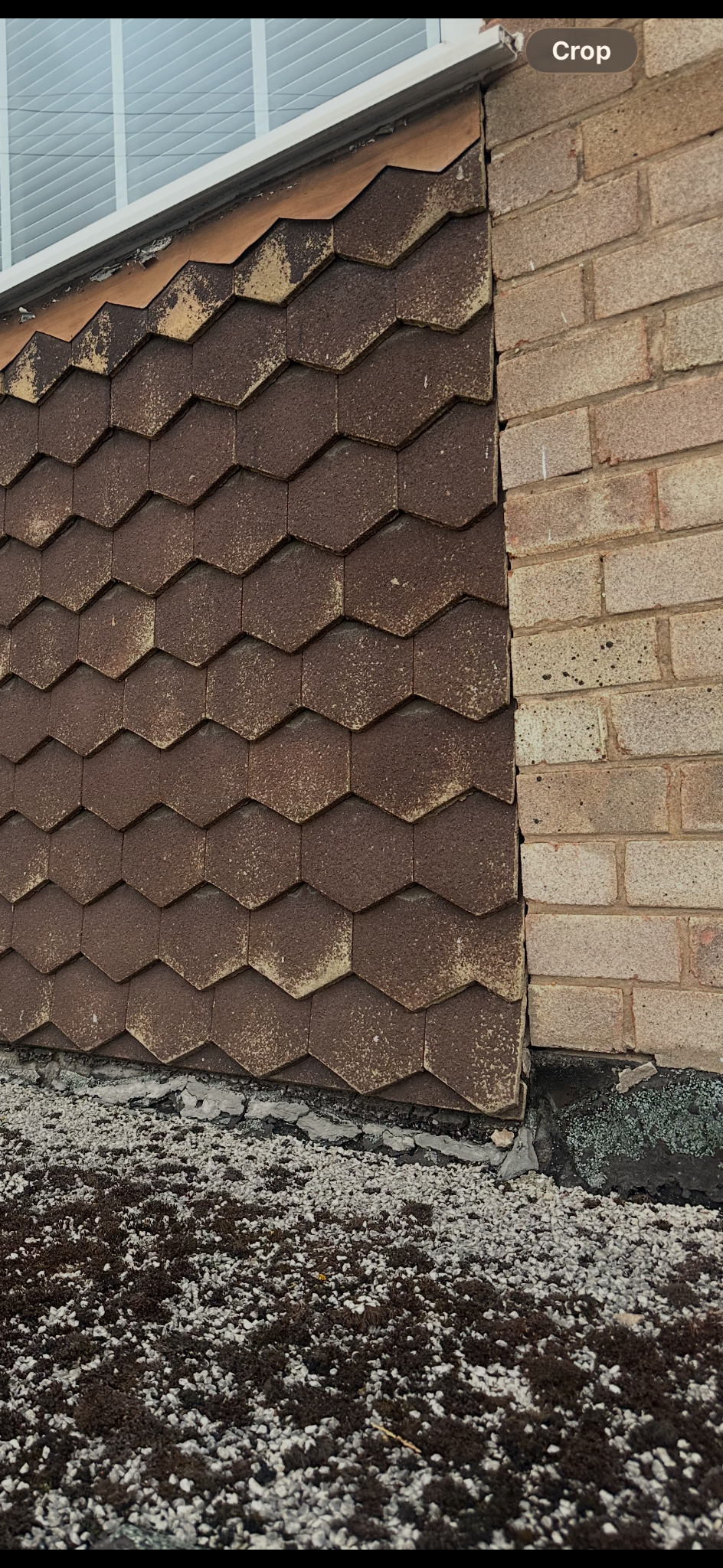

Hi everyone,
I’m replacing my garage flat roof (stripping the old felt, replacing the OSB decks, and installing a new EPDM rubber roof).
My main challenge is at the house junction: the exterior brickwork above the flat roof is covered with nailed-in wall tiles/cladding.
Is there a practical way to properly tuck and seal the EPDM membrane upstand into the wall without having to strip all the wall tiles off? (See attached photos for context).
Any advice on flashing details or workarounds here would be greatly appreciated!

Carefully take the first two (or three) rows off to access the upstand area.
When refitting, either leave the top row unnailed, or use a small spot of no- nails adhesive on the back to hold them.
Thank you. They are all nailed all the way to the top so it’s hard to get the bottom ones off without breaking them. Is there anyway to remove the bottom ones without having to remove them all?
You have to carefully twist them off.
Thanks, so if I lift and pull the bottomed tiles and twist side to side the nails should come out with the tiles?
You need to be patient and careful with jigging the tiles or using a flat bar to lever the nails - especially when pressing a bar on the tile.
If the nails are being difficult, use a hacksaw blade to cut the heads off the first two nails, get the tile out and then you can get to the sides of the adjacent tiles.
When refixing, screws may be better as there is less banging and less risk of tile breakage. Don't over tighten.
