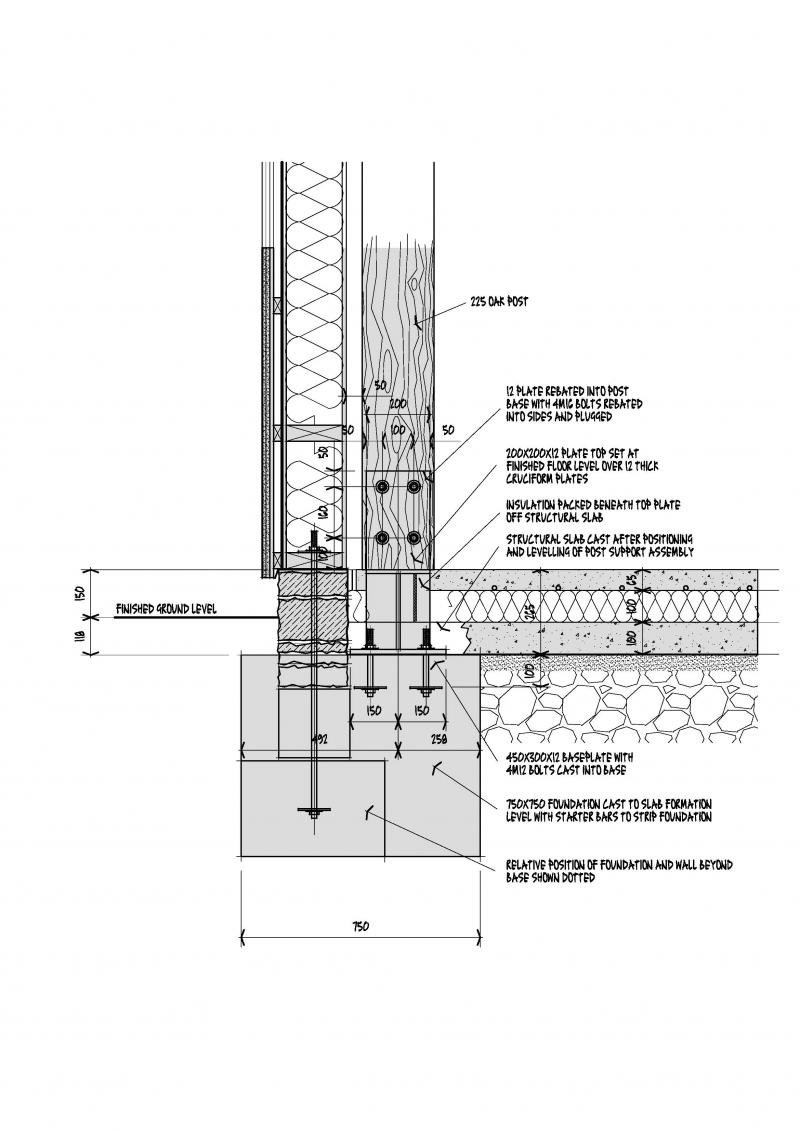

One of the things that gives drawings - CAD or hand - a bit of lift, a bit of pazzaz is using differing line thicknesses and shading. These are some AutoCAD prelims I did for a job, before I discovered the joys of GSU:
I don't like AutoCAD and CAD progs generally as they are too "exact", which is why I try and mess around within them to make them more sketchy, more like how I used to do them by hand.
