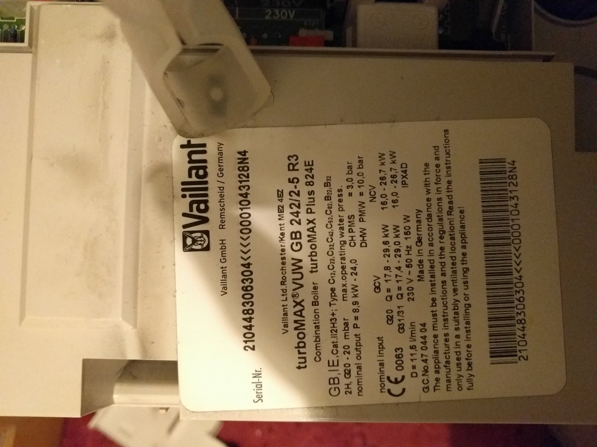

Hi guys my first post on this forum hope i get prompt reply and help from diy experts.i have turbomax vuw plus 824e boiler fitted in my new house.there is no timer or room temp. Controller can u guys pkease advise me which controller is compatible with this boiler and installation instructions aswell please!
I have attached pics of my boiler so u can give me help with this thanks

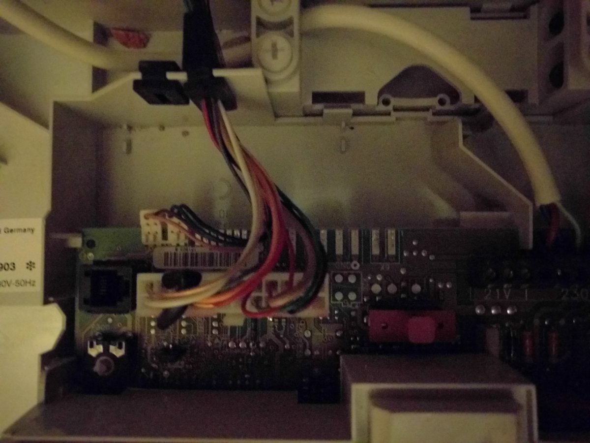

Nothing wrong with DIYing this as there is no access needed to combustion chamber and no ill effects of connecting to the PCB as there will be no adjustments made to gas critical components.
@Sahib consider a wireless programmable room stat for easy, quickness and tidyness if installation. Something along the lines of a Honeywell DT92E will do the trick although cheaper alternatives are available (Plumb Centre do a rebadged version of this same stat)
Place the room stat wherever you like preferably in the most used room and the TRV in this room (if fitted) will need to be disabled.
Place receiver near the boiler and wire mains power to the receiver from the switched spur and then wire the receiver (connections A and B) to the boiler (connections 3 and 4 on the terminal strip on the PCB there will be an existing link across 3 and 4 already and this needs to be removed) A to 3 and B to 4.
Power up, set your program and you are away. Should take all of 45 minutes.

You can find installation instructions for your boiler here. You will find the wiring instructions on pages 32 to 36. All of the information is there to enable someone competent to add a thermostat / programmer etc., If you are not able to understand it, then this task is probably outside of your ability and should be left to a professional. On the other hand, if all is clear go ahead, you have everything you need there.

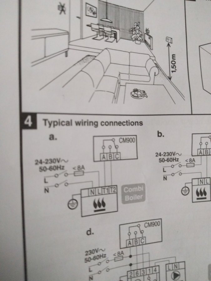

Please guide me once more l have got honeywell 900 and its just got thermostat control its not rf controller.
In the manual it says a and b switch connection that i understand but here it shows that u need to connect A to C in honey well......am i right or just confused......and please tell me i can see only 2 core wire is going to be used with blue and brown color is brown going yo be inserted in A. Or it dont matter
