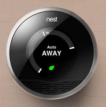

Is this the room thermostat of the future?
http://www.nest.com
A learning thermostat that requires no programming, it remembers your habbits and makes the changes as required..
it's features include:
  • 1) A simple, intuitive interface
    2) Apple'esk design / look about it
    3) WiFi / Smartphone / Internet access
    4) Weather Compensation via weather forcasts from the Internet! :cool:
    .. plus many more cool features not seen on UK room stats!
... As it's not a UK product (yet), it does have some bits missing such as modulating flow temperature and variation to wiring... (which wouldn't be difficult to change for a UK version, should one become available...
It does have many of the features I've mentioned were important to me in another thread... What do you guys think of this as a product/design? (assuming there was a UK version)

It says "Weather aware - Nest uses its Wi-Fi connection to keep an eye on current weather conditions and forecasts so it can understand how the outside temperature affects your energy use."
Perhaps not "weather compensation" as we know it in the UK, however, with the addition of modulating flow control the "weather aware" bits could simulate an outside sensor, it wouldn't take much to change the software for a UK version!? (which is updatable via WiFi!!! :cool: )
I guess some of the features could be called gimmicks, I would call them "useful gimmicks" that make it stand out from the crowd... :)
