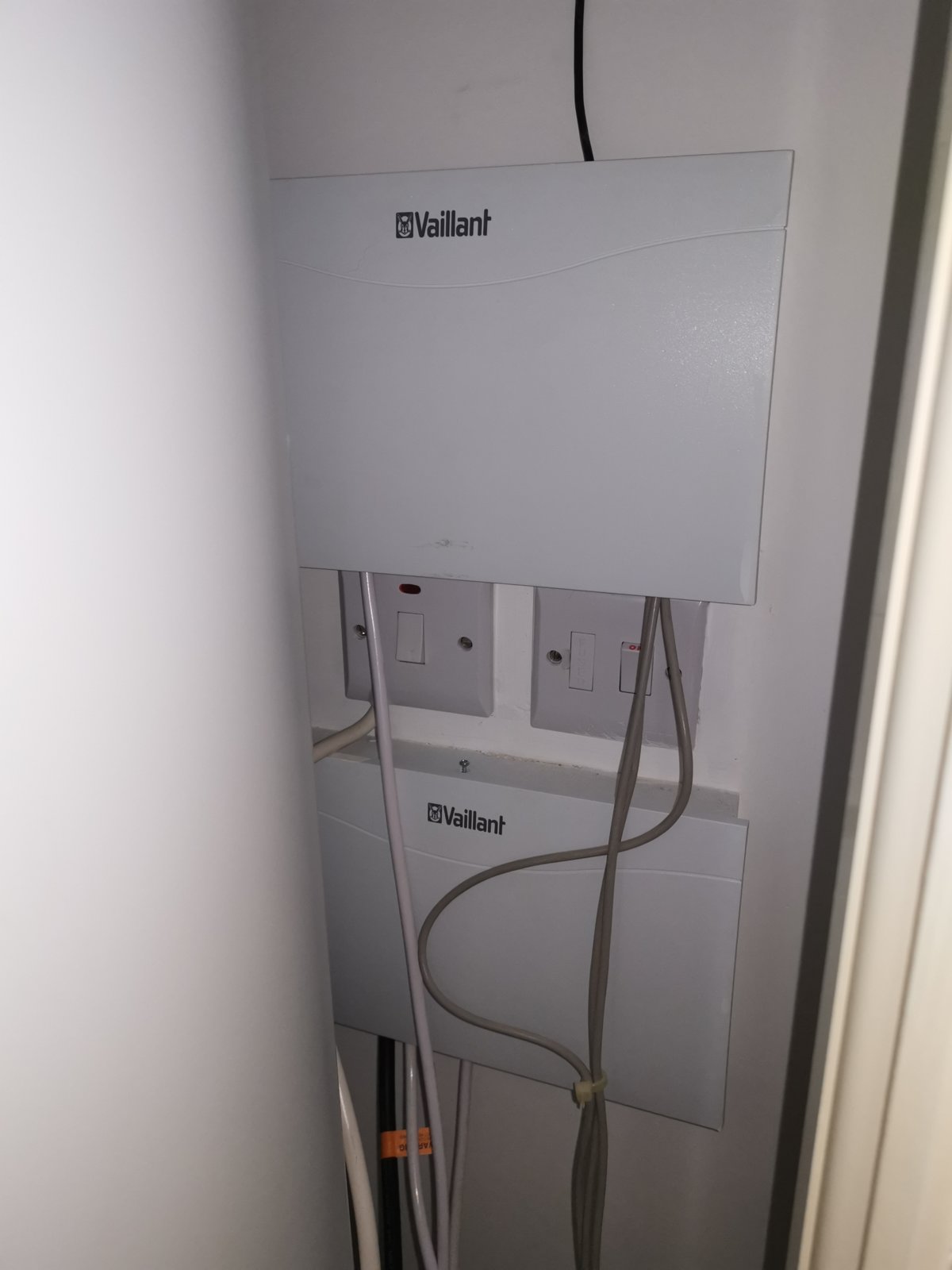

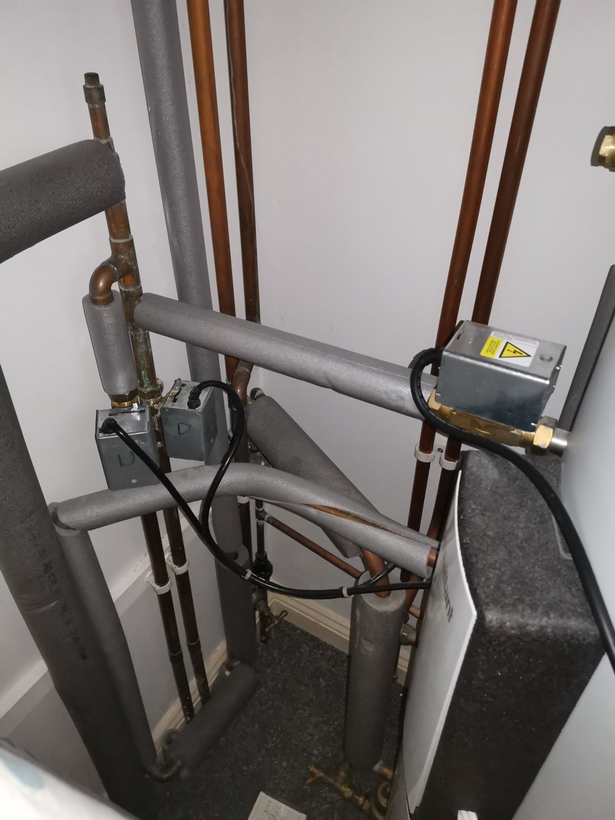

Hi Scottish gas man,
Many thanks for the reply it's much appreciated. See photos attached of the two control panels located in the cylinder room and the pipes/valves connected.
1) yes small vaillant thermostat in main bedroom believe it is the vr81. Just checked and as you said was on A1 not A2 so adjusted this. On the same screen it had temperature setting? Should I adjust this? Or is this just to configure the thermostat if it seems out by a degree or two? Now the thermostat isn't changing the main desired temp on the vrc470 so all good.
