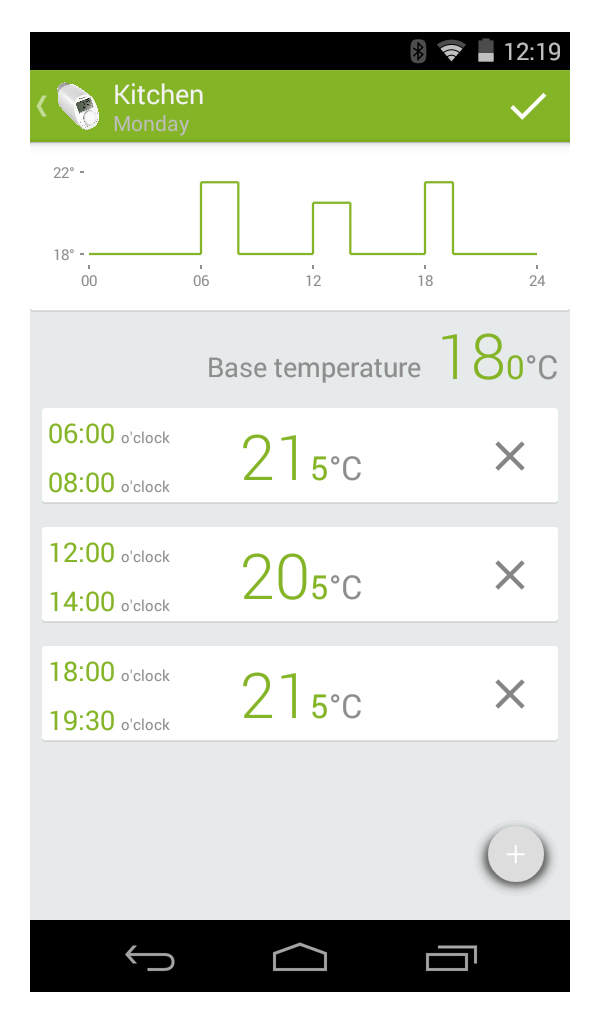

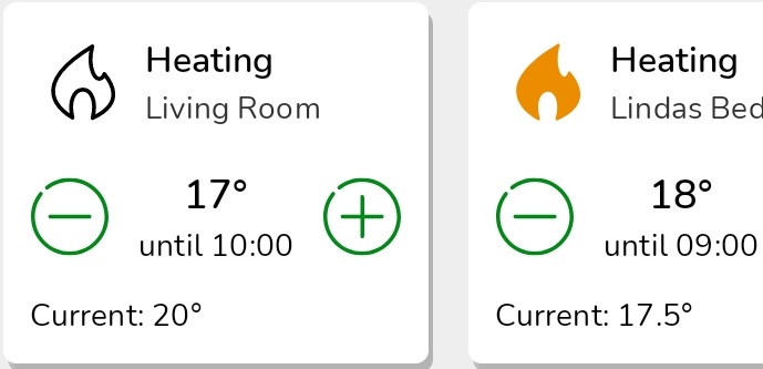

..............The Wiser TRV head is claimed to work out how long it takes to heat a room, so set to 20°C at 8 am, and it works out when it needs to start heating the room..............
This only happens if "comfort mode" is turned on. IME it doesnt work very well if the room temperature drops more than a couple of degrees below the next set temperature.
