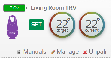

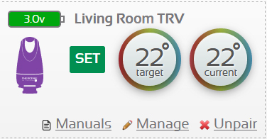

The setting of the lock shield is often critical, so looking at the TRV software, TRV_report.jpg easy, if the current exceeds target, unless caused by sun etc. Then the lock shield valve needs closing a tad. With a non-electronic, however, hard to work out which needs adjusting, TRV or lock shield valve.
