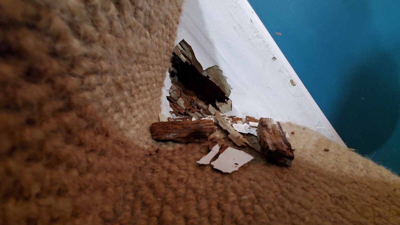

Forget filler - it has absolutely no structural strength. Should only be used for aesthetic repairs
You can't easily replace a string, reusing the existing treads, risers and wedges, either.
If this is a straight, simple stair I think the best (and least complicated) option would be to replace the entire stair, re-using the existing newels, spindles, handrails, etc as appropriate.
Failing that it may be possible to remove the bottom section of the stair, say the bottom 3 to 5 steps, and make up and splice in a new section. The difficulty is going to be getting an exact matching section made up as the old stairs aren't going to be made from any sort of standard section. In addition the join between the two sections always be noticeable, and the additional work which may be necessary to support the remaining section of old stair could end up being very intrusive, depending on whethervthe underdrawings could be seen
Personally I'd replace the stair; I'd walk away from thevsplice approach unless it was a listed building as it will be a lot more awkward

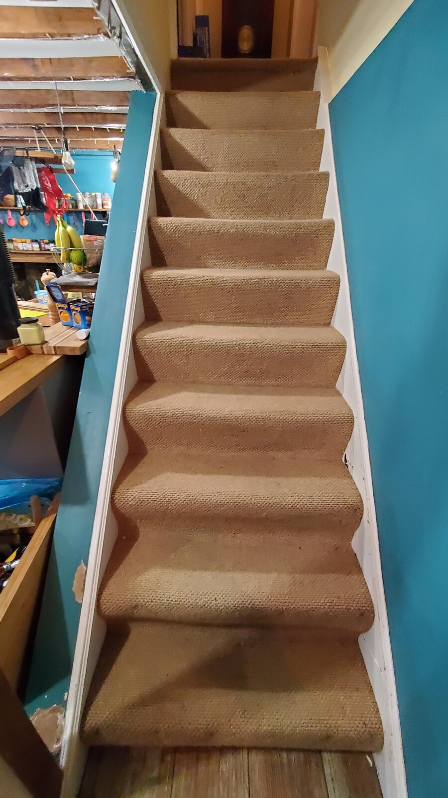

The bottom few stairs are above a void between two walls so would not be visible.
The stairs have no handrails or newals etc ( see pic)
My wife hates the fact we have carpet(with muddy dog) so would probably be very happy with a whole new staircase that could be stained and varnished.
I have had a poke in the hole and you can see the attached pic. thats the worse bit and the stair above and below are less affected.

Having seen the photos now I think I'd just rip out and replace. It won't be any more work.
