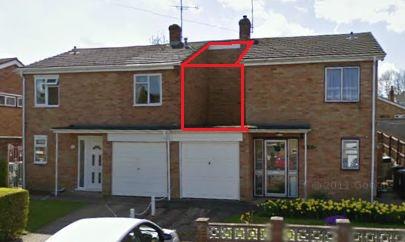

we are considering moving home and i'm after some sort of rough indication of an extension cost over a garage.
the overall size would be 4.3m x 2.5m and assume existing foundations are all ok as others have done without any ripping down garages etc and starting again.
use would be a dressing room and ensuite bathroom, with a cut through from the rear bedroom
i've tried to attach an image here, hopefully it works! thanks
Looks like the neighbours have had same job done. Have you spoken to them about it? How much? Builder recommendations etc. ?
Haven't knocked to ask, didnt want to seem rude as I dont even own the property yet! I was hoping in the region of 5-7k? (excluding decoration) seems fairly simple to me but i'm no builder - 1 wall cut into neighbours, insulation, flooring and a small section of roof? plumbing and electrics - or is it not this simple?

It looks better after the extension than before it.
True, but try to imagine what it will look like when both houses have done it.
I can't get my head around the fact that there is a solid wall joining the houses above the garage - weird. It seems to be positioned centrally in line with the gable peak.
Very strange houses, visually speaking.
It is creating a terrace effect. Many authorities don't allow this
There is no precedent in planning, add each application is assessed on its own merits in accordance with the policy in force at the time
In the cul-de-sac the houses are built in blocks of 2, I'd say 60% of the pairs of houses have both built over the garages, only two or three remain which haven't been extended, mainly because like this one an elderly person(s) has been living there and not needed or wanted to
