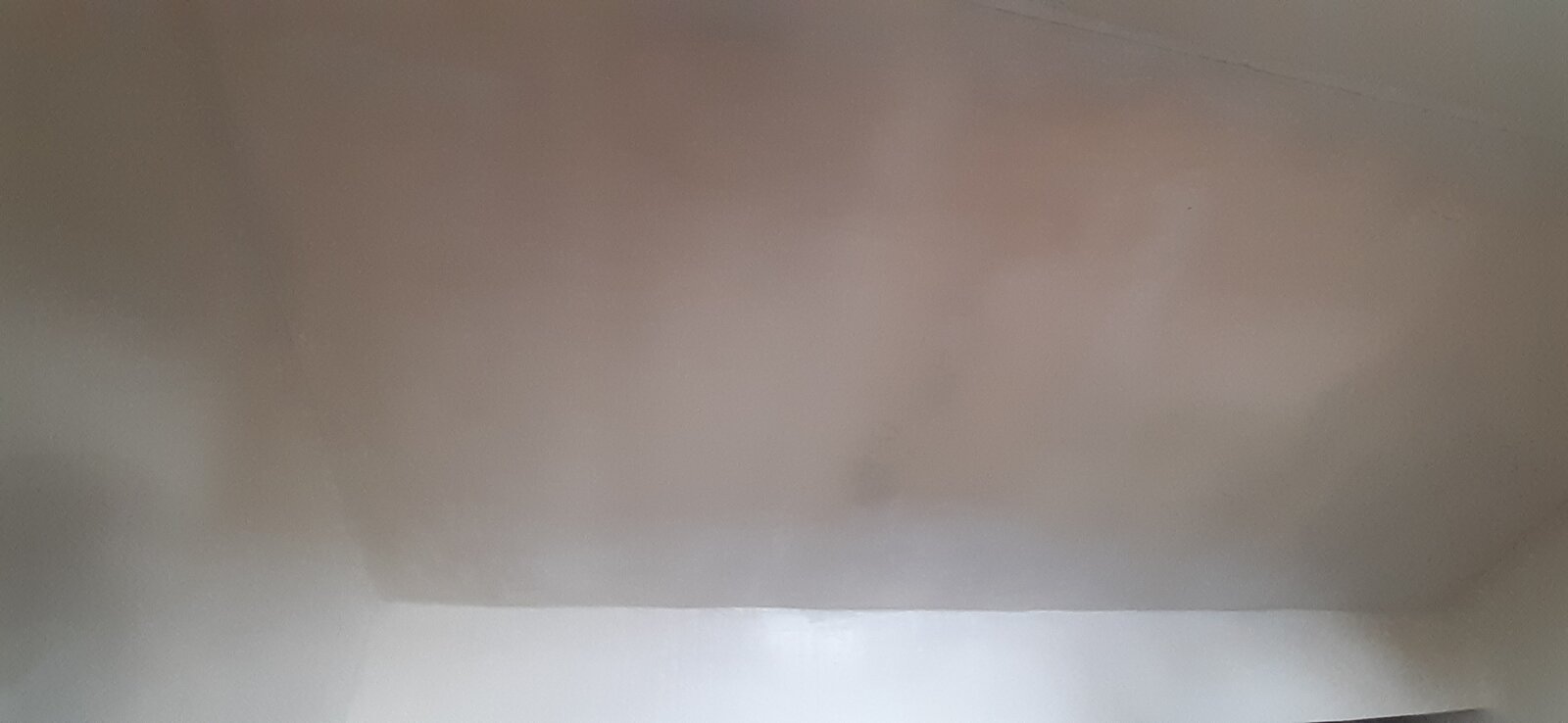

Hi I have an old terraced house near Buxton, I'm getting some damp stains on the chimney so I'm thinking it should be capped.
It's no longer used.
Any idea how much that should cost roughly please?
Also got some mould marks on the inside of the roof , may just be condensation though?

You say you are getting "damp stains on the chimney" - why not post pics of these stains?
And why not go up into the loft & examine the loft chimney breast?
