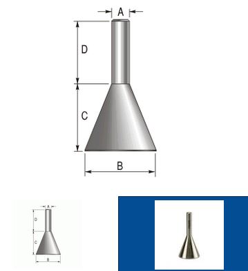

Guide bush mountings should be concentric with the router collet, but often aren't on lower cost routers. the solution is to get/make a cone-shaped centring mandrel, like this one from Wealden Tool:
and use that to centre the guide bush before fixing it. If needs be the guide bush can be fixed in place with domed-head cap screws (if space pemits - this works on my DW625). The cutter is inserted afterwards. 0.5mm may not sound much but it starts to be a problem when you are fitting certain hardware useing jig, guide bush and cutter, e.g. door lock face plates, hinges, flush bolts, etc

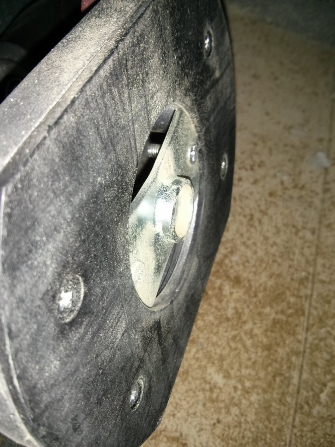

The guide bush assembly are on counter sunk pozi screws. On mine, I don't think I'd get away with putting button heads in but it's a tight call. Unless I swapped the base with something alitte thicker?

Hmm. might have to make the button heads fit after all!
Cheers :)
Almost all woodworking router collets are the same in one respect: the lower end has slits to allow a small amount of undersize variation in the diameter of the cutter shank whilst the top end has no slits and is therefore incompressible. With a 6mm hole drilled through the middle +/- 0.05mm you normally can't get a 6.35mm shank into the hole (bearing in mind that the shank needs to be fully held within the collet). Also worth considering that collets in most engineering kit is being run at a few hundred to maybe 3000 or 4000rpm - woodworking routers spin at 22 to 30k rpm
If nothing else you can always make up a thicker sub base in thicker Tufnol, polycarbonate or acrylic - even 12mm MDF will often do for a one-off job (or for that matter 12mm h/w ply)
