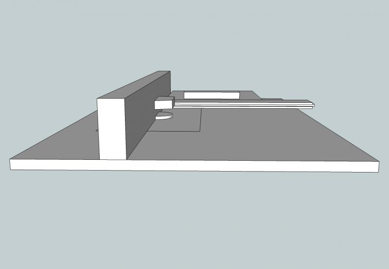

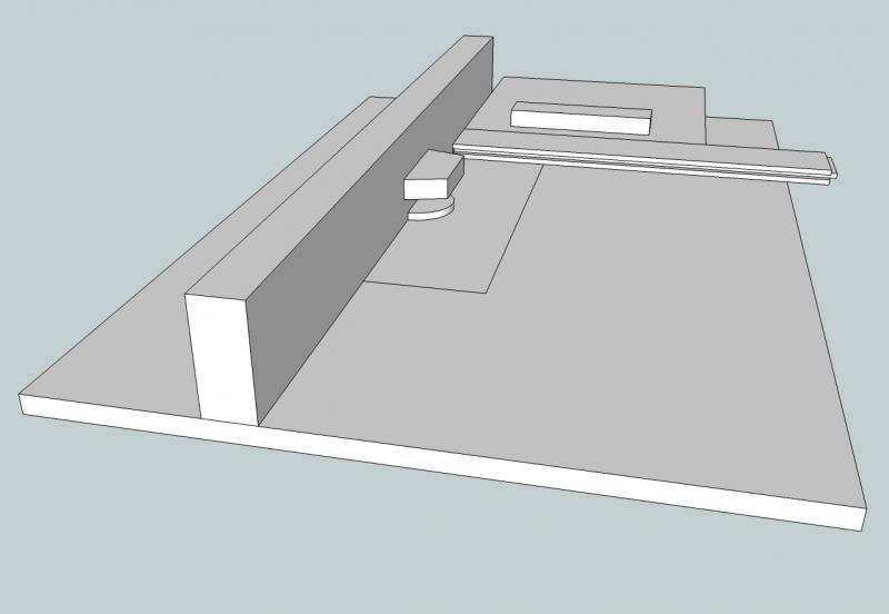

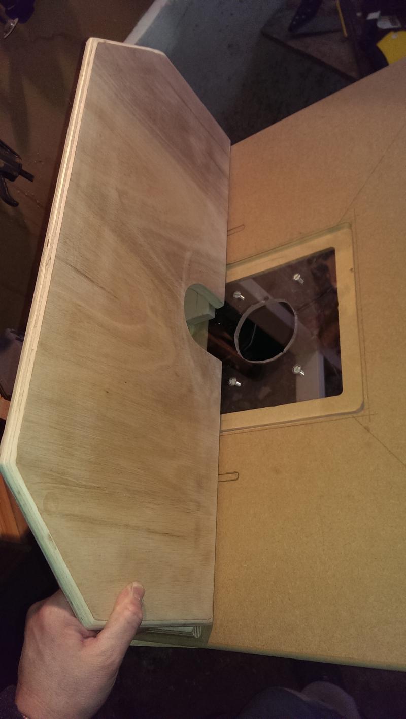

Rails for shaker cabinet doors, I know you need to help the end cut with some kind of rail to keep square, and your fingers, but wondering best practice to get straight. I see what you mean about running block against fence, i guess that will guarentee its square?
Was thinking somethin like this?
However as fence not fixed i was worried that if i made mitre for rail that is fixed and i set fence wrong it will ruin cut.

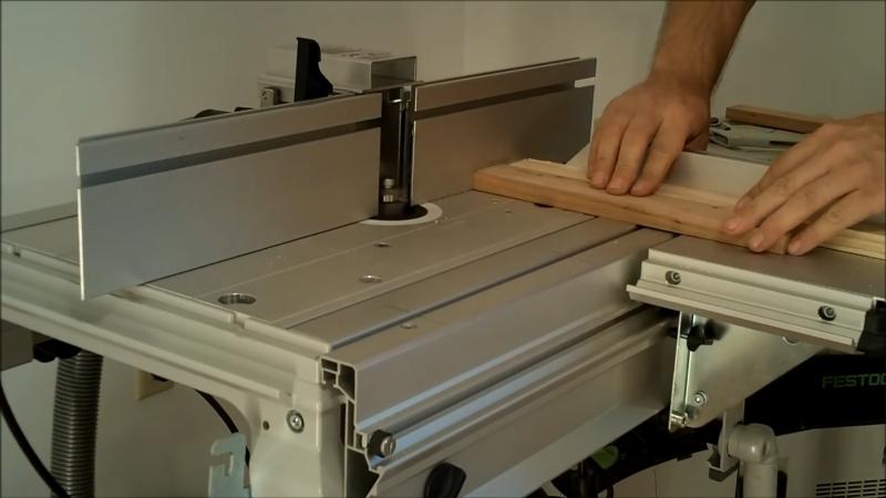

Nah, forget it! You are over thinking it IMHO. All you need is a squaring piece - basically a 12 x 12in corner off an MDF sheet which you fix a knob on top of. It is run against the fence and you hold the workpiece down with your fingere. If you want to get really fancy you could always build a DIY version of the "coping sled" sold by some retailers. The difficulty with using a router is that the height you cab raise the cutter above the router table is very limited

Above: Simple squaring piece

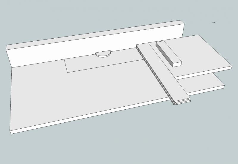

Below: Fancier home-made version of a "coping sled"
Note the clear acrylic guard above the cutter (highly recommended!)

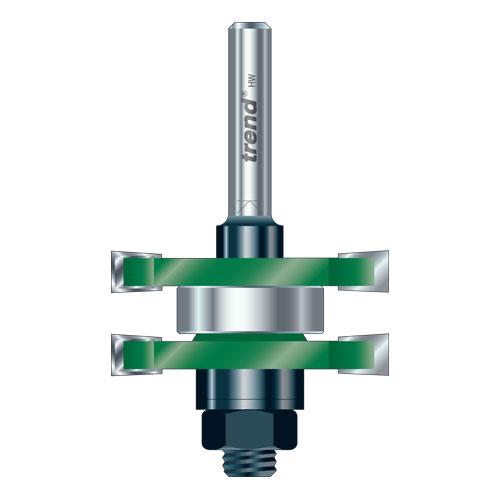

I'm assuming that you'll be using a grooving cutter, like one of these, mounted on an arbor. If you are using a fence a guide bearing isn't strictly necessary. That would give you a set which when made up would look a bit like this:
If you mount two groovers with spacers in between you can cut your tongue (actually it's properly referred to as a stub tenon) in one pass:

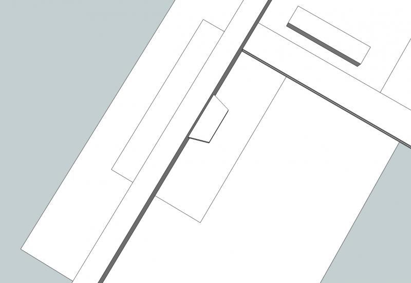

Because the cutter will project through the fence and will be hidden by the material you are machining and the squaring piece/sled it's as well to attach something like a piece of 2 x 1in PAR softwood above it temporarily, edge on and say 10mm above the surface of the table. By doing that you run less risk of having an accident by sticking a finger into the cutter. It's as much a visual reminder of where the cutter is when it is hidden inside the workpiece as of anything else. It's standard industrial safety practice to guard exposed cutters - regardless of what the guys across the pond thinj or say (most of them are not trained woodworkers)
Hopefully these should clarify the matter:
Above: View from above the cutter. Note that it is covered from this viewpoint
Below: From the outfeed side showing that the push block "handle" will clear the cutter guard

yea, this one from trend.
I get ya, if i measure it right it may help stop stock rising, or should i give a little clearence.
Actually it will snag the cutter if that low i guess.

Thats a great app you use fordrawing, or program on pc?

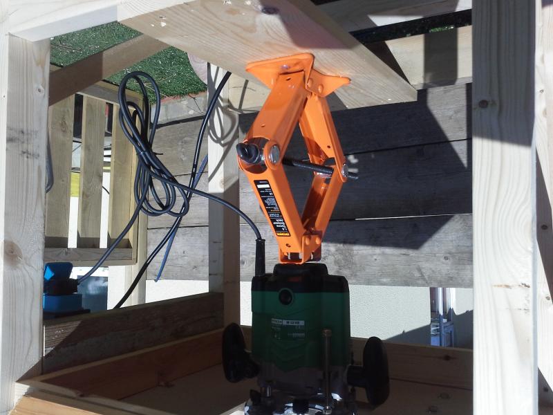

Heres a question, I have my scissor jack mounted and working well under my table. And its nice and smooth with great fine adjustment, however, when raising the router the mounting plate raises a little as well. I am having to hold down plate and lock of height then lower jack a turn to use it. how do you all overcome this?
Woukd it be couple of machine screws counter sunk into recess off mdf? Only problem with this is it is quite thin for that.
Also can I expect any problems from dust falling into router?
You'll need to drill and countersink your mounting plate and screw it down onto the router table. If necessary repair washers and wingnuts on the underside
