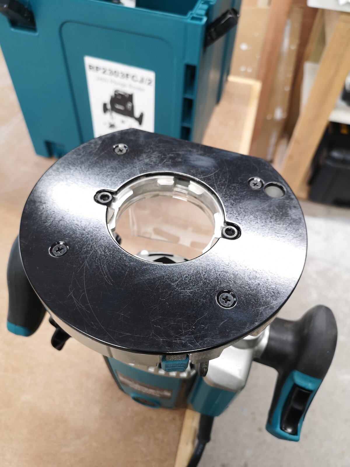

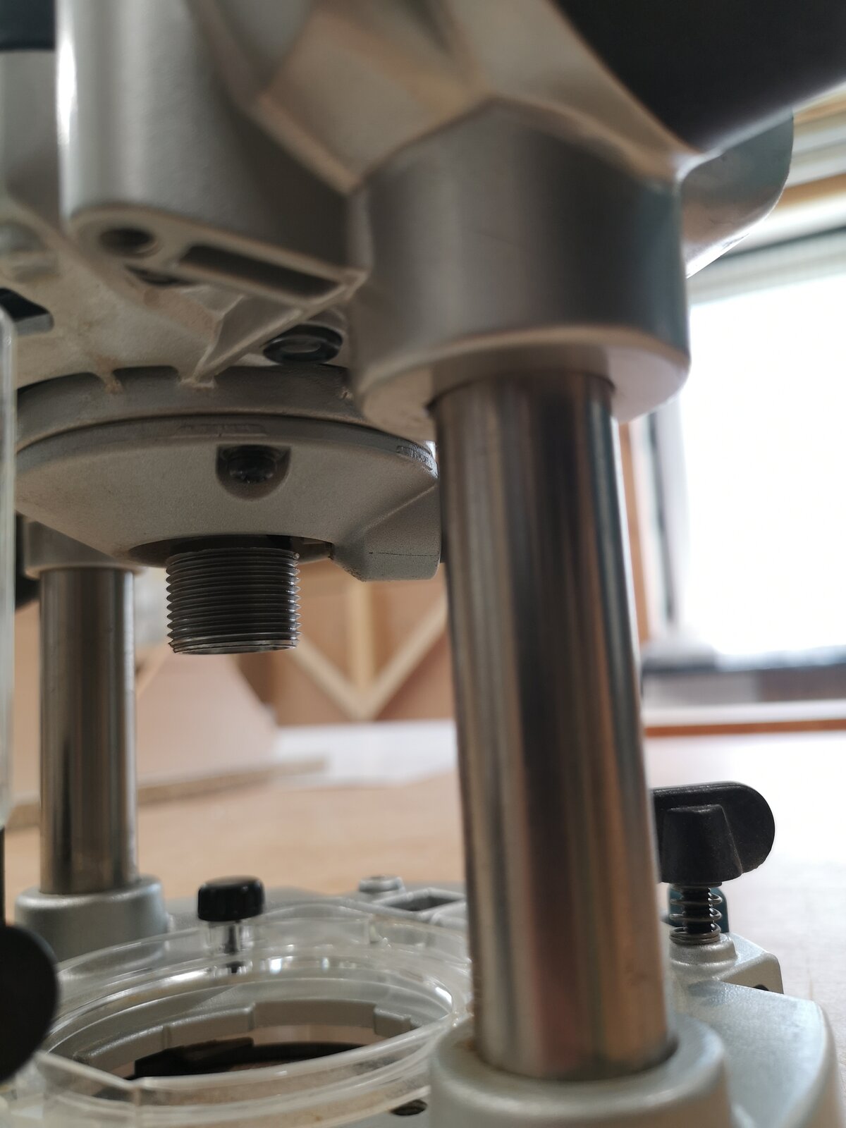

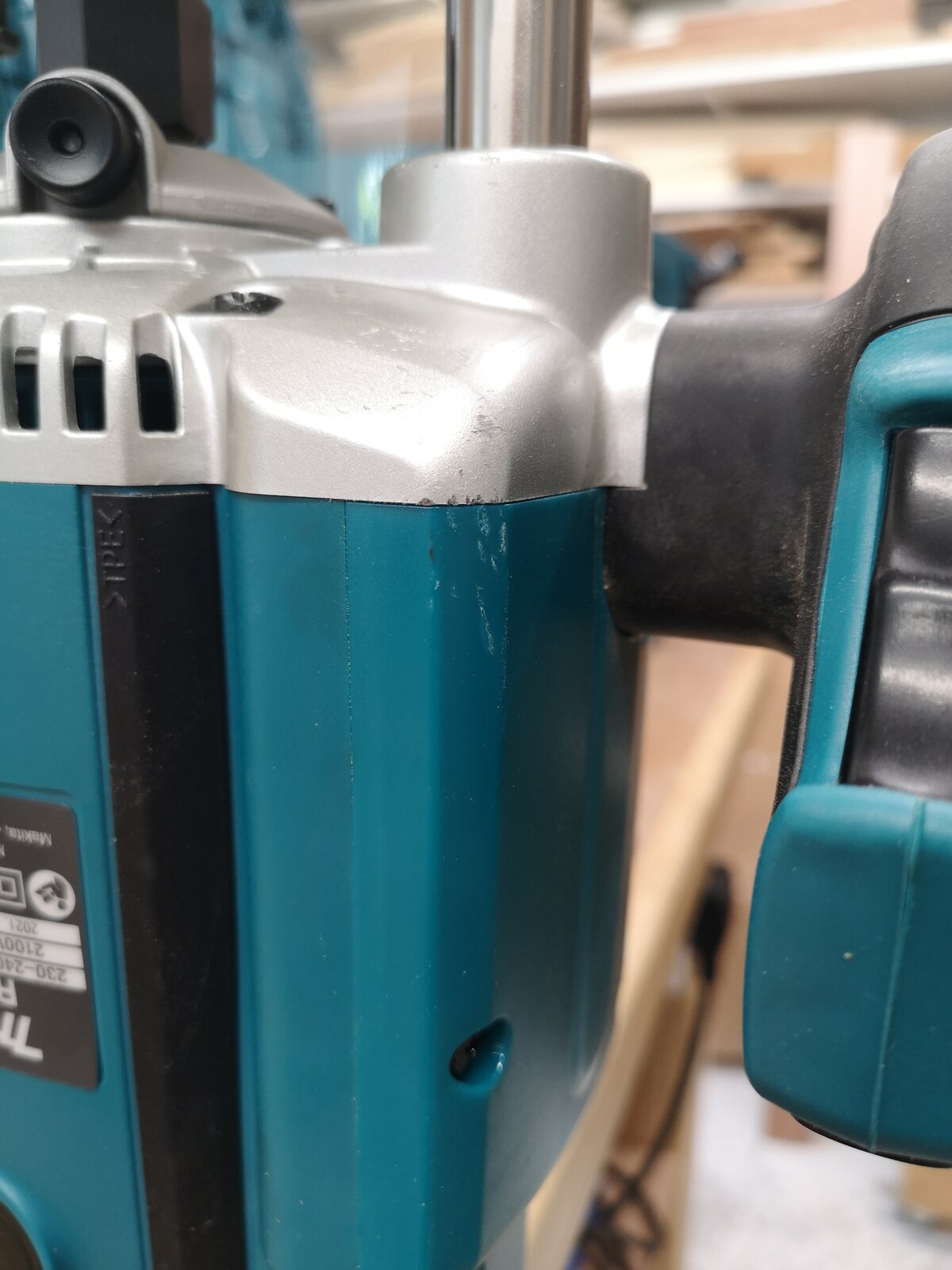

Definetly something wrong with it. I pull out the collet and the nut and i turn the tool on to spin freely. Underneath if i put my finger i can feel the air which is pulling from top is pointing downwords to the bit. I can clearly feel the air is cool, the threaded rod where the nut is attached i can see its spining good and couldnt see any movement when look at it. 2-3 min later i turn off the router. The threded rod and inside it is hot, as well as around the rod, closes body part to the rod is hot. Imaging what will happen when i have to cut the worktops i have to instal in 2 weeks. Probably wont be able the touch the bit and the nut for half an hour. There is return policy of the company i got it, they are Authorised Makita seller as well. When i look at the website its say they avaiting new stocks so that could be the last router they have as it come from Northern Ireland to Ireland for 1 day which is weard. I think this could be returned item as there wasnt dust on it, but there was a marks in the plate as well as 3-4 minor scratched on the body itself.

I send email directly to Makita service tech. I explain my testing and explain about heating. I got this answer :
Hi,
This is heat transfer through the armature during use & not detrimental to the operation of the tool.
Regards
