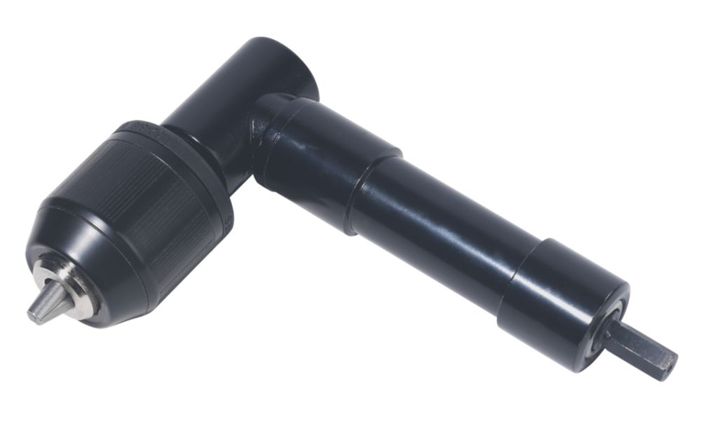

OP: Not sure about old rules, but you should not notch the bottom of the joisyts, if that is what you mean - drilling is preferable, and you can buy a 80 degree drill attachment to make it easier:
ae235
That looks like a useful tool, I'd not thought about whether you could get a drill in there at the right angle...
