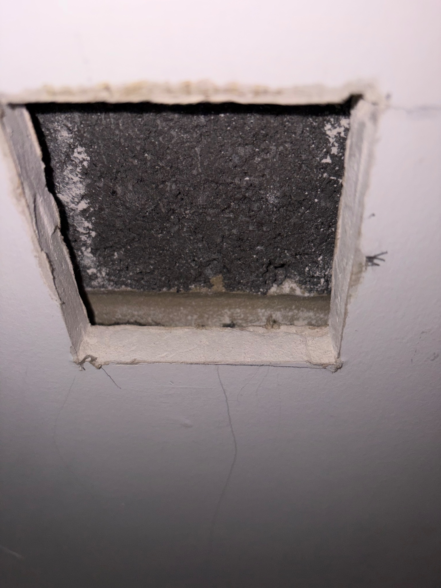

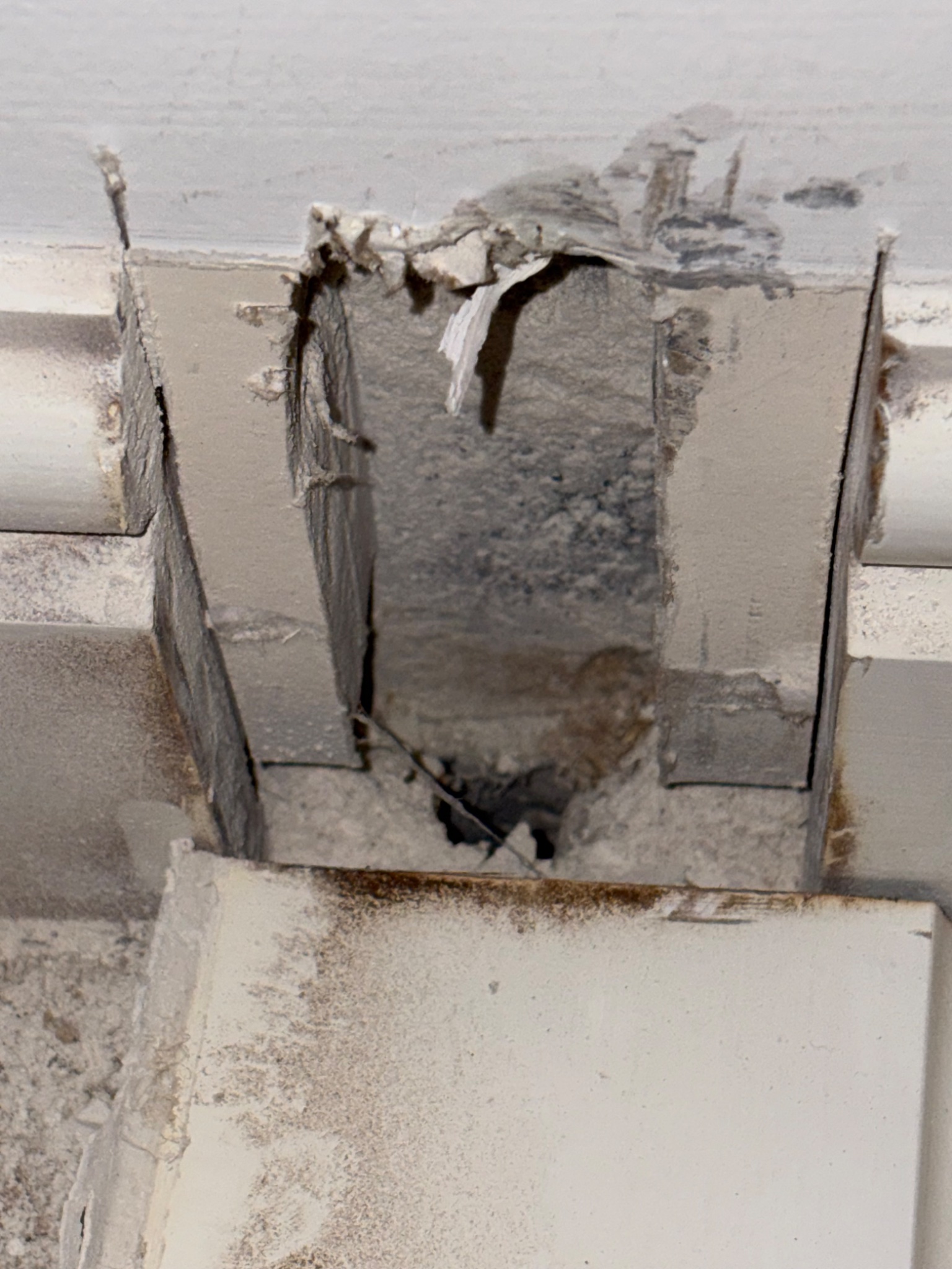

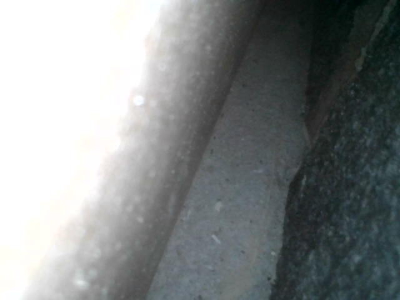

I’m in a 15 year-old Persimmon house and am trying to route data cables from under the floor to a wall box. I can access under the floor from below and have cut out a hole for the wall box in the plasterboard. The problem is that the route down to under the floor is blocked. I’ve attached a photo taken with a cheap boroscope (plasterboard on left, blockwork on right) and I’m guessing the dot & dab adhesive is run continuously along the bottom of the plasterboard, behind the skirting board. I’m trying to avoid any damage to the first floor room but can’t see how i can get past this barrier. Are there any tricks to achieve this? Is there likely to be any more barriers to this routing? The underlying issue is that I’m not familiar with how this age of house is constructed so I’m kind of working blind.

If you can reach underneath to check theres no pipes or wires then you'll have to drill down if you've got a long enough bit.
Probably the wall frame work and the floor boards in the way.
With a slightly better endoscope/boroscope type thingy (you can get them quite cheap if it`s worthwhile) you might be able to better determine exactly what is what).

Dot and dab with plasterboard could be sounded out with the back of a suitable screwdriver handle tapped on the plasterboard for taking sonic readings.
Added to that technique most 3 x 2 battens started at the bottom of the wall right firmly on the top of the floorboards to drill a 20mm to 1" flat bit/spade drill at 90 degrees thru the skirting and perhaps ditto at an angelat the bottom par of the plasterboard - just a dabbing repair with suitable filler in the skirting afterwards and maybe a touch up with a small amount of paint.
The boroscope is a relatively recent purchase, I’ve done plenty of low tech fishing before! What would you recommend as a slightly better one?
Hmm not sure. I got one a few years back it was one of those "when its gone its gone!" things from Aldi and I got it for one specific job at the time, thinking it might be useful another two or three times in my working life, Unfortunately I sort of started windin down to retirement not long afterwards due to accident/illnness but it did not cost a lot but some of their German Engineering is better than some of ours and cheaper.
